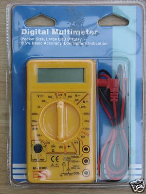

My multimeter show 200, 600 for AC and 200m, 2000m, 20,200,600 for DC.
Find attached a picture my multimeter.
The Clamp meter is supposed to be plugged into a multimeter so it has the same socket leads as my multimeter, so I can remove my test leads and place the clamp leads instead.

Your "el-cheapo" multimeter cannot measure AC-millivolts. Its AC-volts ranges are only 200V and 600V. If it is set to 200V then the lowest it measures is 0.1V which is 100mV.
The clamp is supposed to circle only one wire of a two-wires appliance.
My Fluke multimeter has 400.0mV as its most sensitive AC-volts range so I can see 0.1mVAC.
I suspected that. Just checked the manual and it says resolution is 100mv.

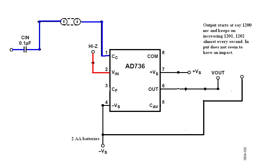

Hi Eric,
I replaced my capacitor with a code 104 Mylar.
my current circuit looks like the attached image. On pin 1 & 2 the clamp red and blakc leads with the mylar capacitor on pin 1.
Pin 4 & 7 connected to battery.
Ouput and 4 connected to my multimeter.
When I remove the batteries and I set my multimeter to 0.2vdc I can see a small change (I suspect noise), but it does not reflect the actual load I have on the clamp meter.
I have ordered a better multimeter little bit more expensive than the one I have :) .

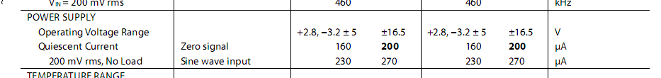

As I read the datasheet 2 * 1.5V batteries will not be acceptable as a power supply.
Look at the datasheet for the Vref conditions when using low voltage supplies.
I did point this out in an earlier post.:)
the table shows that for:
200mv rms sine wave input: ± 5
Zero signal it should be ±16.5
Where does my transducer input supply fall? i do not think it will exceed 200mv.
Please bare with me I am in an uncharted territory here. :confused:
And to supply 16 volts I can just a use a standar variable adaptor which I think you mentioned in an earlier thread.
One more thing how do I get 0 volts? there seem to be references to negative and zero.

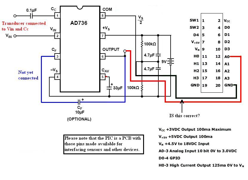

Right,
I think I follow most of your explanations.
But I need to clear few things:
The negative end of the battery is connected to pin4, and also this should be connected to pin 5 through a 33µf, and to 7 through a couple of 100κΩ resistors, and from between the two resistors to pin 8.
I also need to connect negative to pin 7 through two 4.7µf capacitors and link to pin 8.
basically what is in figure 28 with exception of:
pin 3 to 6
pin 8 to 1
and the way pin 2 is connected.
The PIC does not require any power and it has its own battery and can provide +5v if need be. So how should the isloation of the battery be done?
From the provided image the blue is what I do not have connected at the moment and the red are the queries.
Do I need to connect all what is in blue as is.
Thanks a lot.
Use a 9V battery for the AD736 and separate battery for the PIC.
Connect the negative end of the PIC battery to the junction of the two 100K's and pin6 [output] to the PIC adc input,
Thanks a lot.
You most likely will need an amplifier between pin 6 and the PIC's adc input.
Please draw out the complete circuit for the AD736 , showing also the PIC adc connection and the batteries then post it.

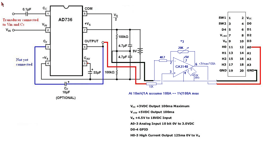

Here is what I think I might need to do.
Comments are on the diagram.
One more thing: with regards to the 2 X 4.7µf capacitors: I can not find an exact 4.7 or is this supposed to be 4n7 or 0.047µf?? I have a bag of over 100 capacitors of all sizes so I am too sure of the nearest appropriate size.

update:
I connected as in the diagram.
The 33µf capacitor was replaced with a 33n one.
The two 4.7µf capacitors were replaced with 4n7 ones.
Connected 9VDC Adaptor.
Connected my clamp.
plugged my multimeter with the dial on 200m :
It shows 00.5 when nothing is connected.
I connect the clamp with almost 40 watts of load, nothing much changes probably 00.6.
I plug a hair dryer 2000w on hot and it jumps to 01.3
And it is pretty much consistent.
update:
Recheck these two caps values you have chosen as equivalents.
µ, means microfarad [ 10^-6]. n, means nanofarad. [10^-9] !

EDIT: You can see from the low mVdc levels on the output of the AD736 that you will require a amplifier between the AD763 output and the PIC adc input.
On the diagram provided there is a variable resistors is that correct?
A 20K one and the 3 means set to 3 volts?
Is that correct?
Is that correct?
The *3 indicates the 20K pot is set to give a Gain of 3 from the CA3140.
The 10K [pin 1and 5] pot is to trim the CA3140 zero when there is no input.
EDIT:
the gain of *3 is assuming that 1Vdc output from the AD736 when measuring 100Amps.
You could adjust the gain to suit your requirement.
right,
So only one variable resistor of 20k set to * 3 gain? (can you give me a link to one?)
And what about the 4k7 resistor what will the actual resistor size be here?
Something else:
pin 1 & 5 are connected to negative and to each other as in the image provided?
EDIT:
