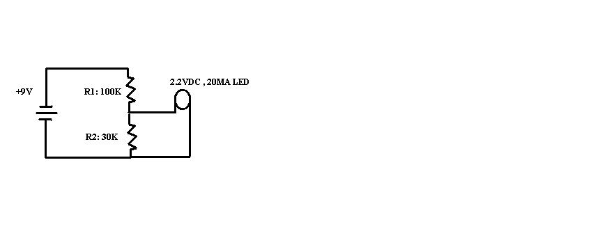

I am trying to reduce the 9V battery to 2.2 to allow a 2.2VDC LED to work.
I came up with whats in the diagram. This is giving me 2 VDC when measured on my DMM however when I attach my LED it does not work.
Any ideas as to why?
Or is there a better solution to do this (maybe one resistor)?
Further investigation appears to be indicating that I need:
R1: 500 OHM
R2: 150 OHM
To compensate for the load (LED).
Is this correct or am I off track? :eek:

I did query this LED.:)
Consider you have an LED with a 2Vdp and you want to run it from a 9Vdc supply.
This means you must drop 7V in a series resistor.
You say you want 20mA thru the diode [ I would suggest thats to high for a 9Vbty]
anyway Rseries = 7V/0.02 = 350R say 390R
For 10mA Rs = 7/0.01 = 700R say 680R
Do you follow OK?
EDIT: You only need one resistor.
If you must have a 20mA LED [wasteful for the battery] the use a 390R

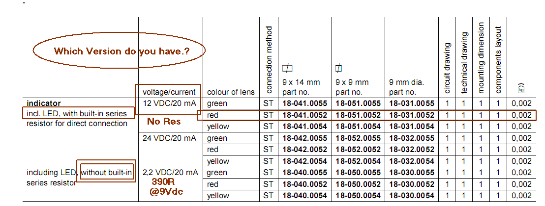

Looking at the datasheet for the PB it states it has a inbuilt resistor for the LED.!
No external resistor required.
Did you get 12V version of the P/B?
No Unfortunately I got the 2.2VDC one which does not have a resistor.
Although I had a choice of either, but I thought the 12VDC one will not work on my 9VDC battery, now thinking about it I think it would have been perfect.

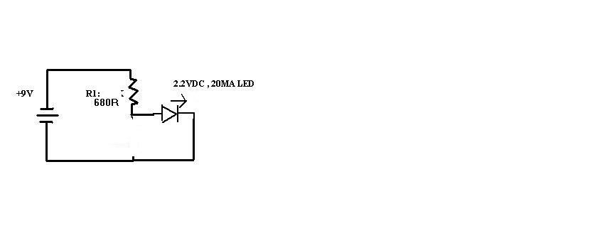

I tried both the 390R and 680R and both seem to work. I am thinking that the 680R is better to use but I do not know which one will put more strain on the battery though.
Use Ohms Law to answer that problem: Icurrent = Volts/Resistance
So 9Vbty - 2.2Vdp = 6.8V [ to drop across the resistor]
Gives:
I1 = 6.8/390R = 17.4mA
I2 = 6.8/680R = 10mA..
If the battery was only driving the LED, with a 680R it would last twice as long compared to a 390R.
I would have thought the LED would be bright enough at 10mA.:)
Indeed. I did not notice a clear visible difference in brightness between the two resistors.
I will certainly go with 680R in this case.

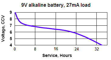

Your vision's response to brightness is logarithmic to allow you to see a wide range from the light from a candle to sunlight. Therefore an LED's brightness does not look much different when its current is halved or doubled.
Your 9V battery measures "only" 8.23V when it is loaded because it is running down.
A 9V battery doen't have much power. Look at its datasheet from the website of a battery manufacturer like Energizer:
1) It is 9.0V when new.
2) With a 27mA load its voltage drops to 8V in about 1 hour.
3) Its voltage drops to 7V in about 7 hours but then the current is less.
4) Its voltage drops to 6V in 22 hours but then the current is very low.

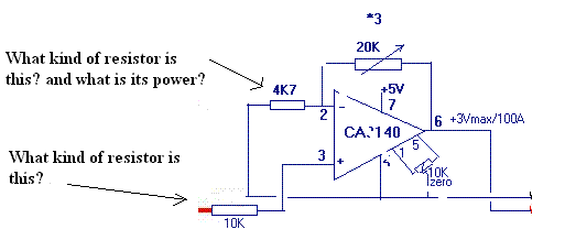

Hi Eric,
I've been going over the circuit of the CA3140 to amplify the AD736 signal and I drew a blank on how the cicuit below was decided upon (Please ignore question in the image ):
pots-gif.23701
What I would like to understand is why did we go with a 4k7 resistor at pin2 and Why the 10k at pin 3.
I understand the voltage at 4k7 will be 4.5v so applying a 4700 ohm resistance will generate 0.96mA.
And for pin 3 at a maximum of 1VDC we get 0.1mA.
So what is the significance of choosing those particular ones as opposed to say 10k at 2 and 20k at 3 for example, how would this have impacted the output. For instance.. would i get the same results provided i adjust the 20k VR correctly?
The whole diagram (proposed is what was built):
diagram_new-jpg.23883
Thanks a lot for your time.
