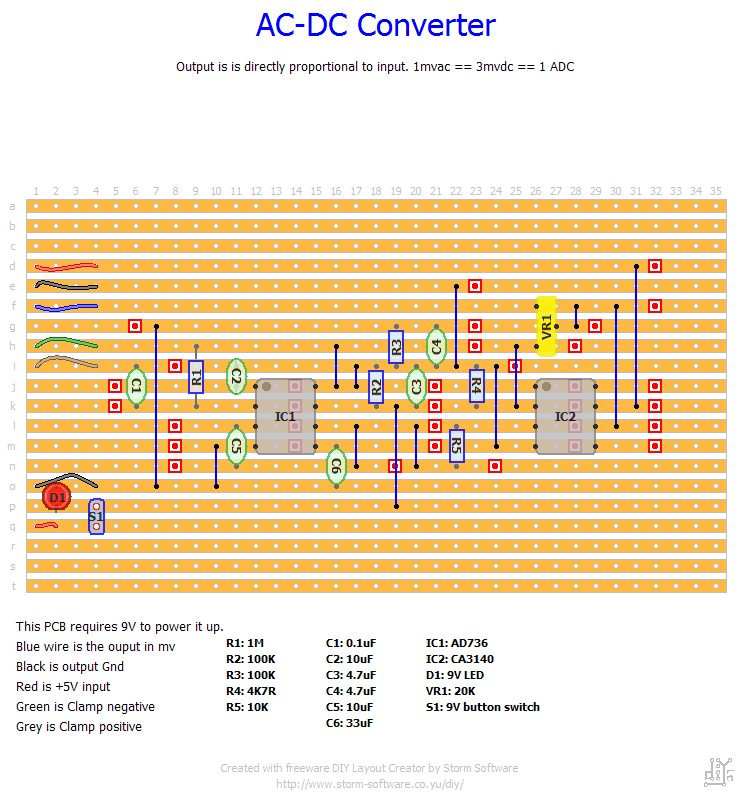

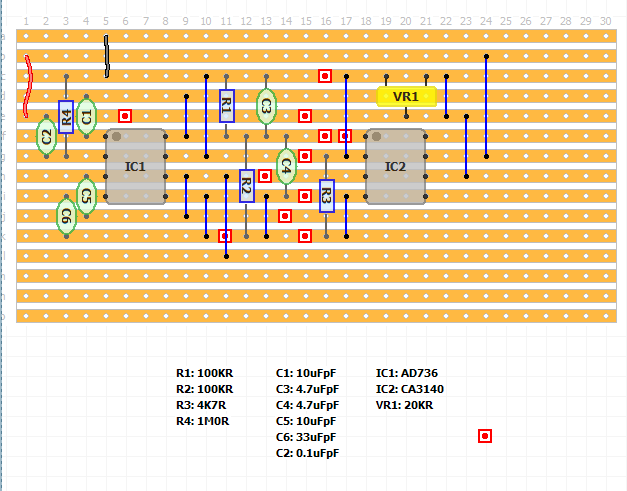

I would lay the board out on veropcb, its a simple pcb.
I understand there are some freebie strip board layout programs on the web.?
Yes I am using it now.
Seems to be missing an important feature ability to drag components around which is a bit strange. I will check the help and tutorials.
Edit:
Just found it. It is on the bottom right corner 4 arrows :)
EDIT:
Download DIY Layout Creator 1.23 - A useful tool that will help you easily create board layouts for various components - Softpedia
just a quick try, looks a nice easy program to use.
this sample layout of your project has NOT been checked for accuracy

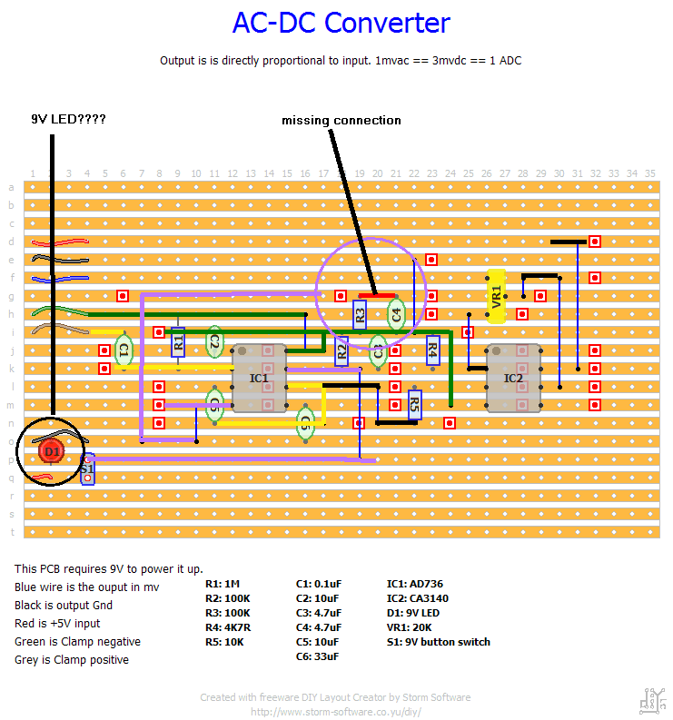

There is missing connection from one end of the 100K's
also whats a 9V led.?
Correct and repost.:)

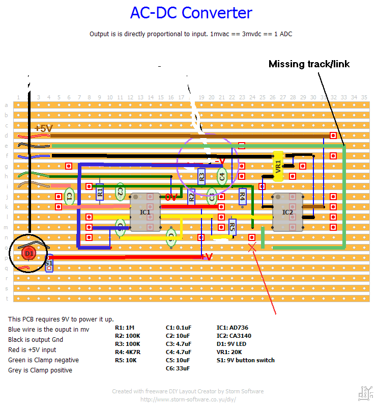

With exception of the missing 0V line for the supply it looks OK.
Cut the track at the spot marked 'X'
EDIT: just noticed you have linked the 0V near the centre of the pcb

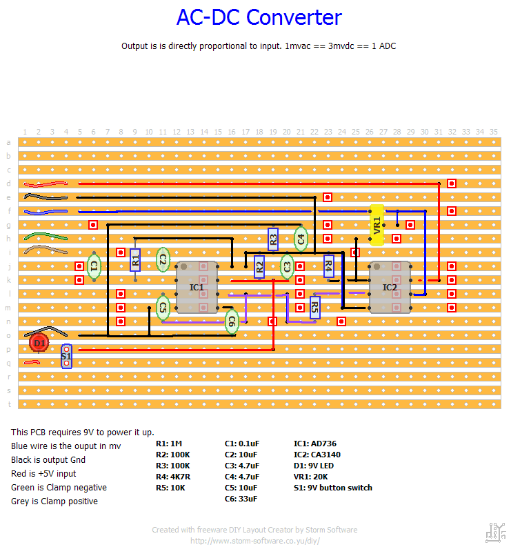

Please find one that I have connected with lines.
I think 0v is already there.
And I am not so sure about the link in the centre.
Please review.

Your 'thick' 0V link in the centre is OK, I did notice it after I had posted, so I posted the edit.
You have made decent layout in quick time, that layout program is nice and simple to use.
Consider the LED drain on the 9Vbty.
