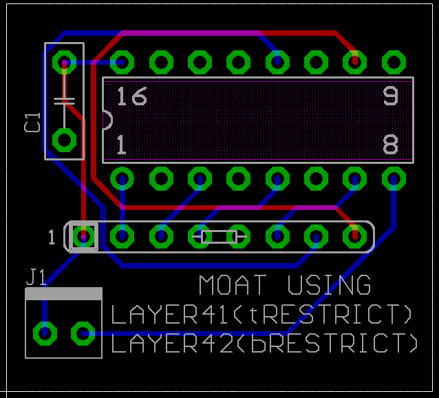

If you are using Eagle this is how to make moat:
That doesn't seem like the same thing that's referenced in the original image. That 'moat' you've exampled is just one big restrict block underneath a chip. The 'moat' in the original image shows a restrict that surrounds that analog sensor area which would decouple the entire secondary ground plane. It doesn't remove the ground plane, it just isolates it.
