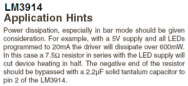

All circuits should have a supply bypass capacitor connected as close to the active parts as possible. For the LM39xx, it is between pin2 (-) and pin 3 (+). The datasheets don't show it because they assume that one is there or that the main filter capacitor of the power supply is very close.
A simple power calculation shows how much heat the LM39xx will produce.
510 ohms between pin 7 and pin 8 creates a reference current of 2.5mA. A graph in the datasheet shows that it causes a current of 22mA in each LED.
You have a 10.5V supply and if 2.0V red LEDs are used then each output of the LM39xx has 22mA and 10.5V - 2.0V= 8.5V across it and dissipates 22mA x 8.5v= 187mW. If all 10 LEDs are on then the IC will dissipate 187mW x 10= 1.87W plus the IC's small operating power. Its absolute max dissipation at 25 degrees C ambient is only 1.365W so it will be too hot and will fail.
Adding a resistor to share some of the heat as explained in the datasheet will cool it.

Or reduce the current to a more sensible value like 10mA.
PeterDove said:
I'll remember to add in some resistors to dissipate heat
Only a single resistor is needed. It goes in series with the supply to the LEDs. Then a supply bypass capacitor is needed at the anodes of the LEDs.
