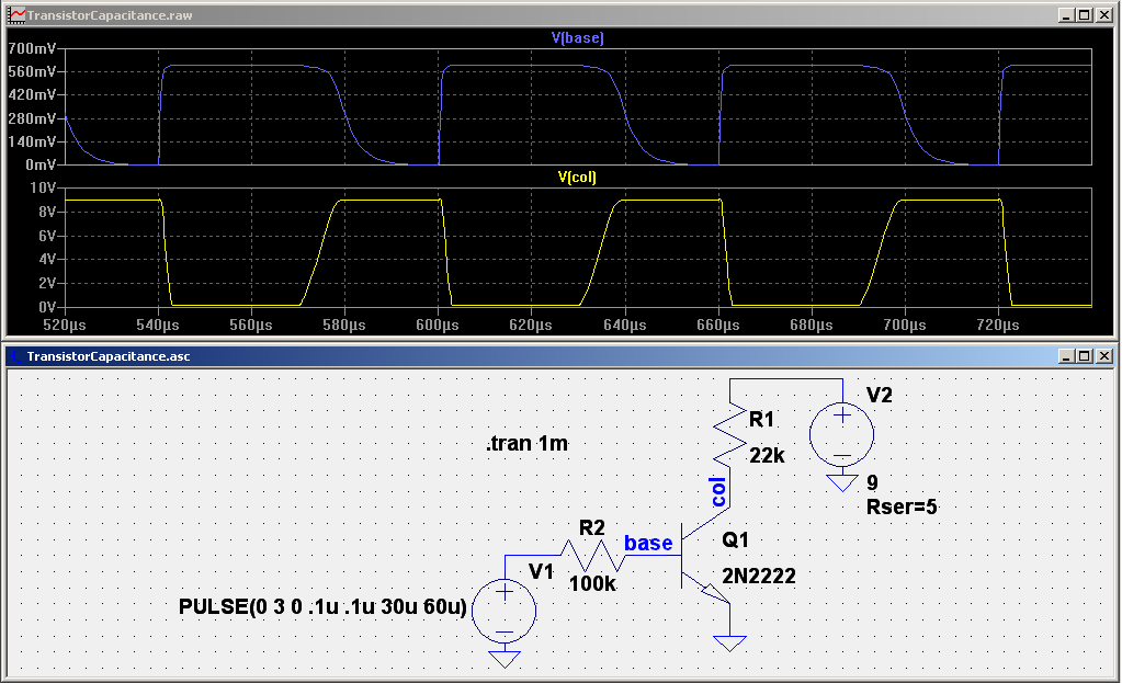

Also would anyone be able to knock one up for the result I got in my last scope trace
See attached. Note that increasing R2 softens the base pulse falling edges, hence the collector pulse rising edges. Not a direct match with your scope traces. BTW, what base resistor value did you use?
I didn't because there's a base resistor integrated inside the transistor ...ie a digital tranny (I'd assume it to be something like 1k)
Ahh, digital transistors are great, but see if you can get the datasheet, the base resistors can vary between 1k, to 47k and can cause issues later on when things don't behave quite as you'd expect. Seems the most common by far is 4.7K to base, and 4.7K from base to emitter.
