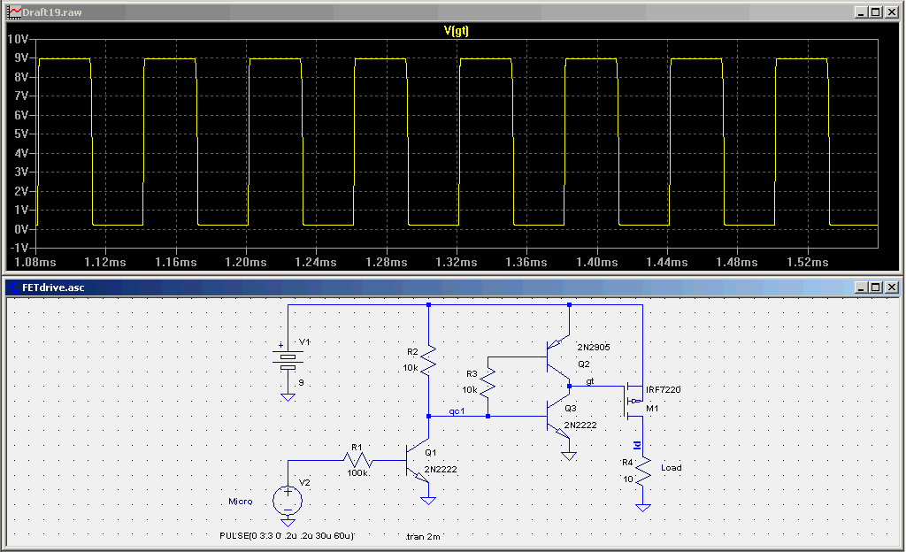

I need to switch a P-chan mosfet on/off (mosfet source voltage will be 9V ...ie a battery) from a PIC pin at about 16Khz - the frequency has to be this high as it'll be in an audio circuit (ie put it above the average adult's hearing) ....a the PIC has a VCC of just 3.3V....therefore the source switching waveform is 16Khz, 0 to 3.3V.
Now clearly, a PIC with a 3.3V cannot turn a P-Chan mosfet whose source is tied to 9V on/off.
So how to get the PIC's output level to be right for switching the p mosfet? At first I thought, just use an n channel mosfet ...gate to the pic pin, source to ground, and a 10k resistor in the drain to 9V...connect the drain/resistor junction to the p mosfet gate .....that will switch between 0V & 9V nicely ...indeed it does, but I don't get a nice square wave on the p chan gate.. it's got typical CR slope thing going on - which means capacitance is creeping in from somewhere - I'm figuring the N mosfet's internal capacitance? (or possibly the p mosfet's gate to source capactiance?)
I tried an digital NPN in place of the fet at q1 - no better!
So what would be the best way to approach this...I don't want to drop the value of the switching frequency ....nor the 10k resistor (ie between the n channel mosfet & 9V as that would really start ramping up the current when the n chan mosfet is switched on (this is destined for a battery fed device).
I'm surprised to be hitting such problems....16khz isnt that high a frequency - there must be a way I can get that p channel gate switched with a nice square wave ?!!
I'd happily buy a proper load switch...but they all seem to be 5V .... I need 9V....also I'd wonder if they'd be any better at 16khz than what I'm experiencing?
Something like this?

That sounds about right. The gate on a FET is like a capacitor that has to be filled to fully "open" the source-drain. A partially filled gate-capacitance will give a partially-open source-drain, which manifests itself as resistance. So I suspect what you're seeing is the resistance decreasing over time as the gate-capacitance fills up, giving you a non-square signal.
There are two things you have to consider:
1. Most N-chan FETs need more than 3.3V to "turn on". And even if 3.3V is enough, it may not be enough to fully activate the FET. The datasheet should give threshold range. At the lower end of that range, you'll have higher resistances across the FET.
2. The in-rush of current to fill that capacitor needs to be high. Your lowly uC pin can't source more than a few tens of mA. That'll take a long time to fill that gate-capacitance. Which is probably why you're seeing the non-square wave. You can use a BJT as a driver, or buy a driver IC. Anything that can pump a whole bunch of current quickly. IC drivers typically advertise >1A of drive current for that purpose.

I vote with John for the use of "Logic Level MOSFETs". That is what they are designed for.
Ron

That's the minimum range required. The circuit in post #2 switches the gate between ~ 9V and ~ 0V and provides a low impedance (= high current) charge/discharge path for the gate capacitance, thus reducing switching time.
Alec, what kind of scope did you use for your post?
That's a screen print from an LTSpice simulation. If anyone wants to run the sim I can post the .asc file.

although probably over kill, a simple NPN/PNP totem pole driven by another NPN works nicely for high-side switches, P-channel or otherwise. But of course thats three transistors, instead of just the one :)
.....which is precisely the circuit shown in post #2.

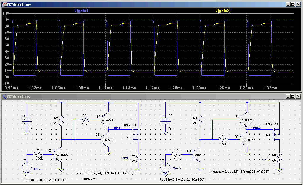

Although the post #2 circuit provides fast FET switching it does gobble current during the pulse edge transients, when both the NPN and PNP are conducting at the same time briefly. By swapping the NPN and PNP positions in the totem pole that transient current is eliminated, at the expense of slower FET switching. Attached are the two arrangements for comparison, plus the .asc file (as requested by Aaron in post #9).
Oops! sorry, that'll teach me for not clicking attachments... I just quickly added what I do to switch P-channels - sometimes its not necessary, but I tend to start off 'over doing it' then stripping a circuit down to reduce cost.

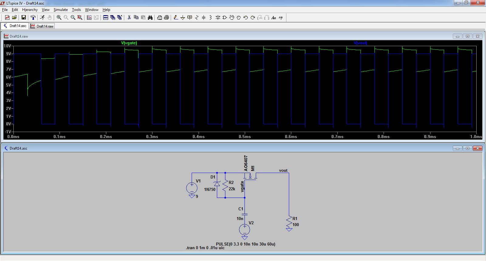

But the p-chan mosfet's 'source' pin is tied to +9v...therefore for the MOSFET to switch, its gate voltage would need to switch between 9v & 6v? (ie 9v minus the 3v threshold) .... or am I missing something here?
You can shift the level using a capacitor, as shown in the following image.
The minimum gate voltage is 3.3V below 9.6V due to the zener. It's possible to adjust the voltage to 3.3V below the 9V by adding a few parts (resistor, diode, cap).
Note that on startup the gate will be on - a couple of cycles of the drive pin fixes that.
