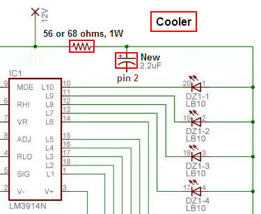

If you have a few mins, would you mind sketching in on my breadboardwhere you would put the capacitors? I am completely happy with the resistors for power dissipation but not quite sure about when you meant when you said 'between pin 2 and 3' for the supply bypass. Do you mean putting the capacitor legs across the track of both pin 2 and 3?
---|--- (track of pin 2 with capacitor pin in it )
....O ( capacitor body)
---|--- (track of pin 3 with capacitor pin in it )
Like the above?
Thanks :)
Peter
Like the above?
Your capacitor across pin 2 and pin 3 of the IC is fine. The other capacitor and single cooling resistor (re-calculate its value for your circuit's conditions) are shown here:

In addition to the previous posts here are some design formulas that make
the resistor selections take about 1 minute or less...
We will use two simple formulas to get the two resistor values:
R1=3750/(380*iLED-1)
R2=(4/5*Vsignal-1)*R1
Note we must calculate R1 first, and that the formula for R1 is valid for
LED currents from 3ma up to 25ma.
First, we know what current we want in each LED, and we'll call this iLED.
Resistor R1 is then dependent SOLELY on this LED current:
Next, now we know what R1 is so we can easily calculate R2 knowing what
our max signal voltage (Vsignal) is:
Now we know both R1 and R2 so we are done, unless we want to check our
results:
Vref=1.25*(1+R2/R1), (should equal Vsignal)
I=12.5/R1, (approximate just for checking)
