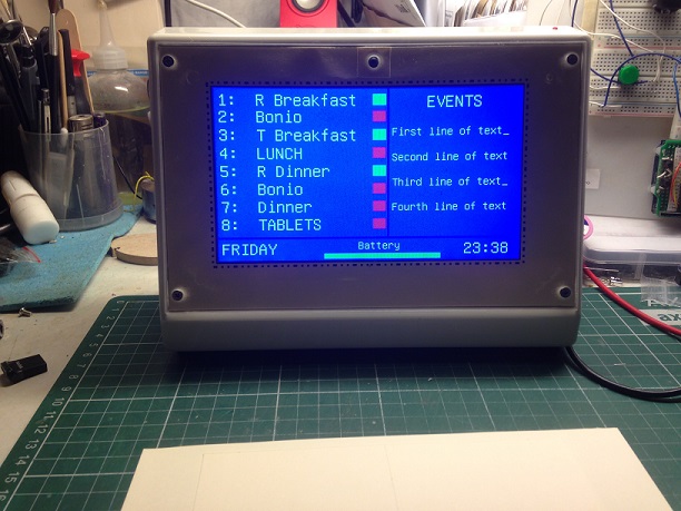

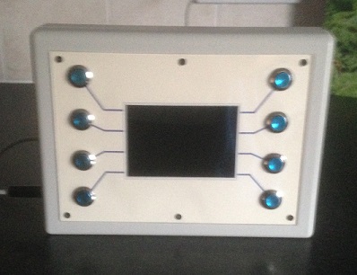

As I said yesterday, I'm too much the novice to argue with your theory but I have found the notes I made of the problem I faced .. .. .. .. .
My wife, amongst other problems suffers Dementia which includes a significant short term memory loss so I built these .. .. .. .
.. .. .. .. . the list on the left are her daily tasks and correspond with the buttons on the second remote unit. They are linked via RF so that pressing a button on the remote unit highlights the corresponding number on the main unit. When the question ' Have I had my lunch ? ' arises for the 4th or 5th time, a look at a highlighted number 4 will answer the question.
At the outset, both were powered with 18650 Lipo batteries connected to TP 4056's and whilst prototyping I was using a couple of cheap chinese 750mAh's which when 'on charge' I measured the current at R3 around 320mA.
However, when I finished work, I inserted a good quality 2600mAh Golishi battery and measured the current again to find 852mA. Note - both are within the limit set by TP4056 R3.
My concern .. .. where is that 852mA's coming from - the USB connection ?

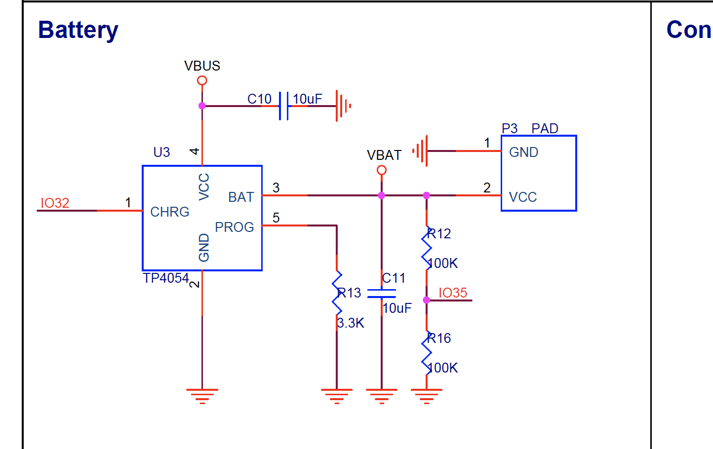

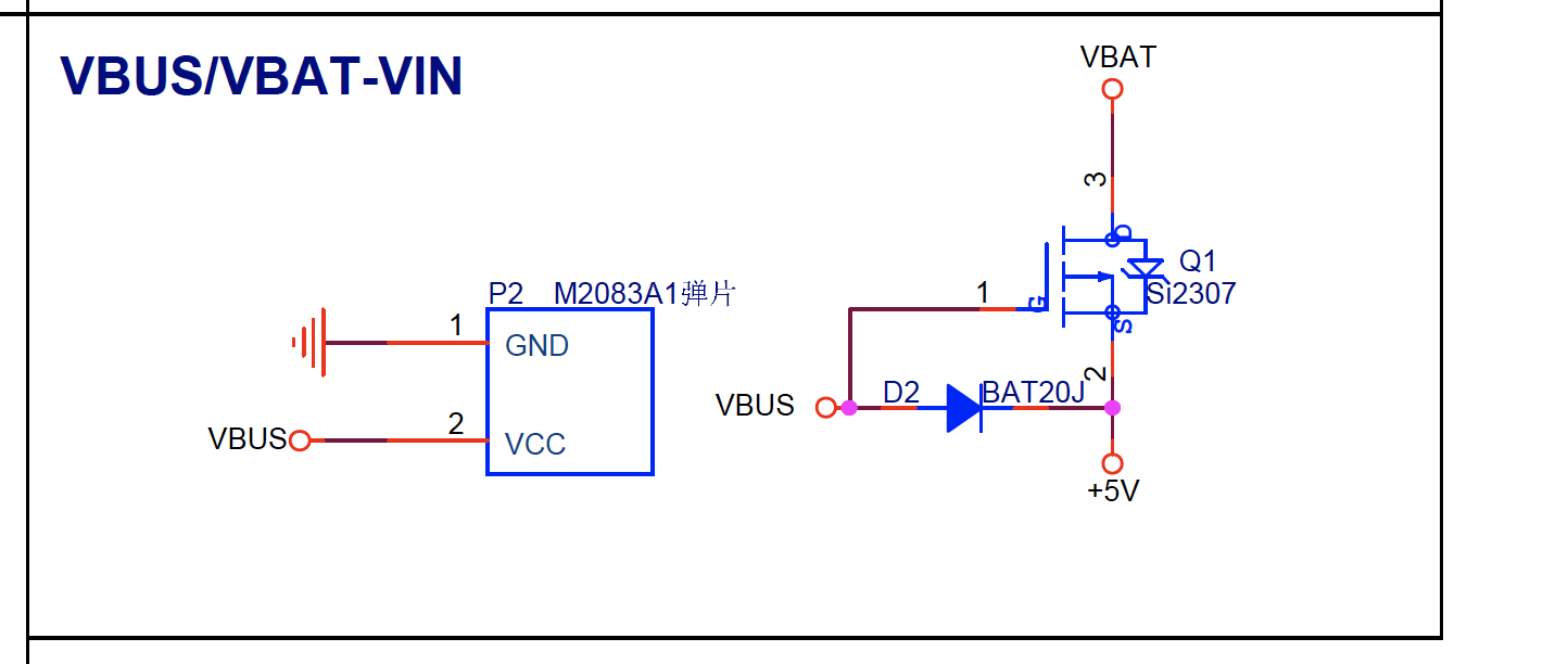

Hello everyone, I just wanted to ask you about these 3 screenshots I took from a schematic, I am just not able to understand them, the battery is not directly connected to the charger and also to the load, I am very confused can someone please explain these schematic diagrams? Thank you

Vbat is the +ve end of the battery.
The screenshot with the TP4054 shows the battery being charged from Vbus. The TP4054 is an IC that controls the charging. It is supplied from Vbus and the output is connected to Vbat.
The charging is turned on and off by IO32, but I don't know what drives that.
D2 is a diode that lets Vbus power the 5 V rail. Q1 allows the battery to power the 5 V rail. Q1 is turned on when Vbus is low, and Q1 will basically have no voltage drop. A MOSFET (Q1) is used to get the most life from the battery by avoiding the voltage drop that would come from a diode.
The 5 V rail is regulated to 3.3 V by U2.
I suspect that the 5 V rail won't actually be at 5 V. The TP4054 charges a battery to 4.2 V, so it's likely that the battery will be about 4.2 V fully charged and 3.5 V when discharged. At 3.5 V, a diode drop would be a problem because the diode drop would reduce the voltage below 3.3 V.
So when running from the battery, the "5 V" connection will be between 3.5 V and 4.2 V
Vbus is probably the USB voltage of 5 V. Charging ICs like the TP4054 are designed to run from that. When Vbus is on, there will be a voltage drop of about 0.4 V through D2, so the "5V" connection will be about 4.6 V
