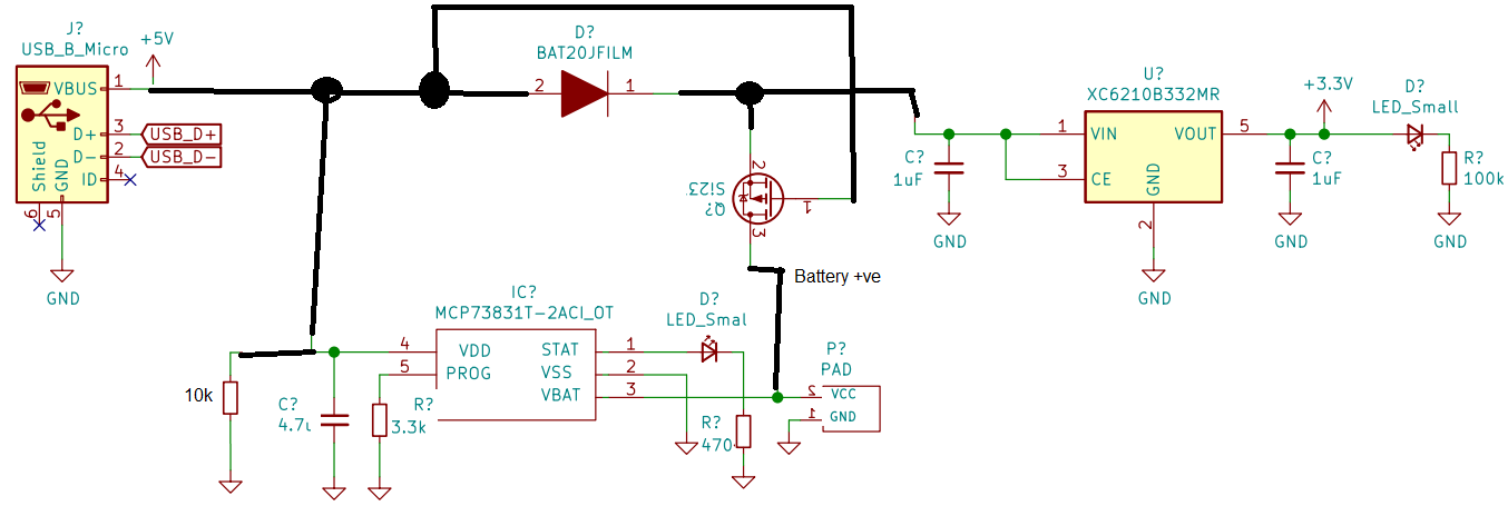

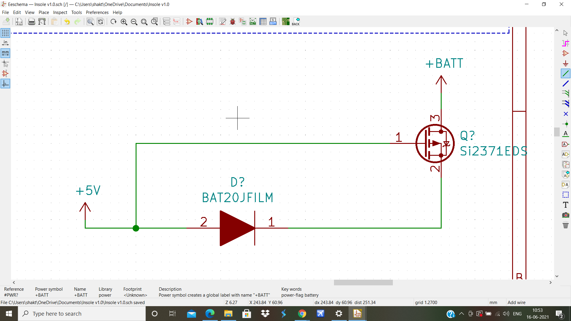

Thank you, I would also like to ask I am designing it myself, but I have a 5v coming from a MicroUSB and the BATT is connected to a MCP73831T-2ACI/OT to the VBAT pin. I am not sure if I am doing it right, I think I have to connect pin 1 of the diode to pin 1 of the MOSFET and the 5V in to pin 2 of the MOSFET, but let me know if this is also right, I am also running the other components of this board on 3.3V, I can also share the entire schematic if you wish
The circuits that you posted in post #19 would have worked. The schematic you just posted won't work.
The MCP73831T is designed to charge Li-Ion batteries at 4.2 V, so it needs more than 4.2 V to fully charge the battery. You have supplied it with 3.3 V so it won't even start to charge the battery.
The circuit with the BAT20JFILM and the Si2371EDS will never conduct current in either direction.
The circuit that you posted in post #19 would have worked fine. Even if you change the ICs, the idea of those circuits is good, and you can adapt the ICs that you are using to that.
The first picture of post #19 is a "Wired-OR", which takes either the USB supply via the diode, or the battery via the MOSFET, and supplies the +5V line (which will not be at 5 V, it will be a bit less, but that's fine)
The second picture of post #19 is the charging circuit to charge the battery from the USB supply.
The third picture of post #19 is the regulator that takes the +5V line and regulates it to 3.3 V.
If you want the same functions, you should replicate the blocks that are shown in post #19
I have drawn out the circuit suggested below.
I have added a 10k resistor to ground on the input. That is to make sure that the VBUS is very low when the USB is disconnected. Without that, the MOSFET might not turn on properly. The 10k resistor might not be needed, but without it the VBUS could be at about 3 V.
The 100 k resistor in series with the LED will mean that it is very dim.

Thank you very much, ill put this into my schematics. My only concern was to not drive the LED with too much current. So what I understand is, the MOSFET and diode act as an 'OR' gate, whichever is higher than the other it will take power from that. Am I right?
That is correct, but it is not all of what is happening.
The body diode in the MOSFET and the diode act as an "OR" gate, as you had said.
The additional function is that when the USB voltage is low, and the battery voltage is high, the MOSFET will turn on. If there is a load of 100 mA, the body diode in the MOSFET will give a voltage drop of about 0.6 V. With the MOSFET on, the voltage drop would only be about 0.008 V. That is why the MOSFET is used, when a second diode would be cheaper and simpler.
