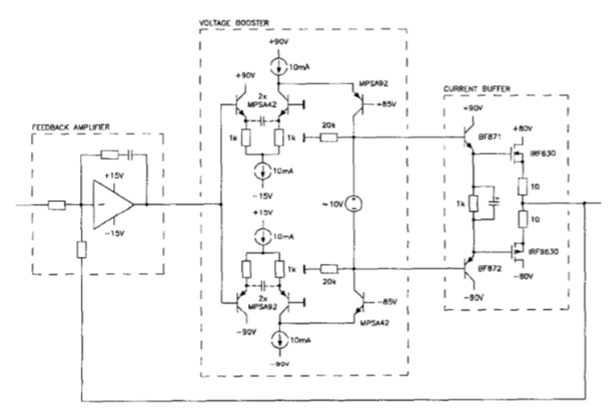

1. Its a Claas AB amp circuit.
2. Looks 200W capacity.
3. Explain its voltage booster.
4. Why current buffer is used?
5. Why should we care about " crossover distrotion"

You show a class-AB linear amplifier circuit that wastes a lot of power making heat. A class-D amplifier is completely different.
You do not say the frequencies you need or the load impedance.

Yes, people said "its not Class D, it might be Class AB. Its may be 200W.
Nothing Class D about it, but you can of course feed it with a square wave signal if you like.
Power stage quiescent current is set with the "~10 V" voltage in the middle (which should be thermally coupled/compensated with the output MOSFETs)p.

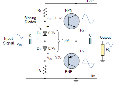

Lets post a basic image here
May be 13 years ago I have atudied this circuit.
In this style, NPN and PNP transistor has connected back to back. Vcc is used at the top, while other collector is grounded.
Like audio power amplifier, output is not taking from collector, its from combined emmiter.
Input and output capacitors are DC bloking capacitors? What load will see then!
Biasing resistance and diodes are maintaning input voltage. One cycle signal has been shared both of transiator's base, not sure forward and reversed biased diodes are helping to conduction, may be 1N4148 type.
Now interesting to see how the signal is amplified, for sure its not phase shift! Depending on amplification factor, it will talk. I think bandwidth is too narrow. For the high frequency application, we need to think.

with 10 volts across the driver bases in the schematic in post #1, it looks like it's biased class A. it looks more like a concept design than anything really workable.
is the amplifier actually driving a 1 ohm load? in what frequency range? audio? radio frequencies? DC or subaudio (DC to 20hz)?
No. The 10V is adjustable and feeds two transistor emitter-followers that feed two Mosfet followers. If the 10V is not changed then the gate-source of each Mosfet gets about 4.3V so sensitive Mosfets will be with high current in class-A and shorting the supply and low sensitivity Mosfets would barely be conducting and in class-B with crossover distortion.
