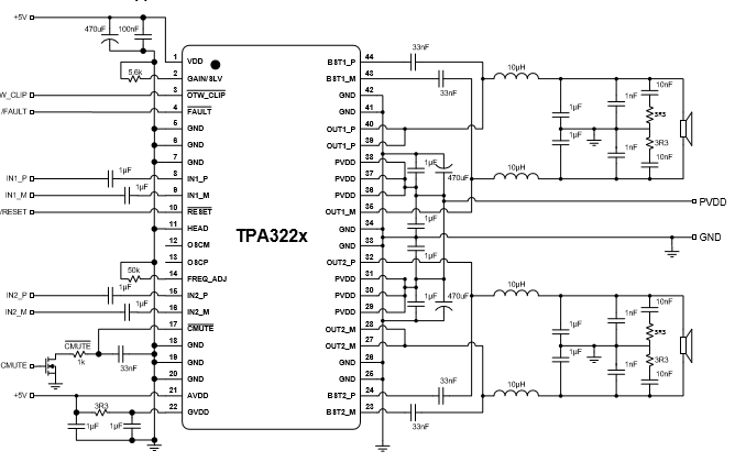

Typical Differential (2N) AD-Mode BTL Application
120721
At least go through this datasheet and now forget about particular TR impedances, switching, frequencies etc.
https://www.ti.com/product/TPA3220
The datasheet for the TPA3220 recommends a max power supply voltage of 30V and shows stereo outputs of 50W continuously into 8 ohms for both channels.
The datasheet shows higher power with higher distortion of 10% and when the loads are 4 ohms and also shows much higher power for short durations before it shuts down due to over-temperature.
The schematic shows output LC lowpass filters that remove the 480kHz switching frequency.

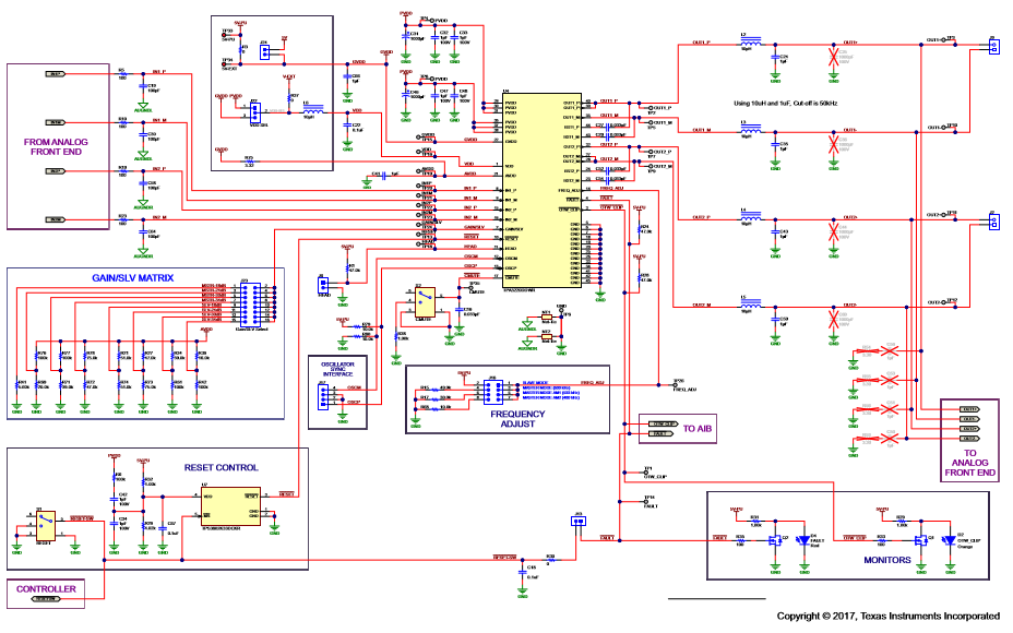

Looking at TI suggested TPA3220 EVM,
120729
LC filter is visible here! I wont ask you why its connected.;)
