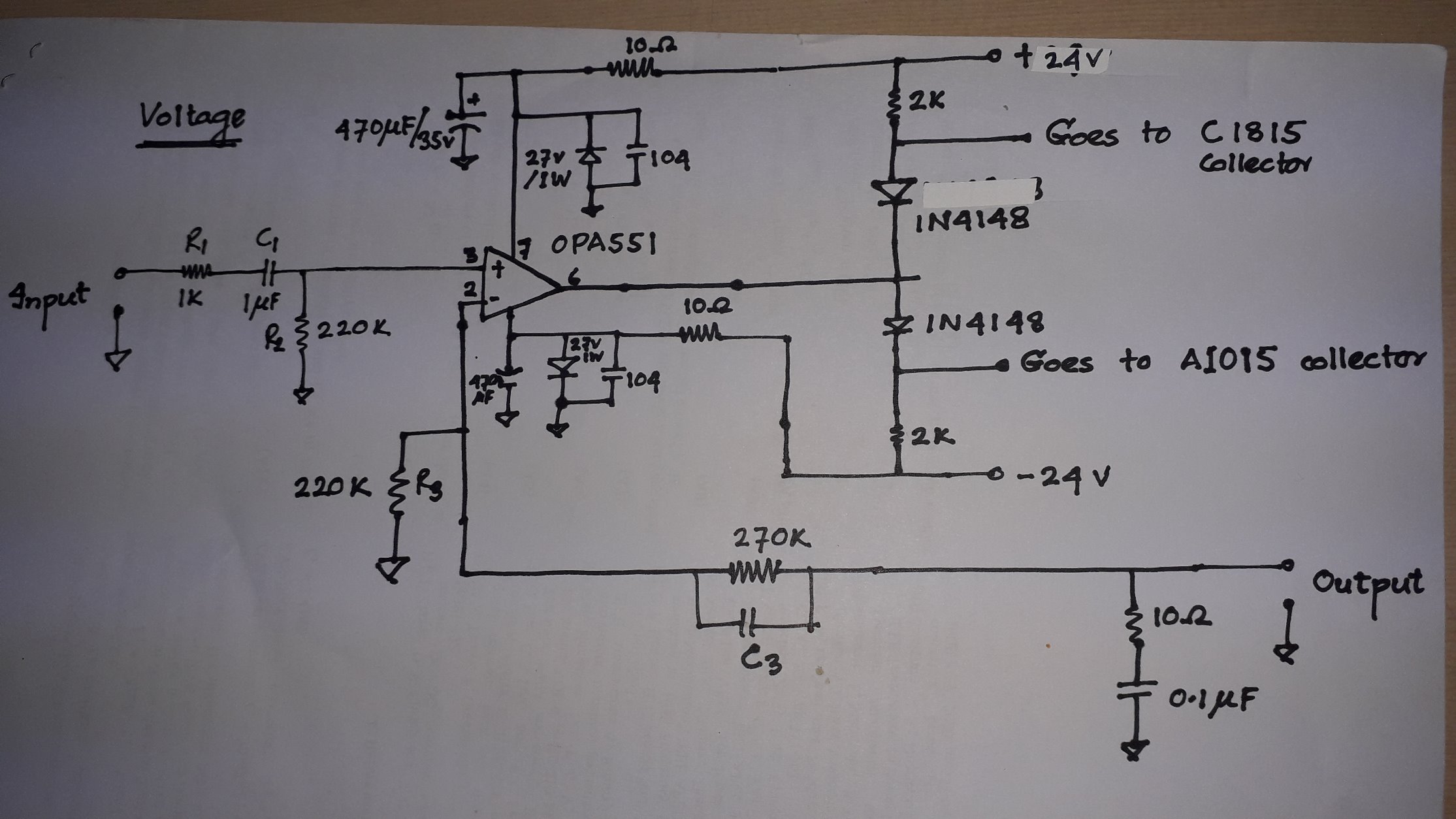

Please attach the schematic with parts values of the circuit you are talking about.
Okay, my circuit looks like (to you) for school going student's home work.
Take a look on attachment.
Discuss it for more knowledge!
Looks like in both case "current feedback amplifier" is used!
Why do you show two amplifiers? An amplifier amplifies BOTH the voltage AND the current.

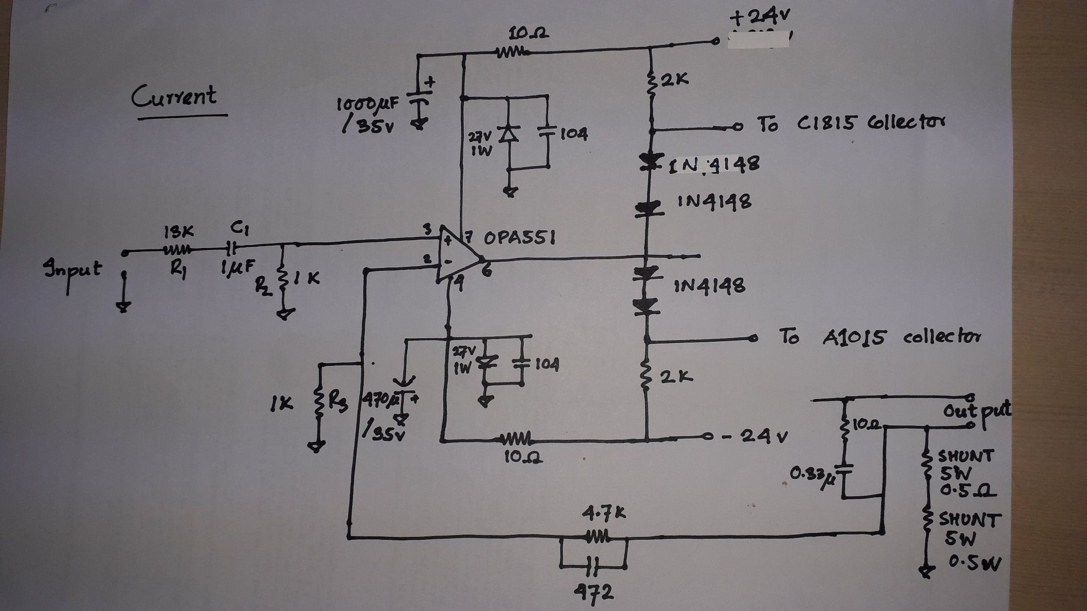

Your circuits have these serious problems:
1) The little 2SC1815 and little 2SA1015 transistors have current and power ratings much too small to be the output transistors of an audio power amplifier.
2) The output transistors should have their bases (not collectors) connected to the diodes.
3) You wrongly show ordinary diodes trying to limit the power supply voltages to the opamp instead of 27V Zener diodes.
4) Your 1st amplifier has a voltage gain too small at only 1+ (270k/220k)= 2.23 times.
5) Your 2nd amplifier has a voltage gain much too small at only 1/14 x [1+ (4.7k/1k)]= 0.41 times without a load and less when there is a load.
6) The series 0.5 ohm resistors are not used in in series with a speaker. They should be in series with the emitters of the output transistors.
7) The four diodes might be used if the output transistors are power darlingtons but you do not show darlingtons.
8) Your 472 capacitor parallel with the 4.7k negative feedback resistor cuts all high frequencies at 7240Hz and above.

you need thermal compensation to control the idle current in the output stage. silicon transistors have a negative temperature coefficient, so the Vbe is reduced 2.2mV for every deg C of temperature increase. if the bias voltage remains the same, this turns on the transistor on harder, increasing the idle current, and increasing the temperature even more. the cure for this is a bias clamp, which acts like an adjustable zener diode. the transistor in this bias circuit is usually mounted on the heat sink between the output transistors so that it can compensate for the change in temperature by reducing the bias voltage of the output transistors.
1: You do not give the complete schematic showing how the output transistors interconnect with the driver, power and the load.
It's impossible to know how the output will react to the driver stages without that.
2: If both drive circuits you show are connected to the same output circuit, one will have an overriding effect on the other and not provide separate and simultaneous control of voltage and current. As you have been repeatedly told, that would be impossible.
It's no different to a bench PSU that has voltage and current controls - each limits the other, they do not control simultaneously.
Plus the points AG has already made.
quite a few far east manufacturers use a standard diode symbol with a "B" next to it. the usual zener symbol isn't standardized everywhere. with +/-24V supply rails, they don't do anything anyway, unless +/-30V is planned later.
Even they are small power rating, these are helping to balance for the next stage. Cant you see voltage divider is used in each side!
2SC1815 and little 2SA1015 has common emiter connection.
Yes, mistake, suppose its zenerdiode's symbol.
Do you think, this amplifier is in following structure, then dont you think its enough?
Interesting to see why this time gain equation is different.
Imagine that a "CT" is used here in output.
Yes, I told you before. Lets understand the this amplifier first!
Right at this moment this capacitor is absent! its MC type. Why we use this? For high frequency attinuation?

Looking at your comment on posted feedback amplifier, could you tell me more about " current amplifier"?
Your current amplifier input has a 13k resistor in series with a 1k resistor to ground then it attenuates the signal to 1/14th its original level. Why?
Why are you using transformers?
