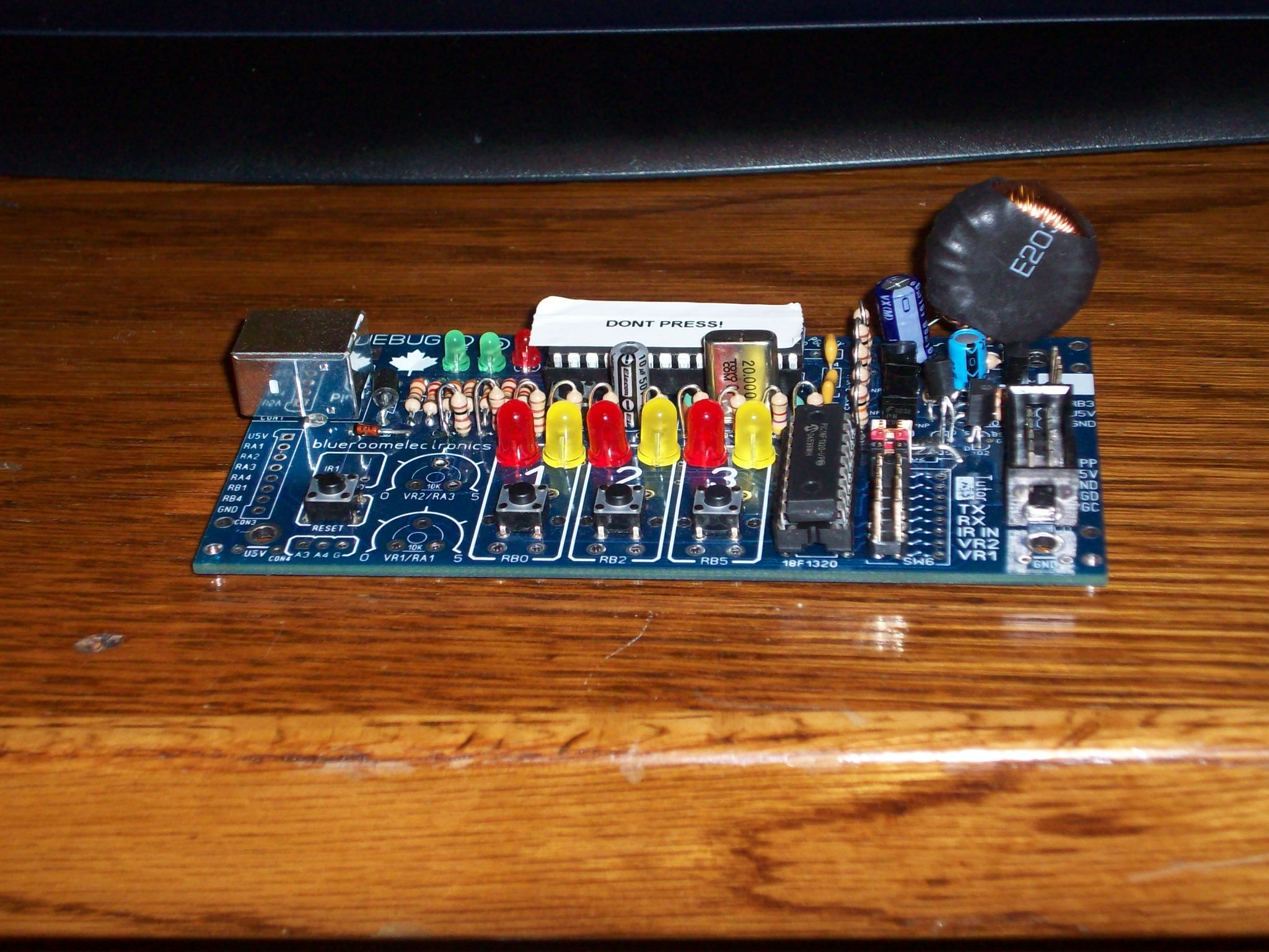

I finally got my junebug working!!! (big thanks to 3v0, Bill for the board, looks awesome)
Heres a pic:
It is pretty "special", as in ride the short bus special. Reistors and caps too big, crystal too big, no DIP Switch but shorting blocks, Massive Toroid, Messed up Ferrite bead (found off old monitor board, it is all twisted up) and tiny switches. But hey at least it can recognize chips and work!
Any comments on my junebug?
Heres a pic:
Hahahahaha!!! :D :D :D That fatty inductor is hilarious! :D You couldn't find a bigger one?
Hey, as long as it works, no problem. :p
While we were working on it Krumlink asked what the bootloader button was for. I told him that he would have to re-flash the chip if he hit it. Not exactly right but close enough, I did not want to get into bootloaders at the point. He promptly posted the danger sign on the unit. :)
