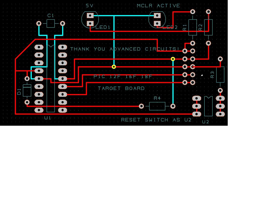

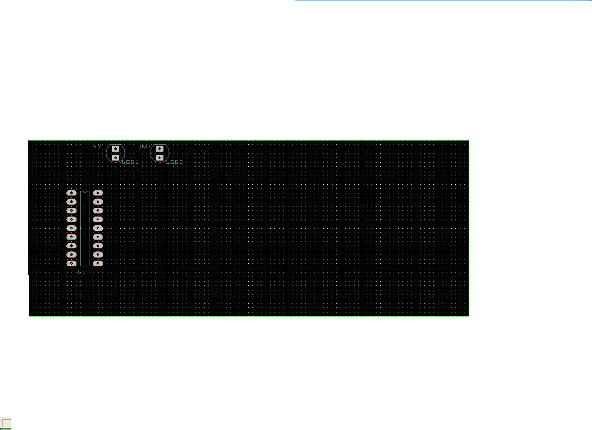

I was thinking of designing a board for programming a 18 Pin DIP, and I was wondering what are some features I should have on it? I want to fill this 5x2 or slightly small board up :D

After thinking of things to add, this is what I came up with :D
I am using U2 (6 pin DIP as a Switch because of its template :)
MCLR has a data processing LED on it :)
Shouldn't the 3 switches in U2 be wired to 3 separate IO pins? :D
8 pin DIP switches (4 switches) are more common also.
Nope, I want them to be bussed together, just because I said, so ok?
Oh wait, you got a problem with that buddy? Come on bring it on! Lets go! :p
I found that 3 DIP Switches are cheaper than a 4 dip switch. It will still look good.
If you want bussed switches then a DP3T switch will do, more expensive than a dip though but nice for switching the MCLR stuff / project stuff. Cheaper yet would be a far more common DPDT switch on just RB6, RB7. Avoid using MLCR for anything but a reset / ICD connection, if you're desperate for that extra I/O line then use a larger PIC.

I am using the mclr pin as a reset, by shorting it to ground. It should be here by next week. Bill if you want these boards for something, PM me and we can set up a deal :)
I will let you know how this one works.

I just noticed you're using a three position switch for reset. :( IMHO just don't add one, the Junebug / Inchworm can both control MCLR. And for standalone; the PIC will reset on powerup.
If you're worried about lockup then learn about the WDT.
Edit here's a simple single sided PCB layout, try to avoid right-angles on traces if you can and lay it out on a grid. This grid is 0.5"
