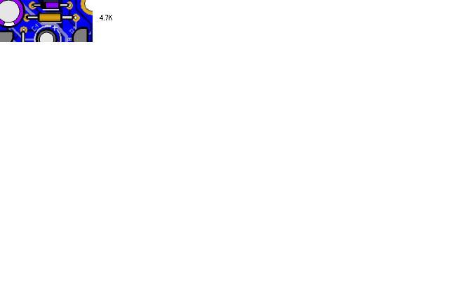

For anybody almost done with their Junebug programmer or about to get one, I have a few important pointers for you. PS Bill: Check over your Assembly manual :D
The attached images are ones that I think that you may be confused with. One that You may overlook is R11 and R12, they go under the 18F2550 and are 100 ohm resistors.
R7 is a 100k resistor
Watch the MOSFET Pin out
The 2N3904 is substitutable with a 2N2222A
The 2N3906 is substitutable with a 2N2907A
I will keep this updated as I go. Also, watch how you put in those switches!

Very nice, and yes those transistors will work. The tricky ones are the FETs but both are optional (they allow VPP before VDD programming and shorted target VDD testing)
I'm working on the manual a wee bit everyday.
I don't think the switches will fit in the wrong way, they're rectangular.
The ferrite bead is recommended but you can use a wire link if you don't have one.
And you can stand little 1/8 watt resistors where the SIPs go.
