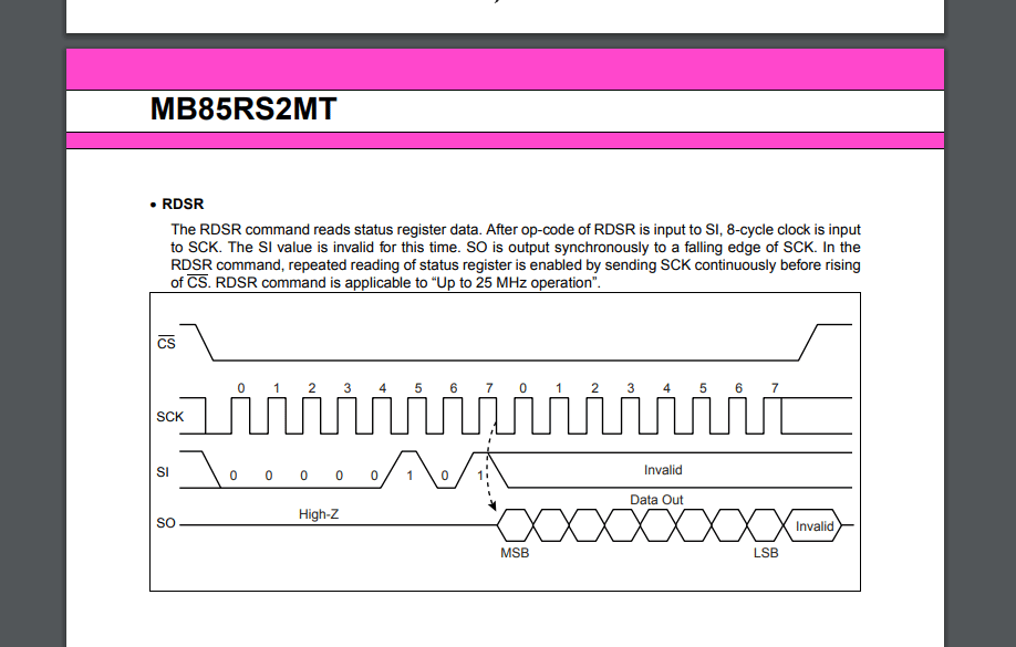

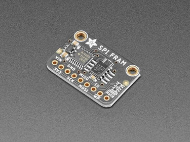

Any code(C) tips on using a SPI Non-Volatile FRAM Breakout - 2 Mbit / 256 KBytes - MB85RS2MTA , please. I'm using a PIC18F57Q43 .(Nano dev bd ) MPLABX 6.5

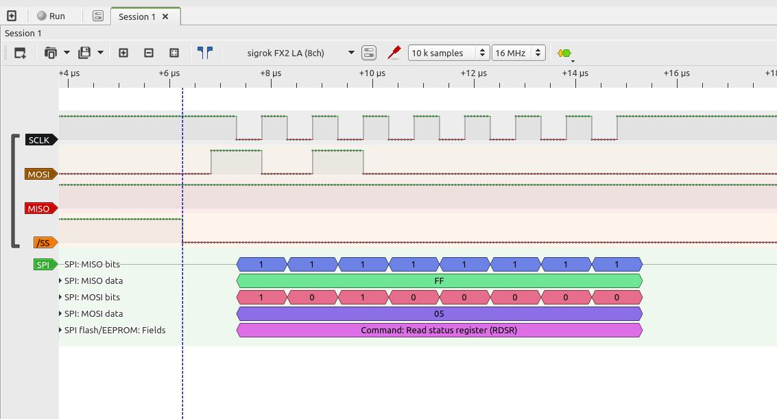

Edit... currently getting no RX data back on a Read Status Register ( missing RX clocks ? )
read a second byte to get the data.
Thanks , I did get a second byte working sort of ( a read) , but still no data on the MISO .. the decoder said " a write was still in progress " but cannot get to repeat the message now :( I'm still trying to get my grey cells round the SPI , maybe trying too many things at once ! Back to rtfm..
A partial result . mainly by trial and error.. very much a work in progress ... ( MISO PPS as input was in error :banghead: )

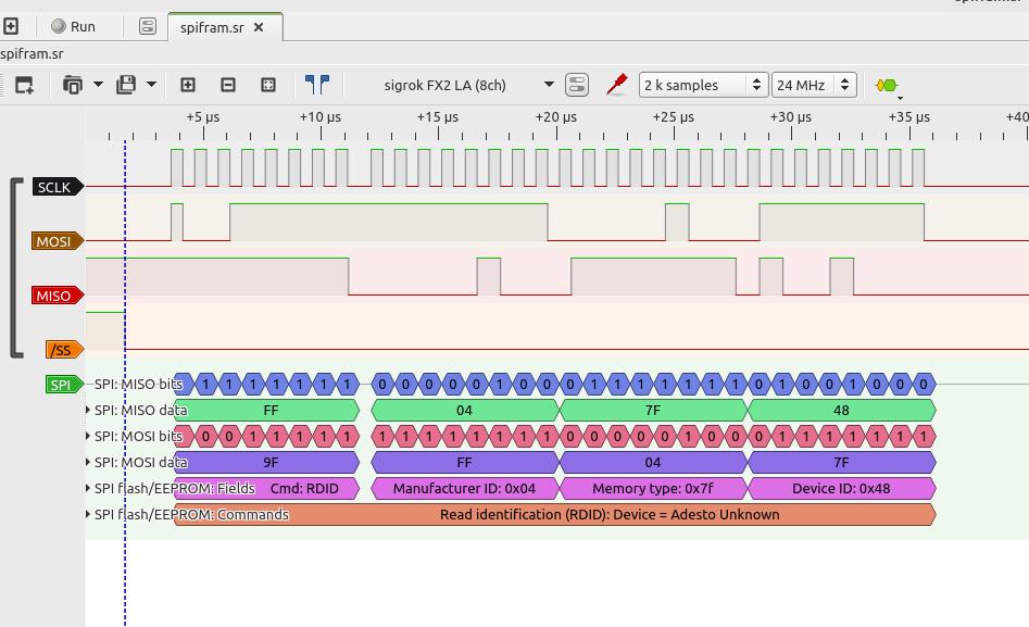

Edit, I have captured the device ID , now working on getting the ram addressed read and write.

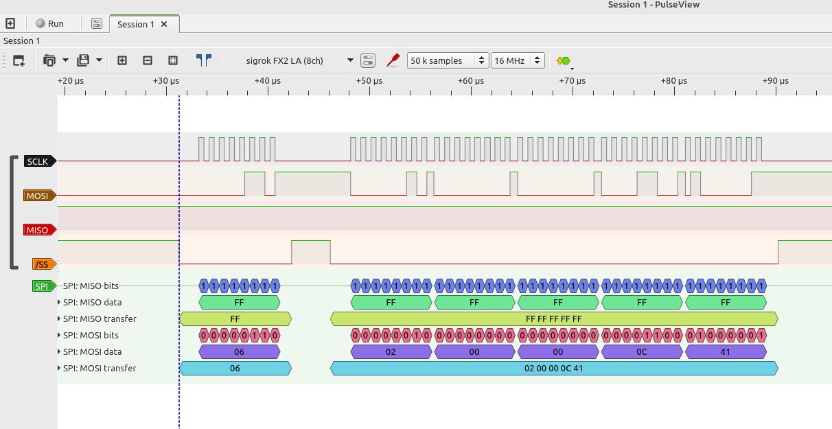

Answered my own Q .. Fram seems to need SS to transition for each command, to work in single byte write or read ( sequential multiple W or R are possible with SS staying low ) . I am not able to assign SS to an SPI controlled available IO pin, Only ports A or D, and they are all taken ( 43 IO on this PIC ! ) , so had to control SS after each command. MISO from the module is only driven to 3.3v , but does not seem to be a problem with PIC threshold set to TTL levels. Addresses are 18 bits / 3 bytes, fortunately XC8 has built in 24 bit variables ( __uint24 __int24 )

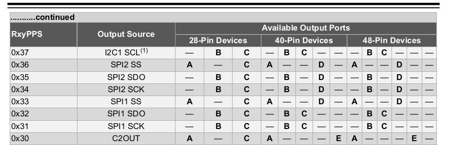

Thanks for the link, may come in useful .. the PIC18F57Q43 and nano curiosity board PPS is a bit restrictive with the output port options for SPI, SS only on ports A and D and I am using them for the Z80 SRAM address and F for data . SS / CS via the normal port IO seems to work fine ?
On SPI the pin isn't dedicated... Only in slave mode.. It can be ANY pin in master mode..
Ian's right for a pic with an MSSP peripheral used in SPI mode, but in many newer devices they have replaced the MSSP with individual SPI and I2C peripherals that work a bit differently, and the 18FxxQ43 is one of them.
On these you can have the SPI master assert control of the SS output automatically but then you are limited on which pins you can use since the SS output is mapped via PPS. If you want to control the SS output as a general IO pin in software, then don't map the SS PPS output... leave the IO pin mapped to LATxy and control it yourself.
