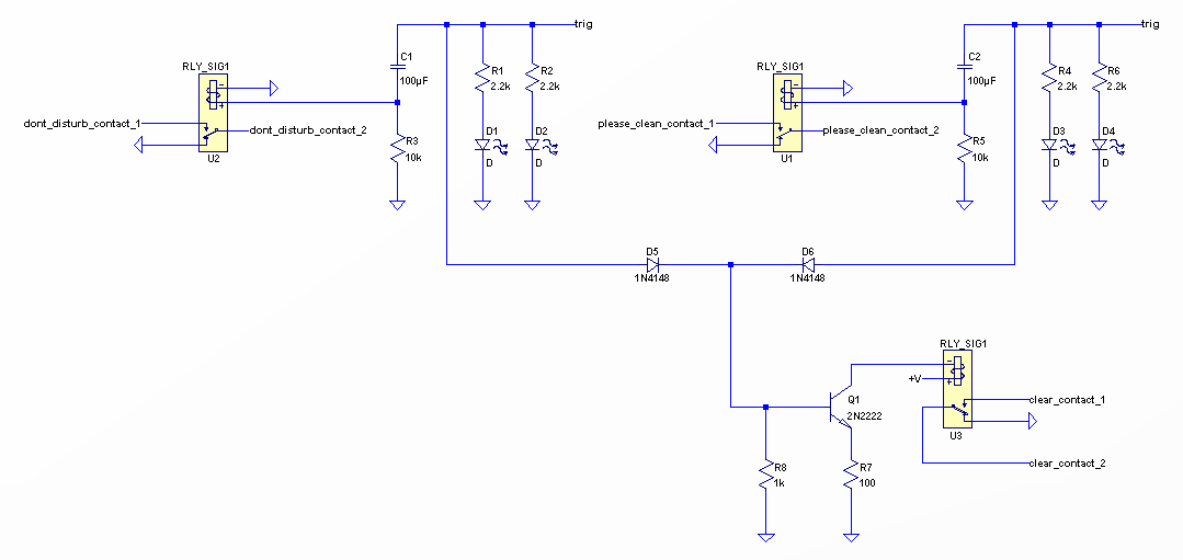

OK, I've solved the problem as originally posted, but I do NOT suggest this as a final solution. ;) This so-called "solution" is only because I was fascinated by the relays-only idea. That said, this solution does use two diodes and one transistor.
I'm too tired to draw the whole thing out including the DPDT toggle switch wiring but the following should illustrate the idea. I'll try to get the DPDT wiring drawn out tomorrow if anyone is interested.
This solution requires three relays (SPST, although I have used DPDTs in testing and the schematic shows SPDTs), one DPDT toggle switch (centre-off), one 2N2222, a couple of signal diodes, two 100uF caps, and a handful of resistors and LEDs. It's pretty bulky and a little power-hungry for my taste but I've just carried the idea this far to see if I could come up with something which could do the job using the original relays-only requirement. Also, this is running on 12V, because that's what my relays need. :) And one thing you can't see yet is that it uses Ken's idea for the DPDT switch to discharge the caps (although that problem seems to also be partly solved by the centre-clear addition).
In the schematic shown the LED resistors are chosen for low-power 2mA LEDs with no thought yet given to differing red/green LED current requirements.

Ugh Torben, you must be using real high res settings. Your image sends all your text way off my screen. My eyesight is not so good so I stick to 1152x864. Why two leds per trig branch? Does that setup up currents or something for the cap?
I still like my circuit as it only needs 10 parts, no relays. Not as bullet proof as yours though :)
Nope, just one LED for inside the door and one LED for outside the door.
Well, like I said I don't think this is a good final solution. I just wanted to see if I could figure out a way to solve the problem as originally presented. Now I can free my mind of that particular problem and move on to more realistic solutions, which will probably look more like yours. :)

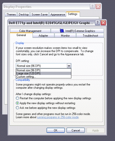

You could alter the DPI setting to make system fonts larger, rather than using a lower resolution.
Yeah, that's what I do. Makes the fonts look smoother too.

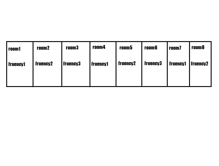

I mean identification. How will you know one remote from another? If they all put out same frequency and codes, it will be hard to know which room is requesting service. See what I mean?
I think the range of the remote control should be selected not to be so large, so that we can arrange the remote control sets as the picture shown. I think the signal will not overlape. How about your suggestion?

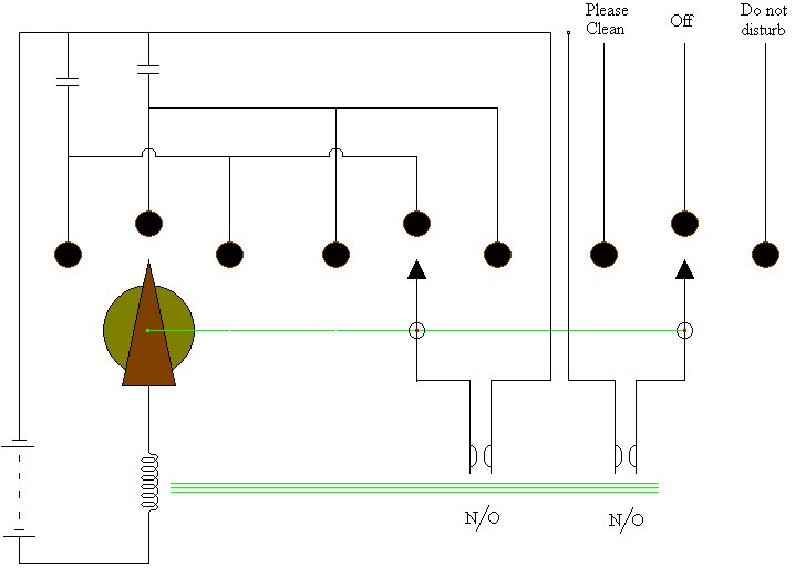

Bit tired ....
and pondered this so long that i'm not sure ive got it right ....
Also havent included the LED indication, another set of three probably.
As shown, should be minimum battery draw,
and quenching of the cap thats not in use,
so that even mistaken switching between positions should not be a problem.
John

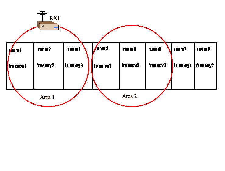

Ok here are a few questions.
I took your image and modified it. I see what your thinking here but here is the thing. With limited range Transmit, the receiver would have to be close enough for coverage. Look at my image, with coverage for Area 1, then Area 2 would not be able to transmit to RX1. Only way I see around this is multiple receive units, is that your plan?
Also is the reciever able to receive multiple frequencies? Say room 1-3 frequency?

Going by Adrians previous image. It would appear that there is a seperate remote for each room, ie. room 1 has freq 1, room 2 uses freq 2 etc. The drawing provided by Adrian would also imply a multi channel RX which I questioned. Adrian also assumed he could use redundant remote frequencies which would not interfere based on distance from TX room 1 with TX room 4, which would force multi RX units to maintain full floor coverage.
IMHO this plan is not to workable as is.
Perhaps the wireless idea be thrown out in lieu of a wired approach like a multi addressable 2 wire bus where the wires are ran under carpet or something.
I dunno...
Each room have it own set of remote control and reciever. room 1-3 are independent. The frequency used in room1 will not be used in room2,3 and vice versa.
