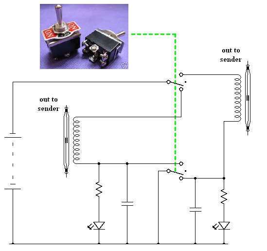

One point. How about the middle switch position detection that the OP wanted? Another switch pole maybe?
Hi Ken,
You have improved on that circuit.
As to the red and green, Adrian doesnt mention anywhere that he will use two different colours, but yes it is quite reasonable to think so.
And yes, to appear similar brightness they would need slightly different resistors.
Curiously, i was also thinking that the switch might be able to discharge the opposite capacitor but i didn't set anything down, nor did i think how it might do that.
I was thinking along those lines, simply to enable the use of reed-switches, but i did not actually come up with anything.
I am most taken with the simplicity and small number of components in this circuit.
I have taken the liberty of re-drawing the same circuit, using reed switches, and adding a picture of the type of switch.
The OP (original poster) has a choice of ordinary relays or reed switches.
As to the contacts getting damaged, ive abused relays for years and i think that any normal relay could discharge a few microfahrads without a problem, but using the switch is of course much better.

kens_circuit2-jpg.21369

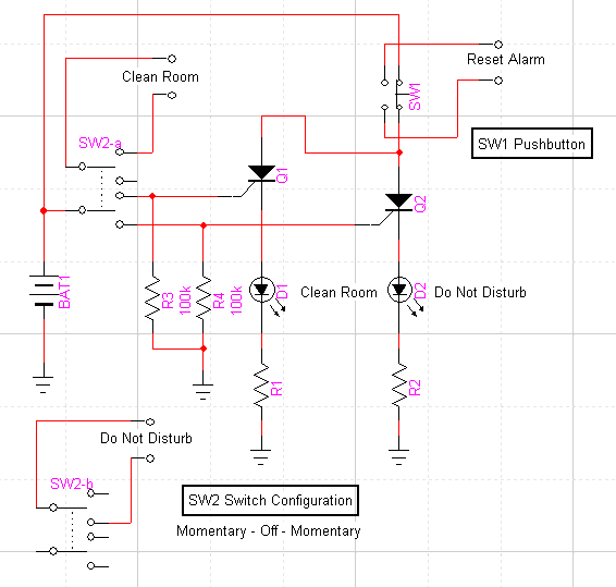

I started thinking about this a little more, and I came up with something I thought might work for ya, and it is very simple to construct. To boot, you do not even need to reverse engineer your remotes as this will just wire in place of a remote switch.
Now I do violate your single switch rule but before you dismiss this idea read on. This configuration would have two switches, one would be dual DPDT with OFF and two momentary contacts. Like
Momentary - OFF - Momentary
Second switch would be a pushbutton used to clear alarm. Also this circuit uses no expensive relays and consist of 10 parts.
So 1 switch set alarm and notifies remote and lites LED, other switch clears LED and notifies remote.

  • SW1 - Pushbutton switch
  • SW2 - Dual DPDT
  • Q1-Q2 SCR Value TBD
  • D1-D2 LED value TBD
  • R1-R4 Resistor
I did not select any parts as I did not want to do the research and find this idea is not going to be to your liking. So will help select values if you wish to continue.
One question, what will the remote be doing? will it notify a computer or something?
Circuit attached

Is the switch 1 used to reset all the alarm status to "OFF"?
Is your idea like the following?
Toggle the "momentary-off-momentary" button to set either "clean" or "do not disturb " to alarm status. If I want to reset the alarm status to "OFF", press the reset button, isn't it?
the remote is used to notify a receiver, the remote and the receiver is a set of security device.
Thank You.
Yes
Yes that is my thinking.

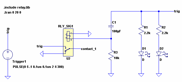

Hi Mike (and Adrian and John and Ken),
I was up late last night putzing around with this idea and came to a few conclusions, which it looks like Mike has also reached.
The whole thing would be fairly easy if we assumed the use of a 3PDT switch instead of a DPDT switch--otherwise Mike's idea of the separate "Clear" button is necessary. Using a DPDT centre-off toggle switch and a pair of relays I built a simple circuit which pulses the relay and lights the appropriate LEDs. I wired the DPDT switch so that when going to "Please clean" it would discharge the capacitor on the "Do not disturb" side and vice versa as Ken suggested, but I haven't yet figured out how to wire it to do that when returning to the centre-off position. I'm not sure it can be done without the 3PDT switch. Anyway, this means that the thing can still be confused by switching rapidly back and forth between centre and one side. Rapid switching all the way from one side to the other works fine, though.
Getting the centre-off position to trigger a pulse on a third relay is also slowing me up. I am currently thinking about diode-transistor logic to try to get that effect.
However, it seems to me that the unit will wind up being fairly bulky in the end if it contains three relays. If the remote control contacts need only that one side be brought high or low then using transistors instead of relays may be able to save quite a bit of space (and some current too).
Anyway, I'm kinda rambling here. I have to go do some housework but I'll take another look at this later on.

Oh yeah. I've attached the basic schematic I've been using so far. It's drawn just for one side and only addresses the pulse generation. If I get a bit more time later on I'll draw out what I actually have wired up. This is just the RC differentiator/relay portion of the circuit.

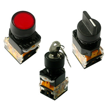

Would it be possible to use a rotary switch instead of a toggle?
I am sure I've forgotten some questions but if you can answer the above it might help us to help you.
Torben
Ya know, when I was in the Navy we had this piece of gear for sat-comm stuff. Anyways I remember it had this really cool switch on it. It was 3 way, but middle position was push button. Now that would be cool, just can't figure out what you would call it. So it was like ON- PB -ON. I ordered a few switch catalogs to see if anything resembles what I remember.
_______________Edit__________________
Brain fog is clearing. It was a rotary knob switch, with a center PB...
