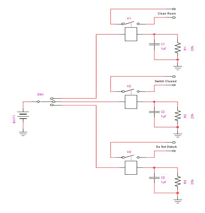

Ok here is a circuit of what I was thinking. Not as fancy as a MCU but it is minimal parts and easy to build. I ran it on a simulator just to make sure it works. It did, but you may need to play with the cap value to get your on time just right. Once the cap is charged the circuit draws little current which is nice. I would recommend you make a little breadboard circuit before you go into mass production :)
You make the same think with me:)
but i don't know why the relay doesn't toggle when i turn the switch,
could you tell me how does it work?
Here is what I think you want. Person flips the switch, relay closes for a short moment remote sends alarm, then relay re-opens. Now if the switch is put back in the middle, you want to be notified that this occurred, so again when switch goes to middle the relay activates for a moment then deactivates triggering your remote. As I am speaking I now see a flaw in this plan. What happens if someone flips the switch into the wrong position, then puts it into the right position, your alarm panel would give multiple alarms.
But for basic circuit operation of what I have shown here is what happens:
At initial standing state, relays are off. When a switch is moved there is a momentary rush of current through the relay and it activates. After a short time the capacitor charges up to the battery voltage minus drop across relay. Once cap is charged, the potential across the relay is insufficient to maintain relay activation and therefore it goes back to the off state. So what your relay should do is something like a short pulse _____-----_____. In theory anyways. The on time needs to be long enough for your remote to recognize the pulse.
The more I think about it, the more I think my circuit is too crude, perhaps an MCU might be what you need to prevent false alarms and give the circuit a little brains. But then your cost will go up which might matter depending on amount of rooms.
Would it not just be easier to have the customer use a do not disturb sign or flip it over to clean?
Sorry, guess I was not much help :(

One of the things that are curious, is the interlocking arrangements of the switches.
As Mikebits has said,
couldn't the customer have a "do not disturb" sign, and flip it over for "clean" ?
Well, the customer could, if the card were regularly checked by the cleaners.
But this arrangement (i guess) is supposed to operate a radio sender, to inform the staff.
But Mikebits raises a good point,
namely that a card has only two sides,
so why have two switches with interlocks ...?
Maybe the original poster doesnt want two switches,
he wants to use switches with two positions, " ON - OFF - ON "
and maybe this got lost in the translation.
Why have two switches with interlocks ?
I think he only needs one switch per box.
If i am wrong, i assume he will soon say so.
So, one switch ... yes ?

Hi John!
I have these same questions. Why two switches and not one switch with three positions?
Another question I have: why relays? Could not transistors be used and thereby save a lot of current?
If I understand the requirements correctly, they are:
  • There is a switch in the room which the customer can set to "Please clean", "Clear", or "Do not disturb".
  • Any time the switch is moved to "Please clean" or "Do not disturb", the corresponding LED is lit and the corresponding button on the remote control should be activated. There will be duplicate LEDs on both sides of the door, so that both the customer and the cleaners can see them.
  • Any time the switch is moved to "Clear", any lit LEDs must be turned off and another button on the remote control will be activated.
Adrian, is this correct?
Torben

How to make a short pulse to activate the relay each time you turn the switch.
May be it's better to tell the actual condition.
PS: the original remote control set is control like that: Each time you press the button. The status of the reciever will hold and return to original status when you press the button on the remote control again.
Assume there is only one 3 ways toggle switch.
1. I am the customer now. I am having the bath and do not want any disturb. So i turn to do not disturb. then the LED on the control box and reciever lit up.
2. After i finished the bath. I turn the switch to middle, then the LED on both side will off.
In this procedure. How do you activate the relay for both actions? This is the difficulty.
The original remote control will use it's own battery which can last for over one month. The box will use another battery. Of course both of them can use the same battery.

Yes , you are right.
But one thing should be reminded that the relay to activate the remote control must be a pulse for a second. Can't hold the activate status.

I suspect that the button works by either pulling a line high or low--I was hoping to figure out which. Then again, I'm not sure that it matters.
I will think about this some more over the next couple of hours and see what I can come up with.

I admit, my circuit was somewhat crude as I stated earlier, but without knowing Adrian's background in circuits I attempted to keep it real simple, but I was not happy with it.
But Adrian rest assured, now that Torben is on the case you will have a solution. This guy sometimes goes as far as to build a prototype to make sure something works before he gives the circuit to ya. Your in good hands. Oh Adrian, dont forget to watch the eclipse over there in China on Friday :)
Well, it's also hard to know how to approach it without being sure about the remote control itself. I like simple solutions like yours. The devil of it is that there's often that one requirement which makes the simple solution impractical. :/
I'm taking a swing at the problem but that's no guarantee of anything. Any help you can give me will be much appreciated! Your circuit is giving me ideas too.
