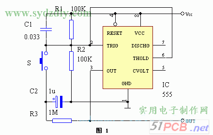

The pulse should be enough to activate the relay for a second is ok.
what is your low-power solution? can you should me the circuit?
the one i used before is the attachment
The relay i used is TAKAMISAWA RY12W-K

What kind of batteries are you using, and how many? That relay wants 8.5V on its coil in order to trip.
Also, what (exactly, as in model number) is the 555 chip you are using? There are regular 555s, which consume more power, and CMOS 555s, which do the same thing but the timing can be adjusted further and they use less power.
Also, what kind of LEDs are you using?
How many hours per day must the device have LEDs lit on it, and how many?
Torben

The battery i used is rechargeable 11.1v 1000mAh. The relay should not hold for long time since high power consumption.
the 555 i used is 555D JRC 3092A
the LEDs i used are somehow like the attachment. I think it should consume less than 10mA.
2 LEDs on the panel and lit on about half a day.

You might be able to get away with something like so, Switch goes on, relay momentarily activates until cap charges up and relay goes off. Play with RC values to get right amount of relay closure. Bigger resistor is better as less current draw. That is about as simple as I can think of.

Yes, you circuit can solve the relay problem, but the toggle switch will not spring back.......so when you turn on , the relay will hold until you turn the toggle switch to off....but i need to activate the relay when it turn to off and on, do you get what i mean? Each time you turn the toggle switch, the relay will hold a second and return to the normal state.
As soon as you toggle your switch, the relay will activate until cap is charged and then decactivate. Circuit will not toggle again until switch is turned off and then back on.
that's the problem, i want the relay activate again when you turn the switch to off just like when you turn on the switch
I think I see what your saying, so you want to know when the switch gets returned to the middle position such as when a cleaning person or the customer turns it off. Is that it?
yes, since each time you turn the switch will toggle the reciever to on/off status of "clean" and "don't disturb" through the remote control. so each time you take action in the remote control panel will affect the status of the reciever and so i need the relay to be activate each time you turn the switch.
Well you could duplicate the circuit I drew 3 times. 1 for Clean room, 1 for Do not wake my sleepy self, and lastly 1 for switch cleared, but that sounds messy I think. I am tired, and think I am going to sleep in a bit, but I can look into tomorrow when I am more awake.
