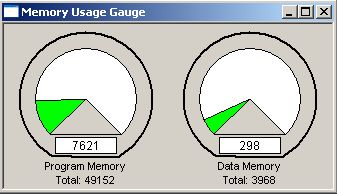

Can someone help me create a 800 byte buffer lol its for a 18F2525
This is my usage so far:
usage-jpg.31126

If you are getting the error
Error [1300] stack frame too large
A simple way to fix it is to make the variable global.
If you put it inside main or any other function it will allocate memory from the stack. If you make it global it does not.
Give it a try.

im getting this:
MPLINK 4.31, Linker
Copyright (c) 2009 Microchip Technology Inc.
Error - section '.udata_nokia7110.o' can not fit the section. Section '.udata_nokia7110.o' length=0x00000304
Errors    : 1
Im trying to create:
unsigned char ScreenBuff[770];

The only fix i know of is :
#pragma idata bigdata
#pragma idata
Linker Modification :
DATABANK   NAME=gpr10      START=0xA00          END=0xDFF	//END=0xAFF
//DATABANK   NAME=gpr11      START=0xB00          END=0xBFF
//DATABANK   NAME=gpr12      START=0xC00          END=0xCFF
//DATABANK   NAME=gpr13      START=0xD00          END=0xDFF
SECTION    NAME=bigdata    RAM=gpr10
