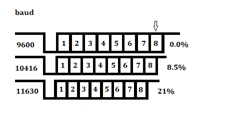

Then if you are using a 12Mhz frequency ( its in the edit properties ) your TH1 needs to be altered to suit.
12Mhz closest to 9600 baud is the same 0xFD but gives a baud of 10416 quite a bit off
I was never sure about baud error but a baud of 10416 will finish way before the stop bit
Note** the bit error after 8 bits will be over the 50%
The calculation is (10416-9600) / (9600) * 100 8.5% error the picture says it all
the sample is 50% of the bit each bit at 9600 is 1.04uS so the speed your getting ain't quite getting there

I'm using 11.0592Mhz....
Everything is working properly now. The delay was too big (1000). I had to reduce it.
