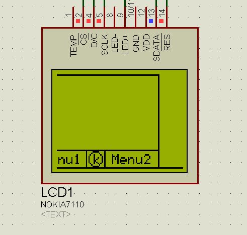

Now you can:
		lcd_setline(0,95,64,95);
		lcd_setline(64,0,64,95);
		lcd_setline(0,0,64,0);
		lcd_setline(0,0,0,95);
to get:
I am going to edit some of the code with the +18 because its a few functions with that issue.

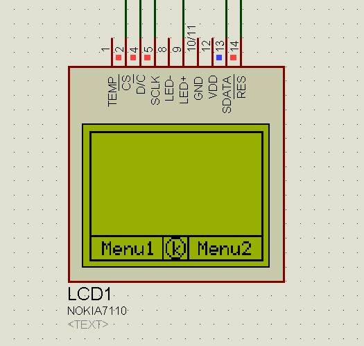

More coding would give you:
menu-jpg.30588
		lcd_setline(52,0,52,95);
		lcd_setline(52,40,64,40);
		lcd_setline(52,54,64,54);
		lcd_str(55,7,"Menu1",NORMAL);
		lcd_str(55,60,"Menu2",NORMAL);
		lcd_str(55,46,"k",NORMAL);
		lcd_setcircle(58,47,5);
using this altered code:

This is what happens when you dont define the NOKIA7110...
nodefine-jpg.30593
and when you do:
menu-jpg.30592

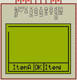

Hey i was using your new code and notice it doesnt let me write a character pass a certain point look:
		lcd_setrect(0,0,95,64,SET);
		lcd_setrect(52,0,95,64,SET);
		lcd_setrect(52,40,16,64,SET);
		lcd_str(55,42,"OK",NORMAL);
		lcd_str(55,7,"ItemA",NORMAL);
		lcd_str(55,58,"ItemA",NORMAL);
Ya, those are the line and circle functions I used. rectangle too:
void lcd7110_set_rect(int x0, int y0, int x1, int y1)
    lcd7110_set_line(x0, y0, x1, y0);
    lcd7110_set_line(x0, y1, x1, y1);
    lcd7110_set_line(x0, y0, x0, y1);
    lcd7110_set_line(x1, y0, x1, y1);
