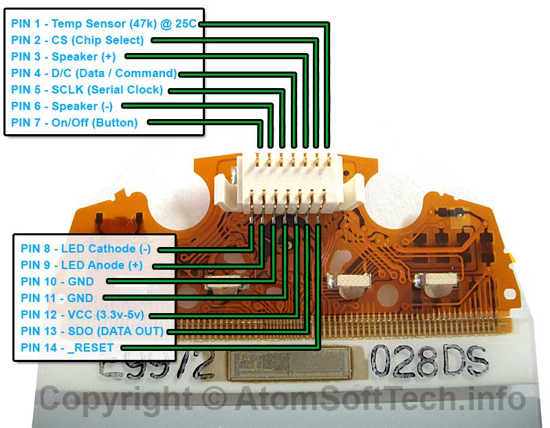

Heh sorry. im looking through it all tons of projects ive done and never posted... like a few hundred ... the issue is non are named good :(
Here it is:
You can download from here or from Attachment...
Folders:
..SOURCE - Has Source C files and such
..Datasheet - Has the data sheet
..Schematic and Eagle Library - has well the schematic and eagle library and custom pinout picture:
atom_pinout-jpg.40446
