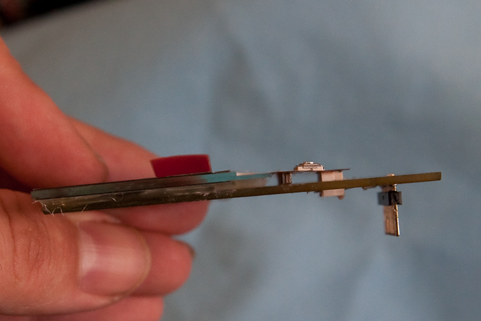

I am in the process of working on getting Matt's connector setup working. I have the board and the clamp drilled. It looks like it will align and hold down as it should. To finish it I just need to align the toner mask and etch.

Matt's connection solution
20090619-lcd7110-002-jpg.30552
Mark, not Matt.

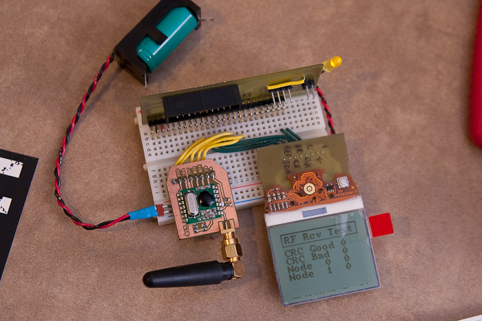

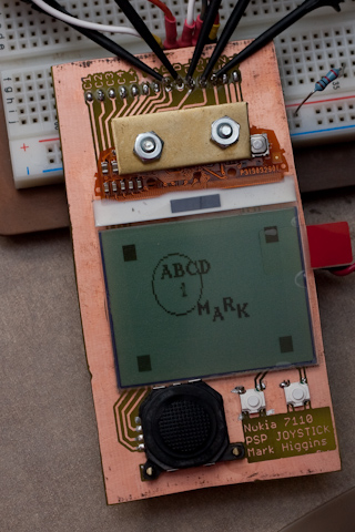

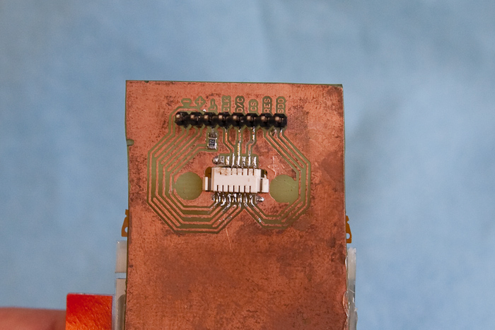

I have experimented with another mounting method, which I am using now. I drill a hole through the board, square it off with a file, and put the connector through the board, soldering the connectors to contacts. It means you have to pull the metal contacts down and they are really tough to deal with.
It's hard to explain, but I'll take some pictures later tonight.
This is the board I'm currently using, but I'm making some more that are slightly updated. Same mounting method, though.
Bending the pins to solder to the boards is pretty tricky as they are really springy. I have to use a needle nose pliers to pull them back first, then I use an exacto knife to hold them down as I solder them.
The copper is pretty tarnished. I didn't coat the board as I wasn't sure if I would have to change anything.
Here's the updated Eagle file with both the old and the new footprints.
I can't attach documents with the image server down, because the button isn't there. I'll edit and attach once it's fixed.

I've attached the images now.
