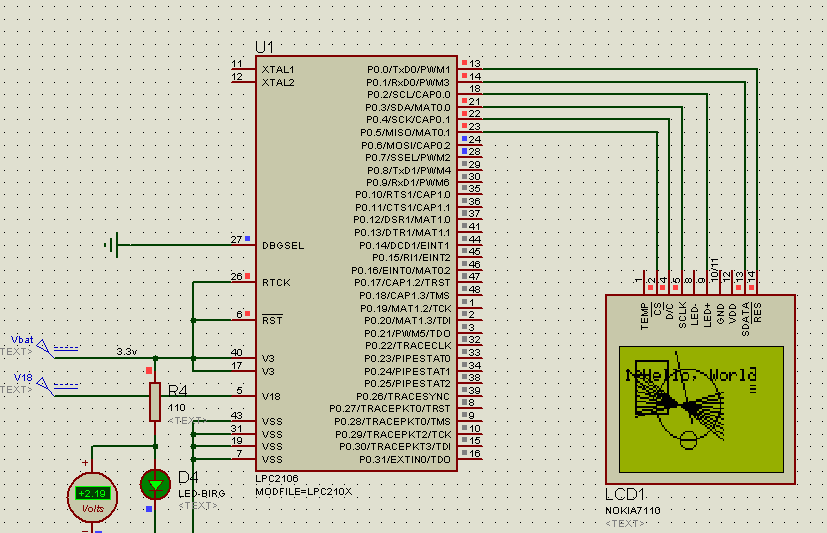

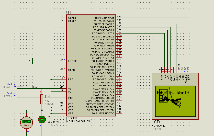

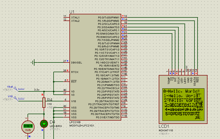

Graphic LCD 96x64 w/ SED1565 Controller
here is what I have for a true glcd presentation. the program starts with drawing pixels, then characters, and then strings. so it is more portable but will not be as fast.
it uses DirtyLube's idea of using a video ram. it can address 132x65 pixels so it can be used with other sed1565-based glcd.
no fancy graphics function yet.
I still need to fix the right columns, through.

int main(void)
   mcu_init();
   lcd_init();
	while (1) {
//		lcd_chr('c');
//		lcd_chr('b');
		lcd_str(00, 18, "0-Hello, World!", NORMAL);
		lcd_str(10, 19, "1-Hello, World!", NORMAL);
		lcd_str(25, 20, "2-hello, world!", OVERLINE);
		lcd_str(30, 21, "3-ABCDEFGHIJKLMN", UNDERLINE);
		lcd_str(40, 22, "4-abcdefghijklmn", STRIKE);
		lcd_str(50, 23, "5-OPQRSTUVWXYZ", OVERLINE | STRIKE);
//		lcd_gotoxy(8,0);
//		lcd_str("0-HELLO, WORLD!", NORMAL);

I am working on the actual drawing functions - need to figure out a way to do it without using floating point routines.
the way I did it is quite portable but at the expense of speed / performance. it sounds like DirtyLube did it differently and I would love to see how.
now, the line function, lcd_setline() is here. It was based on Jim Lynch's work for 6100 which itself is based on Jack Bresenham's line algorithm. it works beautifully, :).
the code is here:
           draw a line between two points
					 code shamelessly stolen from Jim Lynch's 6100 driver
void lcd_setline(char x0, char y0, char x1, char y1) {
	int dy = y1 - y0;
	int dx = x1 - x0;
	int stepx, stepy;
	if (dy < 0) { dy = -dy; stepy = -1; } else { stepy = 1; }
	if (dx < 0) { dx = -dx; stepx = -1; } else { stepx = 1; }
	dy <<= 1; // dy is now 2*dy
	dx <<= 1; // dx is now 2*dx
	lcd_setpixel(x0, y0);
	if (dx > dy) {
		int fraction = dy - (dx >> 1); // same as 2*dy - dx
		while (x0 != x1) {
			if (fraction >= 0) {
				y0 += stepy;
				fraction -= dx; // same as fraction -= 2*dx
			x0 += stepx;
			fraction += dy; // same as fraction -= 2*dy
	} else {
		int fraction = dx - (dy >> 1);
		while (y0 != y1) {
				x0 += stepx;
				fraction -= dy;
			y0 += stepy;
			fraction += dx;
now, I have added the circle function: lcd_setcircle().
           draw a circle between two points
void lcd_setcircle(char x0, char y0, char radius) {
	int f = 1 - radius;
	int ddF_x = 0;
	int ddF_y = -2 * radius;
	int x = 0;
	int y = radius;
	lcd_setpixel(x0, y0 + radius);
	lcd_setpixel(x0, y0 - radius);
	lcd_setpixel(x0 + radius, y0);
	lcd_setpixel(x0 - radius, y0);
	while(x < y) {
		if(f >= 0) {
			y--;
			ddF_y += 2;
			f += ddF_y;
		x++;
		ddF_x += 2;
		f += ddF_x + 1;
		lcd_setpixel(x0 + x, y0 + y);
		lcd_setpixel(x0 - x, y0 + y);
		lcd_setpixel(x0 + x, y0 - y);
		lcd_setpixel(x0 - x, y0 - y);
		lcd_setpixel(x0 + y, y0 + x);
		lcd_setpixel(x0 - y, y0 + x);
		lcd_setpixel(x0 + y, y0 - x);
		lcd_setpixel(x0 - y, y0 - x);
how do you call it? Whats top, left, x,y ?
x0 = ?
x1 = ?
y0 = ?
y1 = ?
the upper left is (0,0), the lower right is (64, 132).
however, the first and the last 18 columns in the Nokia screen don't show. so you will have to remember that.
I did it that way so the program can be easily ported to other true SED1565 displays.
