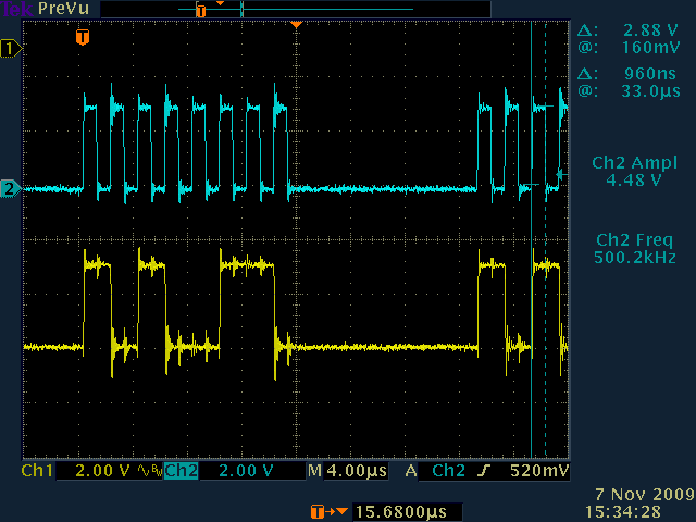

So all I need to do now is figure out why my code is failing. Mine is written quite different to yours because I'm using the internal SSP module. I'm betting that it'll be some quirk in the way I've set up the SSP module to communicate that's causing the problem. I know that my code sends out the correct data because I've checked it on my DSO, but perhaps there's a problem with the way the normal logic level for the clock is set (high or low), or whether the data is sent on the rising or falling edge, or some silly setting like that.
I'm now going to capture the data sent when I load your code, and compare it to the data sent when I load my code.
Back later!
Brian
My code is now working :)
I analysed the difference between the data captured with your working code and my failing code and I saw that although both our software was set up for data to be clocked on a rising edge, yours was set to normally high data & clock lines, where as mine was set to normally low!
See pictures. The data between the two systems is the same (the capture shows the first command, A6, being sent) but my lines are active low. Doh!
This was easily fixed with a simple bit change in the SSPCON register. After that all is well with my code.
