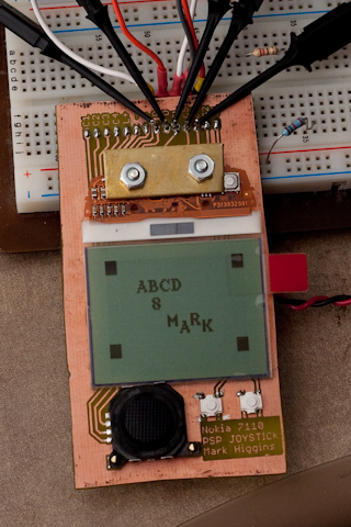

So I kinda got sidetracked on this thing. I made up a PCB last weekend and yesterday and today I decided to really have a go at making up a library with a screen buffer. I was really surprised to get it working so quickly. The logic for writing the characters to the buffer wasn't all that clear in my head, but it ended up working right away, which is a nice change.
So currently I can write text characters at any pixel location I want on the screen, but that's it for now. I'll have to make up a 'set pixel' function, then adapt some circle and line functions for some graphics. I'd also like to make the text smooth scroll, which would be useful.
The library currently refreshes any row that has changed, so it doesn't redraw the whole screen each time pixels are set. I'd like to implement some code that knows exactly what rows/columns have changed, but that would up the complexity and this thing can handle data coming in pretty quick. I have no delays in my clock/write code and it takes it fine.
I hate to do this, but I'll post the code when I've got more done. Right now, I was just excited to get it working without much hassle.
I stole one of the 8x8 fonts from Atom's original code, as the other display fonts I have write the character data from a different direction.

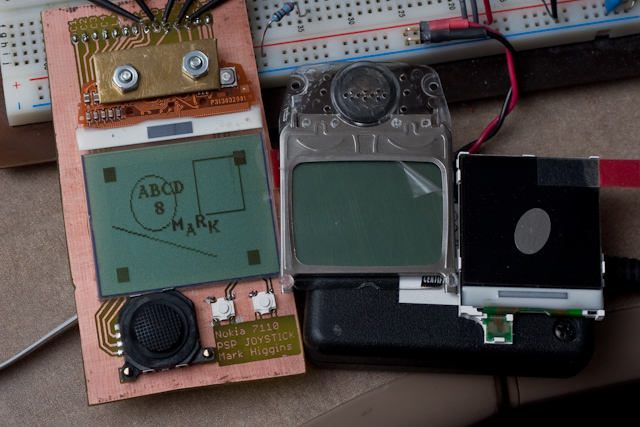

Well, that wasn't that hard. First I had the setpixel function moving the set bit the wrong way, so my circle was four arcs with ends pointing away from the centre.
EDIT: The character in the centre of the circle looks a little mauled, because it was changing as I took the picture. I had that character counting through numbers.

I added the rectangle and line functions. I'll spare you another picture.
why? i love pictures dude.... can you PM me the eagle part or post it here plz... i would love it. I plan on at least making something like a PC temp keeper with these smaller LCDs and would love a part to make a PCB
Last pic for comparison.
Nokia 7110, Nokia 3310, and Nokia 6100.

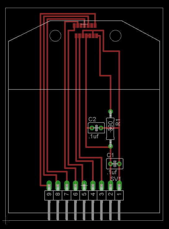

Look at this board i will make nice and simple . The header at the bottom will be a 90 degree female. Less chance of damage using it.
