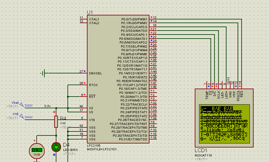

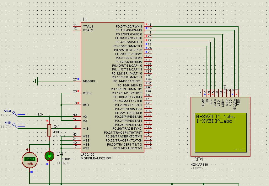

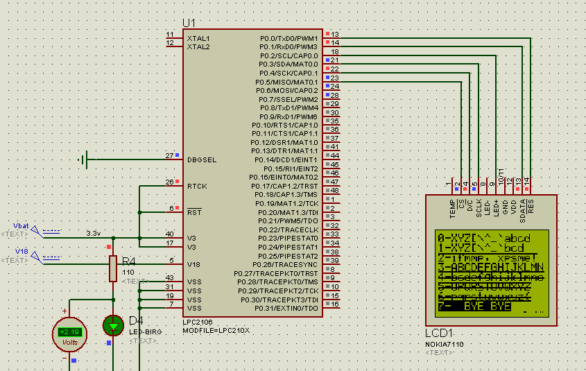

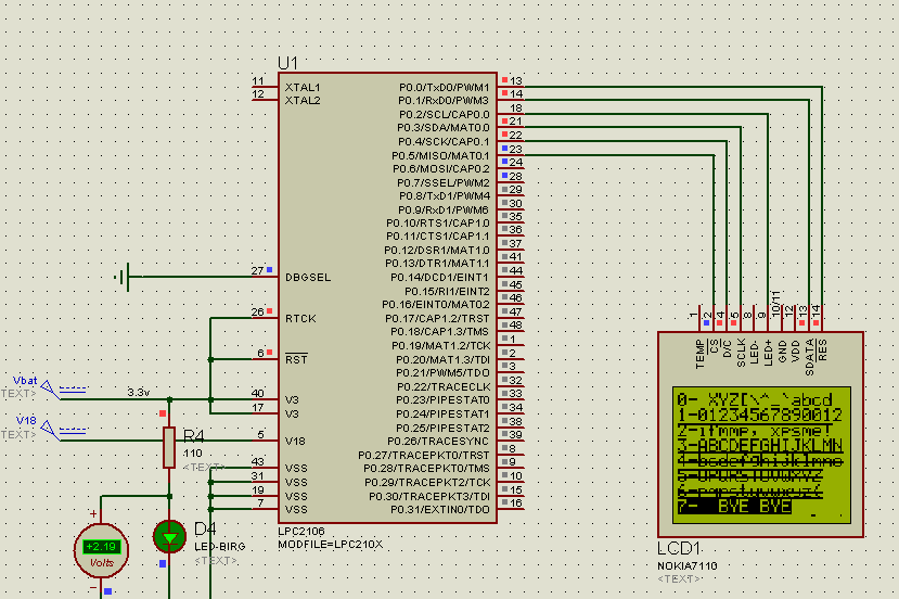

here goes the code
//#include <htc.h>
//#include "delay.h"
#include <LPC210x.h>
//#include "always.h"
#define GETBIT(var,bit) (((var)>>(bit))&1) 			/* read bit from var */
#define SETBIT(var,bit) ((var)|=(1L<<(bit)))		/* set bit from var to 1 */
#define CLRBIT(var,bit) ((var)&=(~(1L<<(bit))))		/* clear bit from var (set it to 0) */
#define uint unsigned int
#define byte unsigned char
//#define delay_ms() DelayMs()
// Description : This firmware for Nokia 7110 (SED1565 controller) 96*65 TEST  //
// Hardware : PIC16F875 , LCD NOKIA7110                                        //
// Firmware : Rev 0.1                                                          //
// Date : 6/14/2009                                                           //
// by : Hello world                                                            //
// Compiler : PICC-Lite 9.6L1 / TIDE                                                                  //

               sent 8 bit data to LCD by series
void lcd_write_dorc(char byteforlcd) { // same lcdai 3310
  char caa;
   for (caa=8;caa>0;caa--)
      IOCLR=1<<lcd_sclk;	//data sent on the rising edge of sclk line
      DelayUs(2);
      if ((byteforlcd&0x80)==0)	// tramission starts from D7, D6, .., D1, D0. if D7 is 0, send 0.
         {IOCLR=1<<lcd_sda;}
      else
         {IOSET=1<<lcd_sda;}
      IOSET=1<<lcd_sclk;	//clock out the data
      byteforlcd=byteforlcd<<1;	//shift left the next bit.
              Sent Command to LCD Function
void lcd_write_command(char byteforlcd_command) {
   IOCLR=1<<lcd_dc;   // dc=0 signals lcd command mode. A0 in the datasheet. dc=data or command.
   IOCLR=1<<lcd_cs;   // chip enabled, negative logic. _cs
   lcd_write_dorc(byteforlcd_command);	//send the command.
   IOSET=1<<lcd_cs;   // chip disabled
               Sent Data to LCD Function
void lcd_write_data(char byteforlcd_data) {
   IOSET=1<<lcd_dc;   // display data mode. A0 in the datasheet. dorc=data or command.
   lcd_write_dorc(byteforlcd_data);	//send the data.
               goto xy position on LCD Function
void lcd_gotoxy(char lcd_row, char lcd_col) {	//lcy_row: 0 - 8 (8th column has only 1 line / D0, lcd_col: 0 - 15.
   char col_addr;
   lcd_write_command(0xB0 + lcd_row);       	// page address set. pg 8-48 in the datasheet.
   col_addr = lcd_1st_col+(lcd_col*6);					// each font has five columns + 1 blank column. xaddr: 0 - 95 on nokia 7110. no offset.
	 //lcd_1st_col=0x12: the first column of display starts here. Weird! the datasheet didn't mention it.
   lcd_write_command(0x10 | (col_addr>>4));        // column address 4 most bit set
   lcd_write_command(0x0f & col_addr);             // column address 4 least bit set
           Convert bitmap to charractor Function
void lcd_chr(char charsel, char attribute) {
	char char_row, char_data;
	int char_pos;
   if (charsel < 0x20) return;
   if (charsel > 0x7f) return;	//check for illegal characters
   for (char_row = 0; char_row < 5; char_row++) // 5 bytes
         char_pos=charsel-0x20;
         char_data=Char_Table[char_pos*5+char_row];
//         lcd_write_data(~char_data);            // send font data to lcd, white char on black background
				 	if(attribute == REVERSE)
					else
						lcd_write_data(char_data | attribute);
//   lcd_write_data(~0x00); // blank side pixels for each font, white char on black background
	 	if (attribute == REVERSE)
		else
			lcd_write_data(0x00 | attribute); // blank side pixels for each font
           Write a string at current screen position
void lcd_str(const char *str, char attribute) {
  while (*str)
		lcd_chr(*str++, attribute);
  delay routines
void DelayUs(int us) {
	for (; us>0; us--);
void DelayMs(int ms) {
	for (; ms>0; ms--)
		DelayUs(1000);
void mcu_init(void) {
// need to initialize the mcu here.
	PINSEL0=0x00;
	IODIR=0xff;		//pin p0.0..p0.7 used for gpio.
                  Main Progarm
int main(void)
   mcu_init();
   lcd_init();
	while (1) {
		lcd_gotoxy(0,0);
//		lcd_chr('c');
//		lcd_chr('b');
   	lcd_str("0-HELLO, WORLD!", NORMAL);
		lcd_gotoxy(1,0);
		lcd_str("1-01234567890012", NORMAL);
		lcd_gotoxy(2,0);
		lcd_str("2-hello, world!", OVERLINE);
		lcd_gotoxy(3,0);
		lcd_str("3-ABCDEFGHIJKLMN", UNDERLINE);
		lcd_gotoxy(4,0);
		lcd_str("4-abcdefghijklmn", STRIKE);
		lcd_gotoxy(5,0);
		lcd_str("5-OPQRSTUVWXYZ", OVERLINE | STRIKE);
		lcd_gotoxy(6,0);
		lcd_str("6-opqrstuvwxyz", UNDERLINE | STRIKE);
		lcd_gotoxy(7,0);
		lcd_str("7-  BYE BYE", STRIKE | OVERLINE | UNDERLINE | REVERSE);

if I change the code to
lcd_str("XYZ[\\]^_`abc", NORMAL);
note the "\\" because "\" is the escape sequence in C.
the output is perfectly normal.
oh and for the extra bits that appear in bottom left try clearing the screen before first write.

the dots at the bottom of the screen has something to do with the 7110 model in proteus, I suspect.
If I turn comm to normal, in lcd_init():
lcd_write_command(comm_reverse); // (15) common output normal (0xC8 reverse)
I get a flipped but otherwise fine screen.

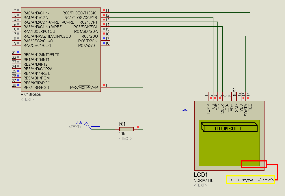

now you see it; now you don't, :)
here is how to make the 'a' disappear, :).
		lcd_gotoxy(0,0);
   	lcd_str("0-XYZ[\\]^_`abc", NORMAL);
		lcd_gotoxy(1,0);
		lcd_str("1-XYZ[\\]^_abc", NORMAL);
try removing some of the comments from the font
                  0x00,0x41,0x41,0x7f,0x00,  // 5d ]
                  0x04,0x02,0x01,0x02,0x04,
                  0x40,0x40,0x40,0x40,0x40,
                  0x00,0x01,0x02,0x04,0x00,
                  0x20,0x54,0x54,0x54,0x78,  // 61 a
Im not sure why you get this issue. I have comments also but no issue like this. would it be possible for you to post the proteus model and stuff so i can check it here?
sure. see attached.
eliminating the comments made no difference. also, have you noticed that the char ']' was not displaced at all?
  • Nokia 7110.zip
Jason, your instinct was right. I used lcd_chr() to trace the problem back to char 5c, '\', which is a control char for c. I rewrote that line from:
0x02,0x04,0x08,0x10,0x20,  // 5c \
to
0x02,0x04,0x08,0x10,0x20,  // 5c 55
and everything is golden!
thank you so much for your help.
