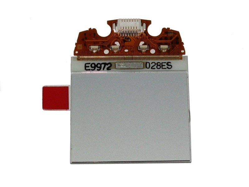

Where's the IC for the display? You never posted a picture of the other side of the board.
Heh here is the back:

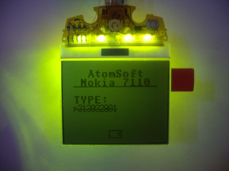

I made altered the text function to underline and strike through text. Of course you can do both at the same time if you wish :D
Here is the code... also it can now take different font sizes. I have 2-8x8 fonts and 1-5x7 font.

Here it how it looks:

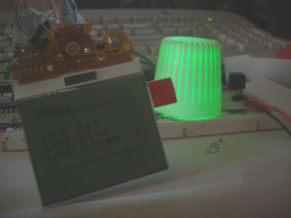

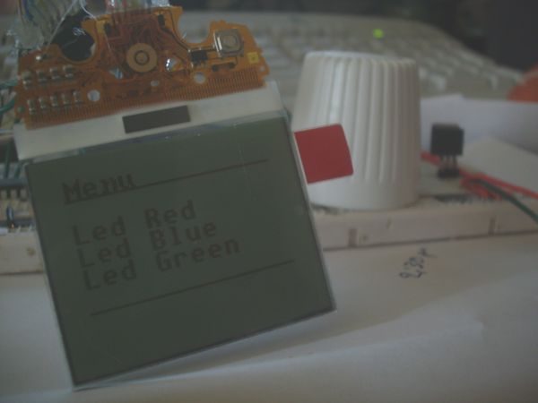

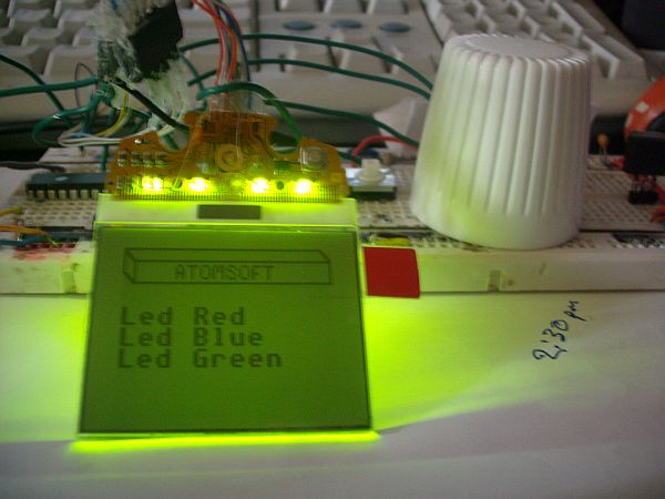

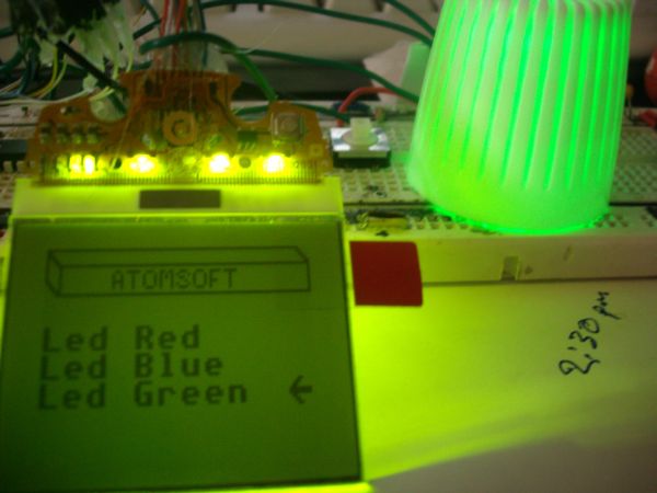

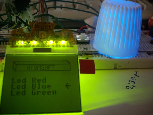

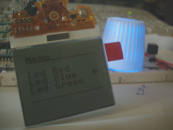

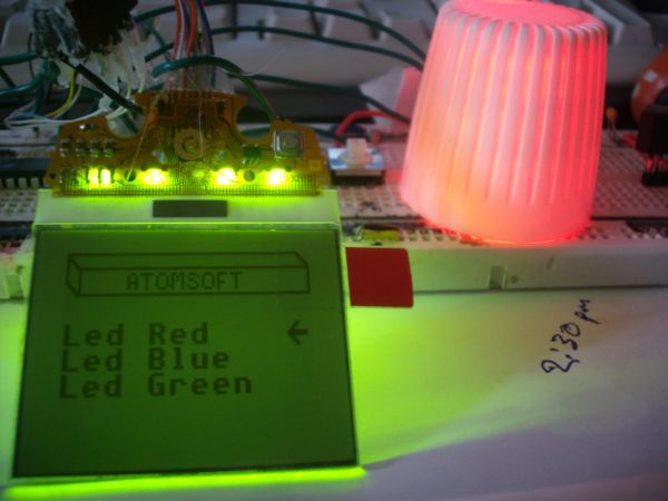

Just noticed pictures wont show my LED Color. So i took off the flash lol and here ya go from left to right is Menu items 0-3:
