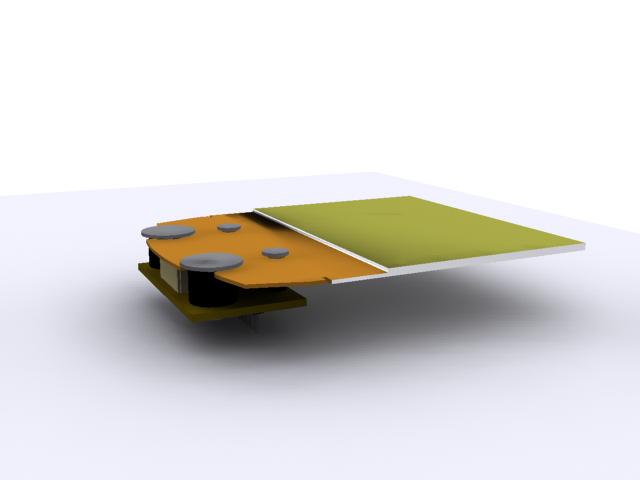

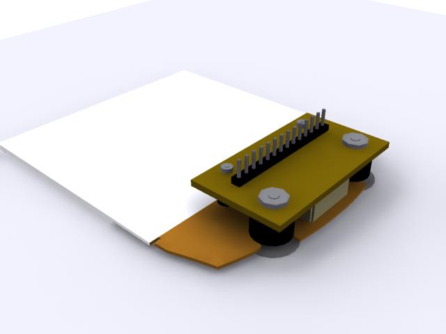

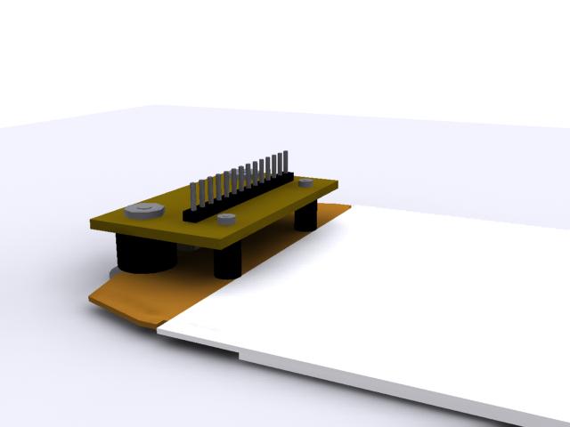

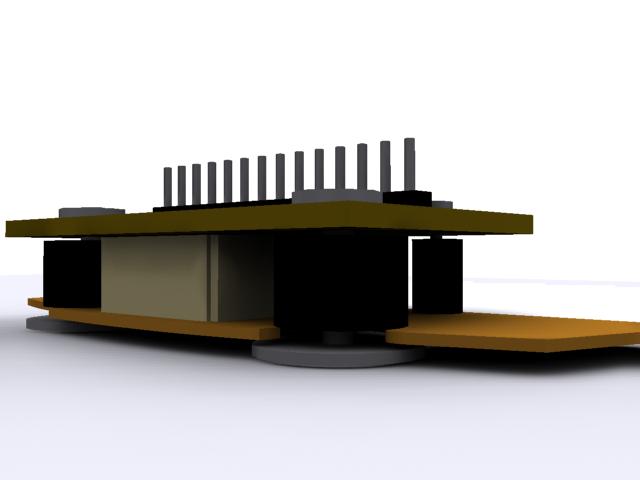

Graphic LCD 96x64 w/ SED1565 Controller
This is a extremely rough draft. Im waiting for
Autodesk Inventor Trial to come in. i know it will be way better to play with that.

The space between pins is 1mm.
The space bewteen rows is 3mm.
The 2 rows are staggered on centers.
The contacts protrude less than 1mm.
Since the sides of the connector are open, I'm thinking there might be fingers on the phone which clamp like those old DIP test headers.
Somebody needs to take apart an old phone and see how it's done. :)
--David
Well this probably means I will also have to make the connector myself or even solder some wires to the LCD adaptor.
Thanks guys.
Geraldes
If i can make a adapter and have it produced (1 PCB and some screws and spacers) then i would see if the head of dipmicro would like the plans and he would include it with LCD sales for a small price increase.
Its cheap as it is a small increase wouldnt hurt the wallet :D

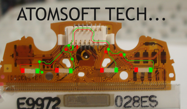

was bored so make a trace of LED lol i might trace most of the board. Maybe it would be useful ?
ledtrace-png.29700
EDIT: Just finished making it brighter red to see clearer :D also now a PNG

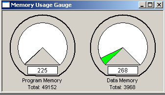

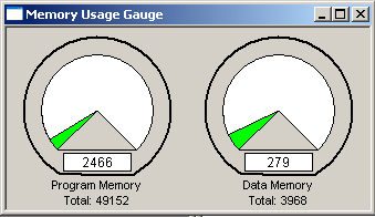

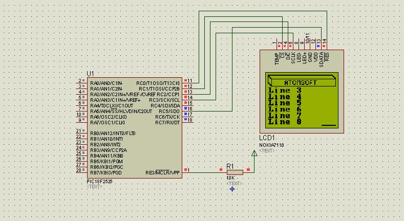

Well here it is the library. I will post the code here and a zip file.
#include <p18f2525.h>
#include "nokia7110.h"
#pragma config WDT = OFF, LVP = OFF, OSC = INTIO67, XINST = OFF
unsigned rom char banner[194] = { 96, 16,
 255,  7,  13,  25,  49,  225,  33,  33,  33,  33,  33,  33,  33,  33,  33,  33,  33,  33,  33,  33,  33,  33,  33,  33,  33,  161,  161,  33,  33,  161,  161,  161,  161,  161,  33,  33,  161,  161,  161,  33,  33,  161,  161,  33,  161,  161,  33,  33,  161,  161,  161,  33,  33,  33,  161,  161,  161,  33,  33,  161,  161,  161,  161,  33,  161,  161,  161,  161,  161,  33,  33,  33,  33,  33,  33,  33,  33,  33,  33,  33,  33,  33,  33,  33,  33,  33,  33,  33,  33,  33,  33,  35,  38,  44,  56,  240,
 7,  12,  24,  48,  96,  127,  64,  64,  64,  64,  64,  64,  64,  64,  64,  64,  64,  64,  64,  64,  64,  64,  64,  64,  95,  68,  68,  95,  64,  64,  64,  95,  64,  64,  64,  79,  80,  80,  80,  79,  64,  95,  64,  67,  64,  95,  64,  73,  82,  82,  84,  73,  64,  79,  80,  80,  80,  79,  64,  95,  68,  68,  64,  64,  64,  64,  95,  64,  64,  64,  64,  64,  64,  64,  64,  64,  64,  64,  64,  64,  64,  64,  64,  64,  64,  64,  64,  64,  64,  64,  64,  64,  64,  64,  64,  127
void main(void);
void main(void){
	OSCCON = 0x72;      		//8MHz clock
	while(!OSCCONbits.IOFS);	//Wait for osc stable
	LCD_Init();					//Initialize the LCD
	CLS();						//Clear the LCD
	LCDImage(banner,0,0);		//This image takes line 1 & 2 since its 16 Pixels Height
	LCDString((rom unsigned char*)"Line 3",0,0,0,2,0);
	LCDString((rom unsigned char*)"Line 4",0,0,0,3,0);
	LCDString((rom unsigned char*)"Line 5",0,0,0,4,0);
	LCDString((rom unsigned char*)"Line 6",0,0,0,5,0);
	LCDString((rom unsigned char*)"Line 7",0,0,0,6,0);
	LCDString((rom unsigned char*)"Line 8",0,0,0,7,0);
	while(1){

And in Proteus for those for those too lazy to breadboard :)
I see the schematic calls for a 18f2525, shouldn't it be a 18LF2525 to use 3.3v ?, or can you use 3.3v on the 18f2525
• Wide Operating Voltage Range: 2.0V to 5.5V

In your experience what is the average consumption of the LCD module with and without the backlighting? When there is 10%, 25%, 50%, 75%, 100% pixels turned on? Further, how is the readability without the backlight turned on? One more question, what it the library overhead for the PIC18 family?
This is a nice alternative to 16x2 HD47780 modules. Except for the awkward connector, still it should be suitable for those one-off projects.
Ill find out later on today. Ill do some test to see how much current the LCD takes. The LCD without backlight is readable perfectly in normal daylight. In the dark it needs the backlight.
The below usage shows the whole usage with only 1 string being called from main. The size is in Bytes.
bytes-png.29740
Now this is the same with no LCD stuff on the form at all or in project.
byes2-png.29741
So it takes:
11 Bytes of Data Memory
2241 Bytes of Program Memory.
All in all i say its not to large. Takes around: 4.6% of the space so you still have 95.4% of your Program Memory.
And then for the 11 Bytes:
.3% of Data Memory is used.
I've prepared some inventor squetches for a PCB connector adaptor.
There are two ways of ataching the connector to the PCB:
note 1: Using just the insert that connects to the PCB via two screws.
note 2: If the attachment above doesn't guarantee the connection then use a clamp that will force the LCD connector against the PCB copper pads.
I attach some figs.

I need some specific details on the connect on LCD to do that image. Like i need a Caliper to measure it. Im going to order one today. So i can have for future projects also.
A nice digital Caliper.
Rather then do anything fancy I am going to try to make a PCB that solders to the pins. It should work if the pin diameters are not too large. Have it convert to a standard 2 row pin header.
