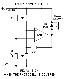

Sorry, i have no circuit for this specific photocel, instead you may benefet of this circuit ( got some where on web )
hi aljamri,:)
The problem is the OP wants to use a 6Vbty, I suspect he wants to keep the current drain to a minimum.
Driving a relay would put an extra burden on the battery.
