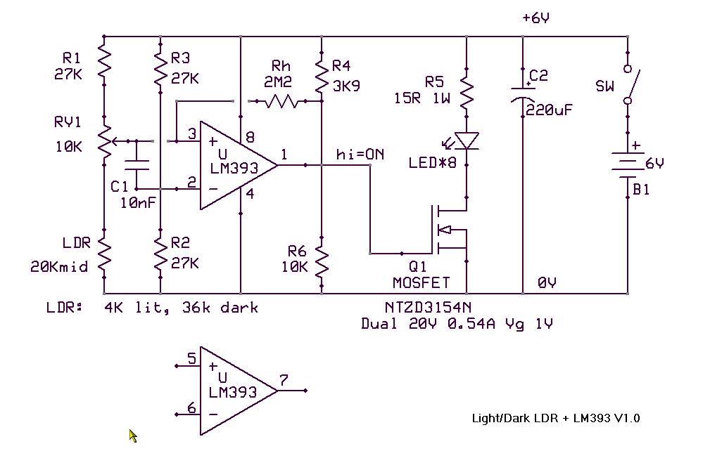

Garden lights circuit will this work
I would like to light 6 leds at the most 8.

hi jake,
Look at this circuit.
As the LM393 and the MOSFET are both dual devices, you could make two LED lights.
Let me know the results ofthe LED voltage tests.:)

Did you see the circuit I posted, with those dual IC's and the dual MOSFET you could have two garden lights,
master and slave.
Do you follow the circuit OK.?:)

I've used the cd cells in that Radio Shack package for dozens of circuits and experiments. There are three sizes represented in the package. Only the middle sized works with any dependability. However, I have used it with any number of different circuits, including exactly the one you posted. Use an NPN transistor, (2N2222 is ideal) with at least a 1K ohm resistor paired with the CD cell in the voltage divider.
I do not think you will have much success, however, trying to drive as many as eight LEDs off just one circuit. With five volts Vcc, as an example, I can only get two red or green LEDs to work as designed in series with a suitable current-limiting resistor.

The LM393 is a very common device.
That FET is less than £0.5GBP in the UK.
If you have trouble with the MOSFET, any type will do that has the following.
At least 0.4A current, operating voltage at least 12V, Gate turn ON voltage of 1V+

BTW just to double check, that circuit is working on my project board.
