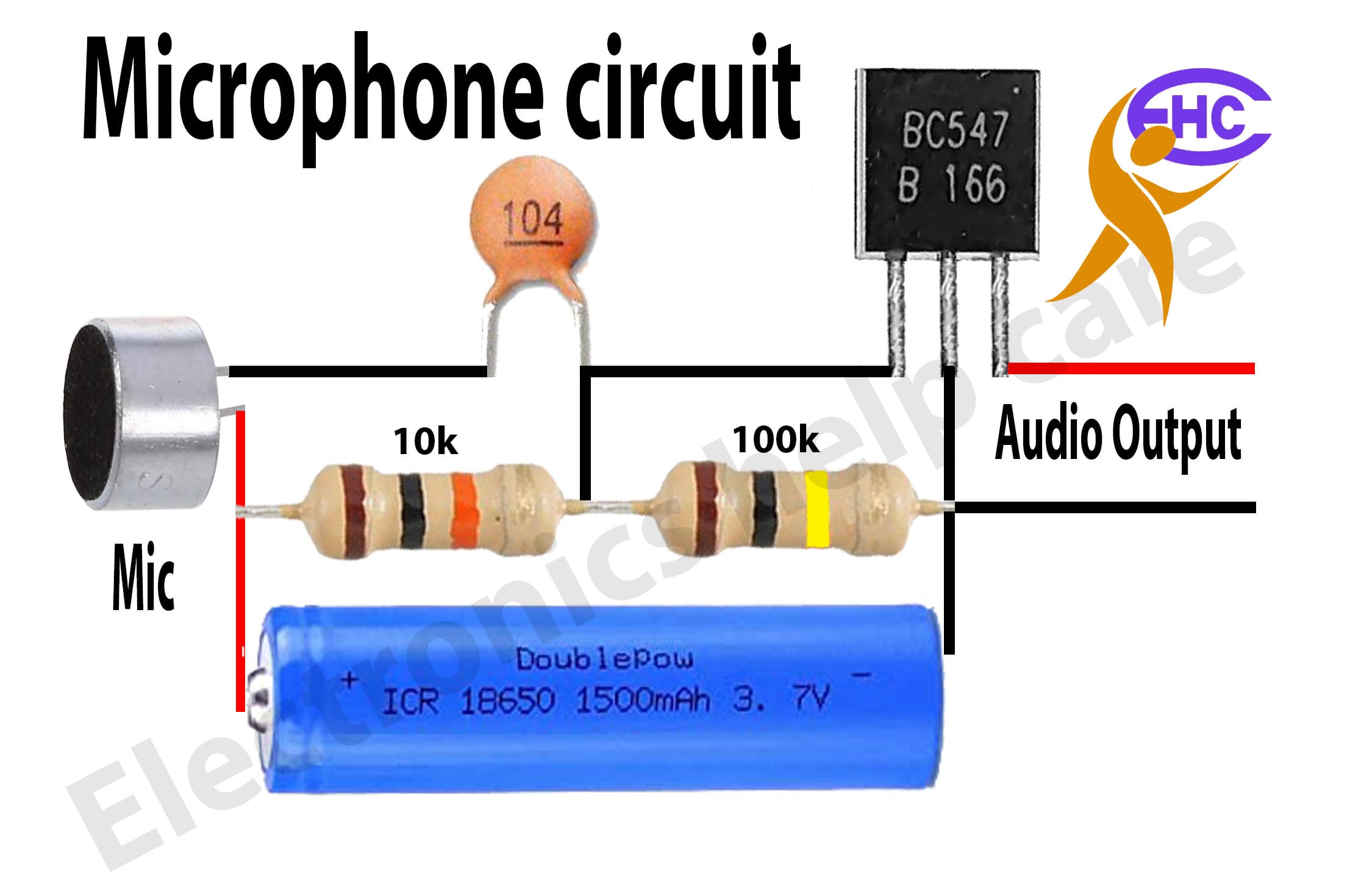

Can i make a circuit (like a megaphone)
I tried two designs but didn't work
The components I used were
The mic ,a 0.5 watt speaker ,a BC 547(bc547C V1 E) transistor, a 10k and 100k resistor, a 104 ceramic capacitor and a 3.7v battery.

That is a strange configuration for a mic preamp. Please post a link to the original circuit.
An electret microphone cartridge requires a DC bias current through it. Because your circuit has one end of the mic connected directly to a capacitor and nothing else, there cannot be a DC path through the mic.
No matter how many transistor connections you try, the circuit will not work.

If there's just a silly picture, and no actual circuit (as in this case), it's a pretty good indication that the author doesn't have the slightest clue what he's doing, and it's never going to work.
You can't feed a speaker from a single small transistor fed from a microphone.
If you want a proper working electret mike preamp, refer to the opamp version on these forums here:
You would then need a power amplifier to feed a speaker.
As an electret mike is omnidirectional, it's probably a poor choice for a megaphone anyway.

The mic preamp circuit you found is completely wrong.
A preamp drives a power amplifier that drives a speaker.
Here is a simple mic preamp circuit wired correctly:

This is a prime example of web “how-to” circuits, which the author clearly did not ever built or tested.
Nor would he understand why it doesn’t work, either.
