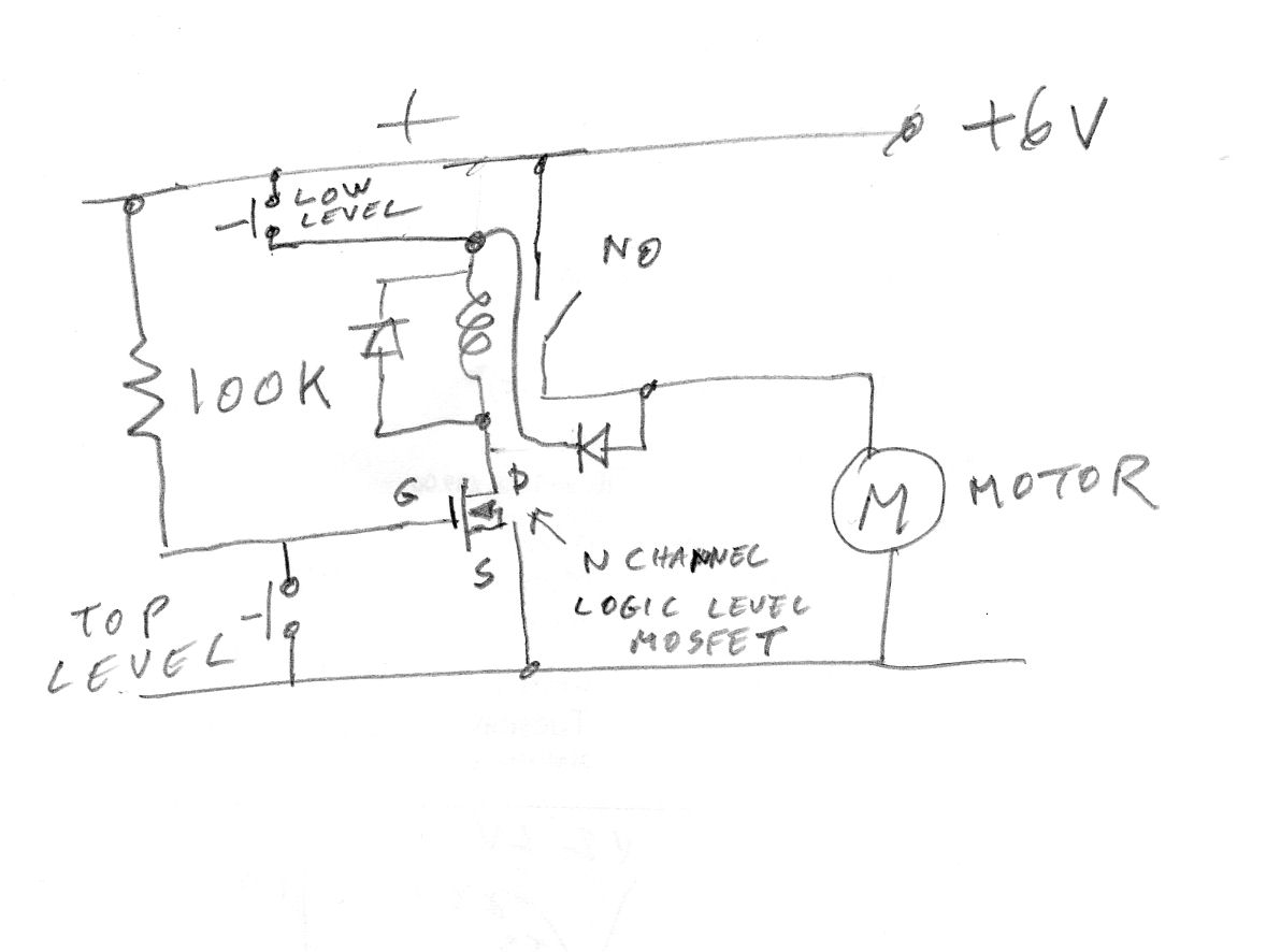

I would do it something like this.

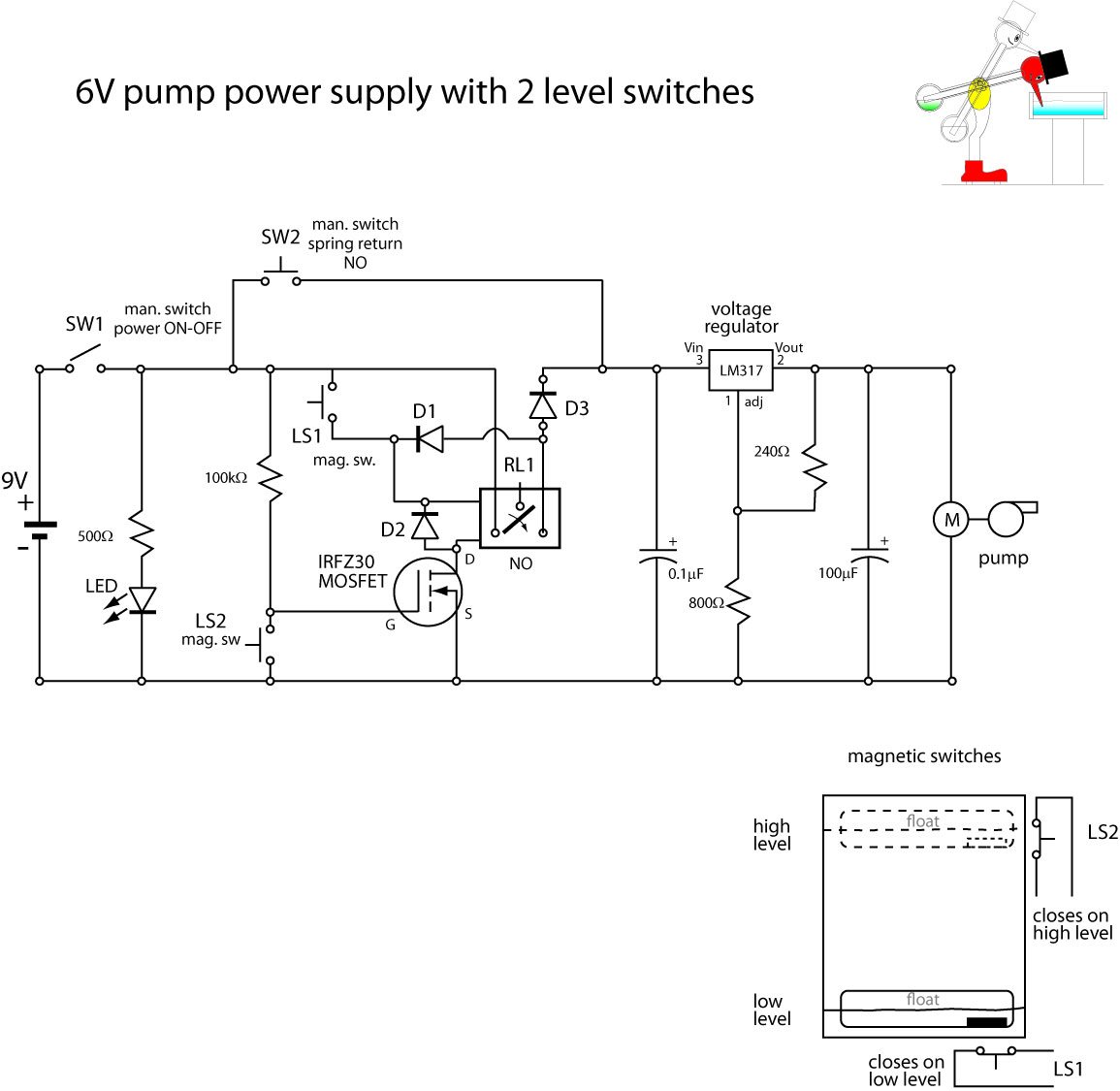

I would recomend runing this circuit straight from the battery and putting the regulator between this switching circuit and the motor. That way you will not have the cuurent taken by the regulator draining the battery all of the time. Almost any logic level N channel mosfet should work.

Les, thanks for the sketch. Can you walk me through it step by step, what happens when the low level switch kicks in, and then when the high level kicks in. I'm a bit too new at this to catch the intricacies. Above the mosfet I see a coil and a diode, is that coil an inductance and what is its purpose. Also there is a NO contact shown, is that part of a relay and if so what energizes the relay?
When the low level switch closes it will connect +6V to the top of the relay. As the mosfet will be switched on at this time by the +6V to the gate via the 100K resistor the relay will pull in and it's contacts will close. this will connect +6V via the diode to the top of the relay which will hold it in when the low level switch opens again. The relay contact also connects +6 volts to the motor. The diode is so that the reed switch does not try to directly power the motor when it first closes. When the top level switch closes it shorts the gate and source of the mosfet which switches it off. this causes the relay to drop out. During the time that the top level switch is closed the circuit will be drawing 60 uA. If the circuit was modified so the top of the 100K resistor was connected to the top of the realy coil instead of the +6 volts rail the circuit would draw no current except when the pump was running.

Ah, very ingenious. Thanks

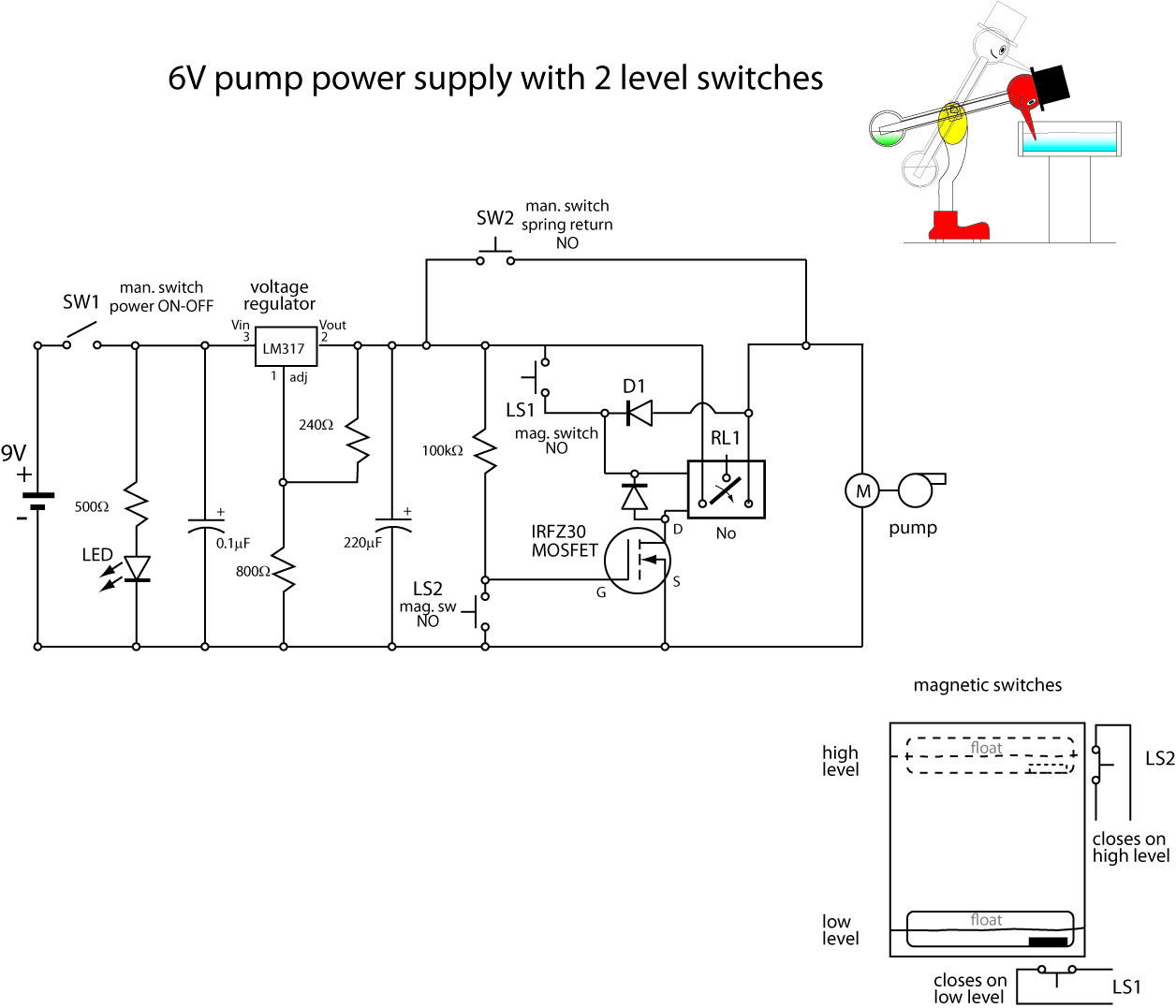

Les, I like the idea of putting the regulator between the switching and the motor but I don't think I can get the manual switch to work in that configuration. I'm going to test this shortly.

With your circuit in post #85 the manual switch will not work as yoy want it to. When pressed it will set the latching circuit on and it will remain on until the top level switch closes. You need to add a diode (1N400x series.) between the negative end of and the junction of the motor and manual botton. The negative end to D1. There is no reason why moving the regulator and it's support components to between the switching circuit and the motor should not work. You could also reduce the value of the 220 uF capacitor if you want to. Also I think from memory that the 0.1 uF capacitor should be larger. CHECK WITH THE DATA SHEET.

How's this?

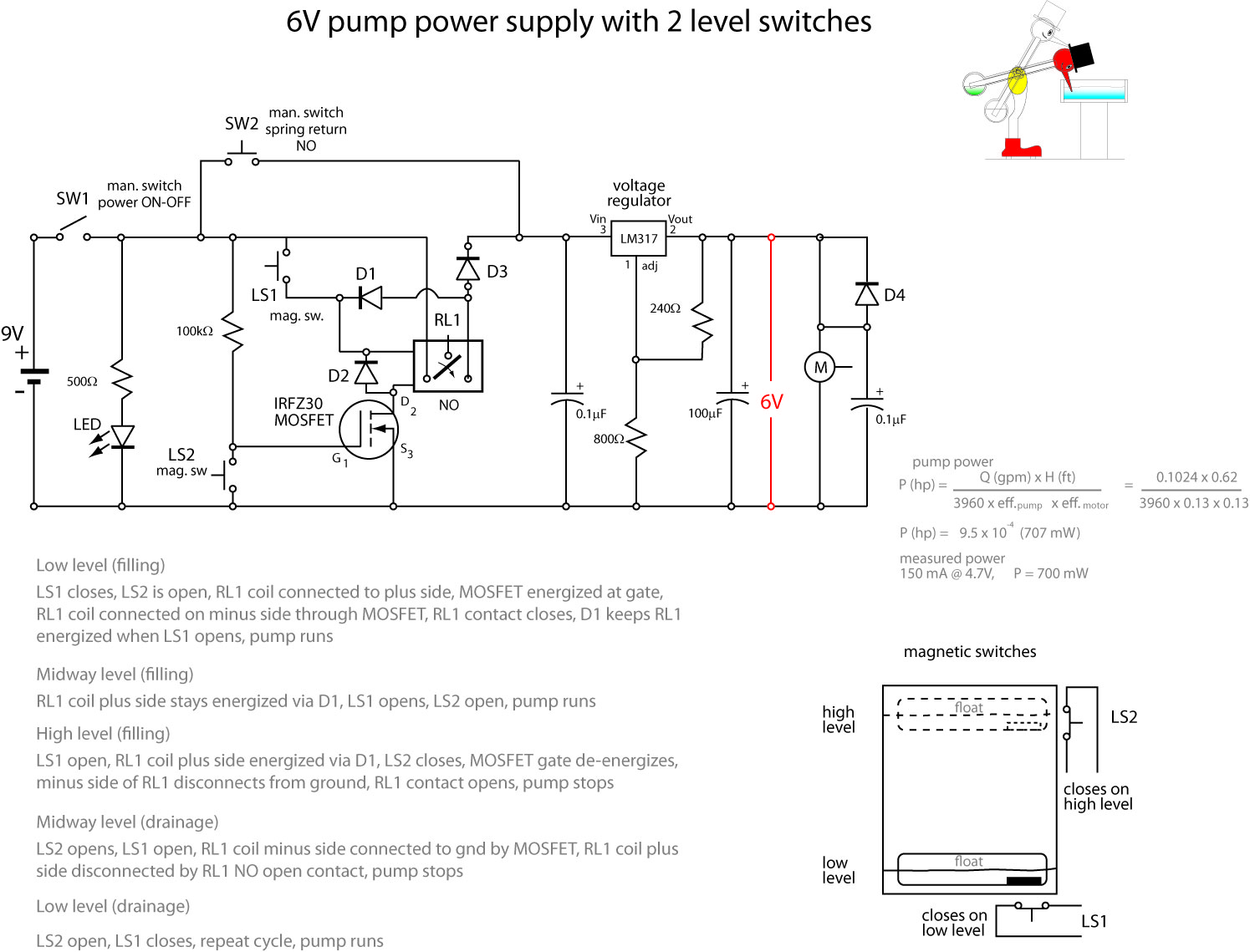

I've described my understanding of the logic just to make sure I wasn't missing anything.

You description fits the way I designed it. All you need to now is to build it to make sure that I have not overlooked anything.

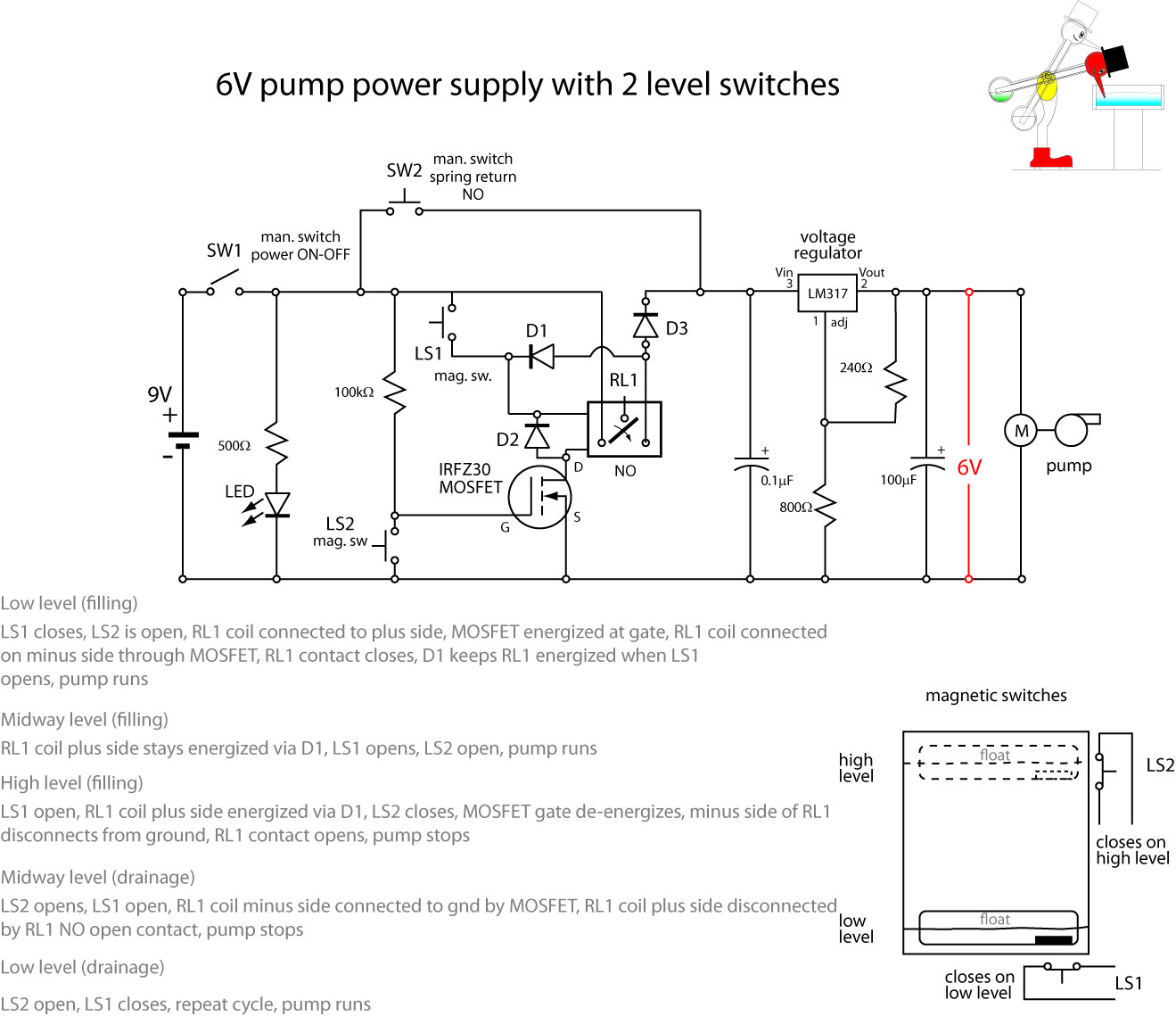

Les, the switching works fine, however the man. switch is affecting the mosfet starting the switching cycle; it's a recurring theme. I tried putting a diode/capacitor around the motor, no help. I tried a 220 microF cap. after the regulator, no help.

Try adding a capacitor (say 100nF - 1uF) between the gate and source of the FET.

Sorry, I have some wiring issues around the relay, I'm checking it out.
Les, it works, lovely, switching is good, man. switch works as expected. I had the body of the relay in reverse, lot's of connections he he. I'm going to let it cycle for a few hours to see what the battery life is like.
Les, thanks very much for your help and everyone else on the forum for you input.

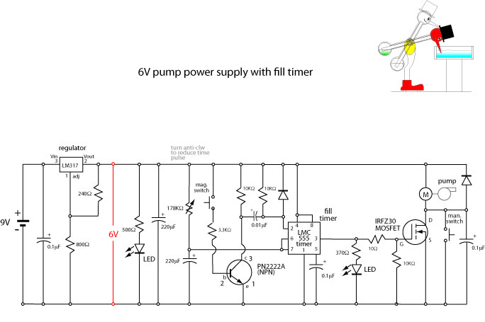

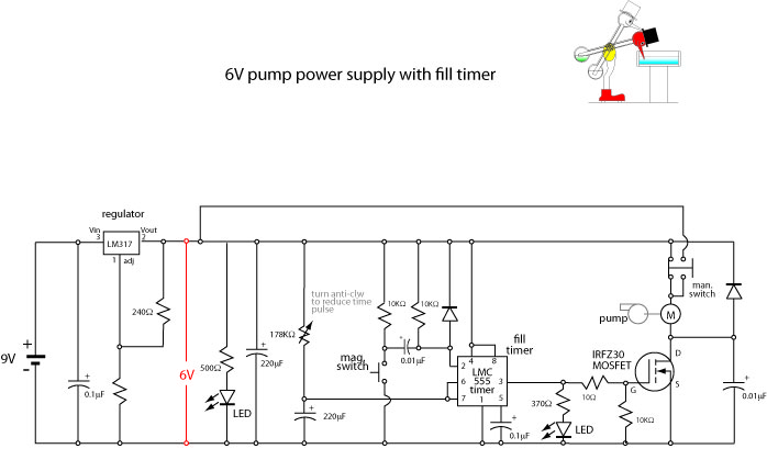

Well! As my prototype advances I have realized the that 2 level switch system will not work.
Two level switch system
As the water evaporates there will be insufficient water in the bottom reservoir to fill the top reservoir to the point where the top-level switch turns the pump off. The pump will keep pumping until the battery is dead.
Single switch (bottom) level switch system
The single level switch system operates on a timer. When the bottom level switch is activated the pump starts and stops after a certain time, approximately 24 seconds. As the water evaporates the total amount of water in the system will decrease. The top reservoir will only be partially filled as at one point the pump starts sucking air. At which time more water has to be added.
The single level switch system was working except that the manual switch was triggering the timer, a situation for which I could not find a solution until now, possibly.
I have attached the schematic that was working with the timer but had the problem manual switch and another with my solution. The solution depends on whether a small multi-contact switch is available which is a big if I think. But maybe there is a better way...
Jacques

Woops, no this won't work, the MOSFET has to be activated. I think I just need to move the switch across the MOSFET
