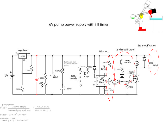

I don't know where post #9 is or I would look it up. Here a revised schematic with your pin 4 recommendation.

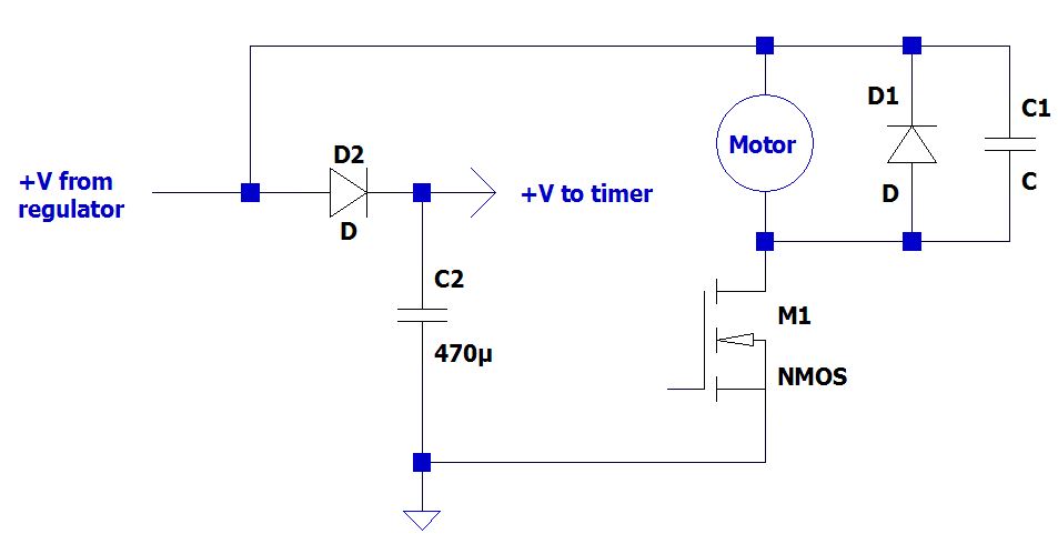

You could try decoupling the +ve supply to the timer, like this :
D2,C2 hold the voltage up when the motor start-up current tries to drag it down.

Just tried the cap. on pin 4 , no help.
1) Disconnect pin 4 from anything else like away from pin 8.
2) Add the 10uF capacitor from pin 4 to 0V (ground) which is at pin 1.
3) Add the 10k resistor from pin4 and the capacitor connection to the positive supply which is pin 8.
They the circuit will have half a second of power up reset.
Yes, I have tied this.

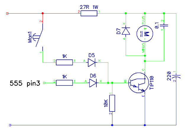

Try this:
TIP110 won't need a heatsink at 150mA, the 27R resistor charges up the 220uF cap to ~9v, which should be enough energy to get the motor running, then Vmotor drops to 5v (if motor runs too fast, recalculate 27R resistor).

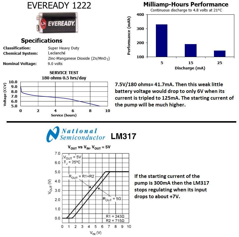

I found the datasheet of a 9V Chinese "super heavy duty" old style battery. A brand new one can barely provide 40mA and your pump draws much higher starting current.

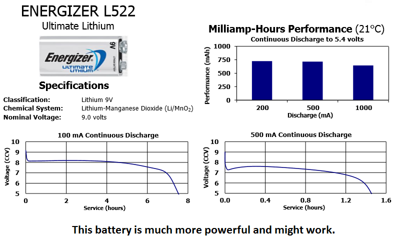

The LM317 needs a minimum input that is about 7V but the cheap little 9V battery voltage will be much lower. A modern alkaline battery or a much newer Lithium battery might work.

Try the 2N2222A before you buy anything else, a 555 should source plenty of current. However, refer to Audioguru's comment about the battery - here (UK) we have 9v batteries in the shape of "PP3" and a good quality one has plenty of power - I just tried one (an Energizer) on a 6v motor. Just out of interest, what are you pumping?

.... but not for long. PP3 capacity is only ~500mAh, so a pump current of 150mA would flatten the battery in ~ 3hrs or less.
But the important problem is that the battery voltage drops so fast that the LM317 regulator does not work.
