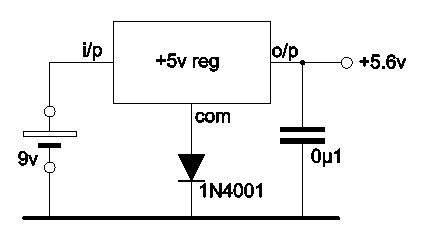

To get a higher output, do this:
0.4v is neither here nor there as far as the motor is concerned, and use a low dropout regulator. Remember it will need at least 1mA to work (e.g. 3K6 supplying an LED), and you will need one that can supply 500mA or 1A (so cheap might as well get a 1A).
I still agree with others though, that this might not prevent false triggering, hence my previous idea.

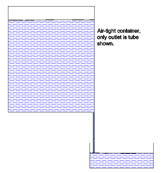

You didn't like my ancient Greek/Chinese solution (the big water tank)?
If you use another mag switch at the top, how will it turn the relay off?

1. I want the smallest tank possible that achieves the goal of a 1 to 2 day supply to the dipping bowl;

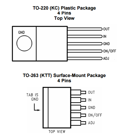

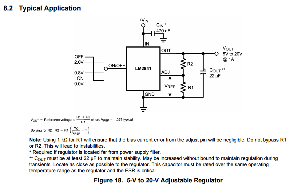

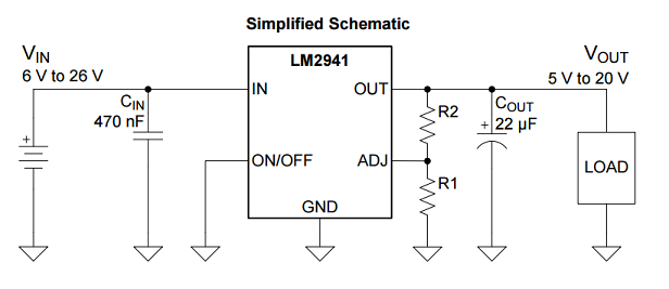

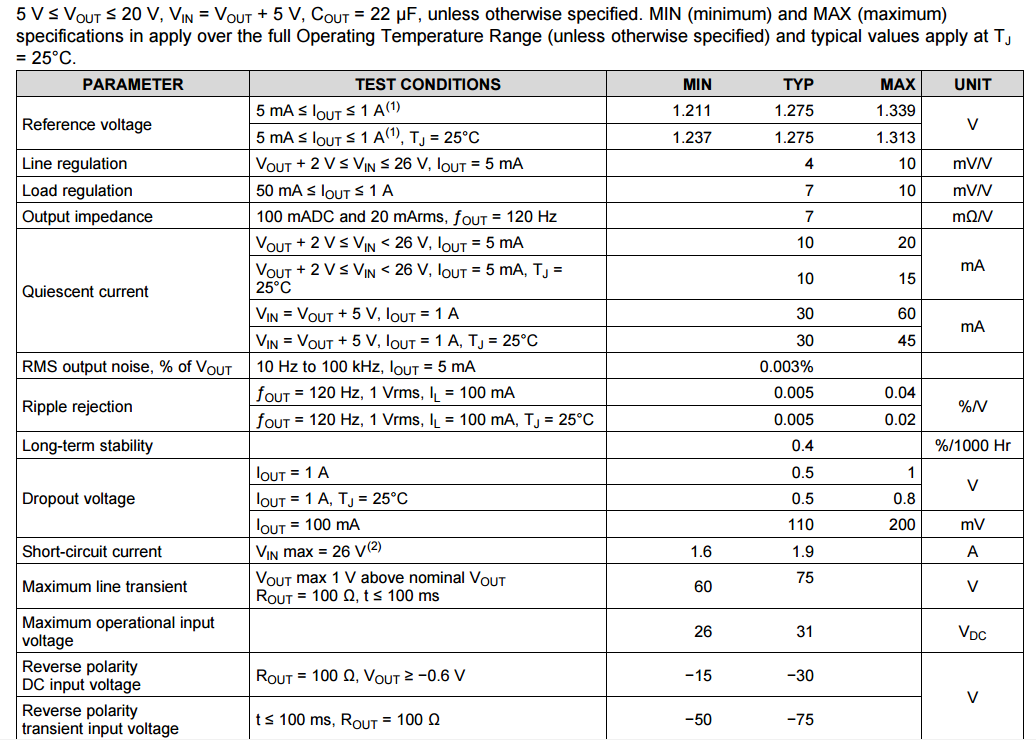

Just received the LDO regulator LM 2941. It's not clear to me what the on-off pin does, should it be turned on or off and how is that done?
Can't upload the data sheet because it is too large for the server.
I'm guessing that the on-off pin should be set to on by grounding. But I wonder why an on-off function is provided in the first place?
When the LM2941 is turned on then it has no voltage loss caused by an external transistor or Mosfet being used to turn on a load. The on-off input current is very low.

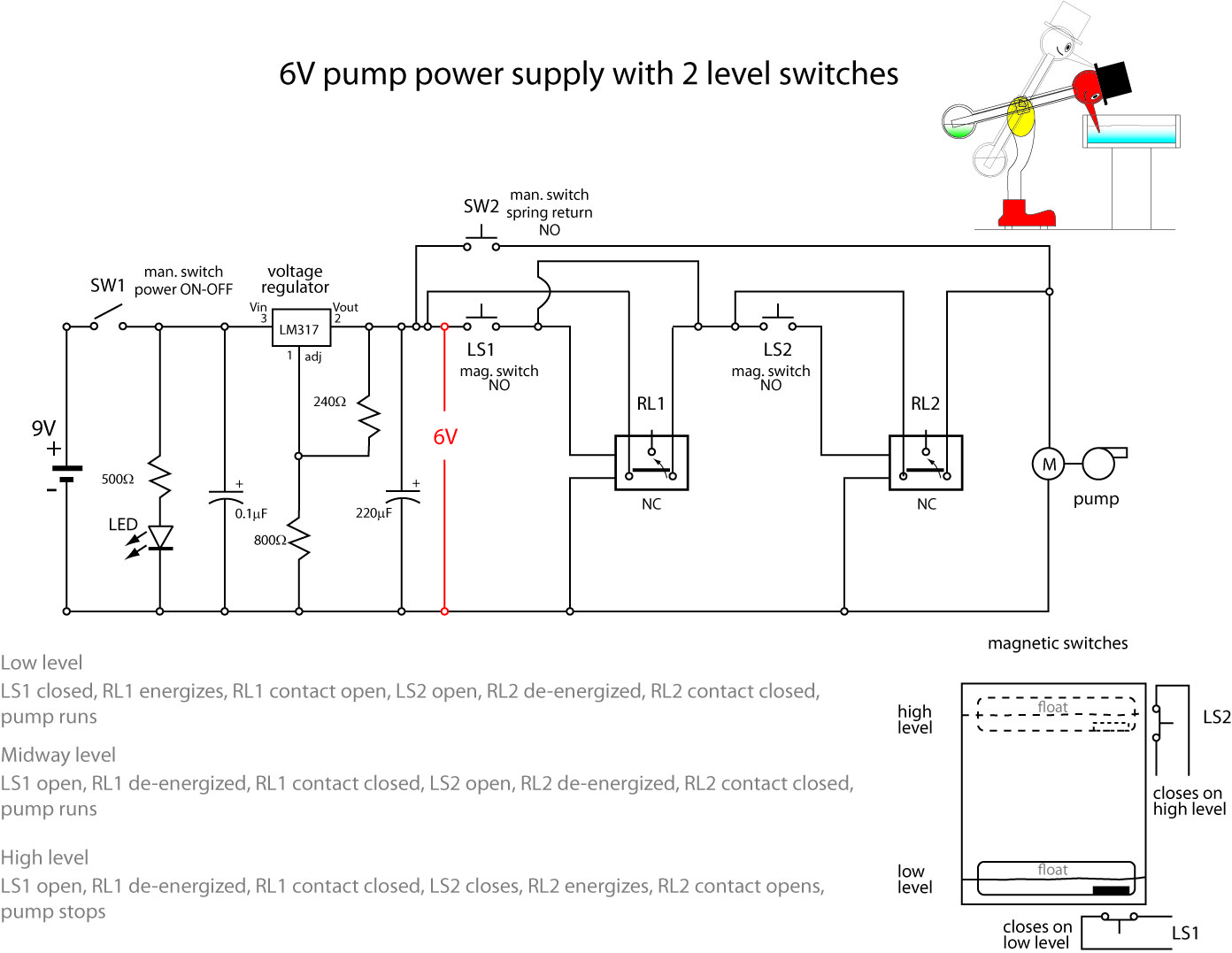

So I have tried the LDO regulator and it has not helped. I could fiddle with it and maybe get it to work but I have decided to go the other route of an additional level switch which I had been avoiding all this time. It makes for a circuit with much less parts which in the end will be more reliable. I have attached the schematic, it's rather tortuous and I'm not 100% sure that it will work, proof will be in the pudding.
It will sort of work. It will maintain the level at the high level.While it is at the high level RL2 will be energised consuming current an discharging the battery. As soon as le level drops so the LS2 is open RL2 will be de energised and the pump will run until LS2 closes. The level will never drop low enough for LS1 to operate. Also RL1 will behave like an old fashioned buzzer.
Les.
Les.
Yup, you're right, that's what I describe for the midway level operation, pump runs. That's OK when it's filling but not when it's draining. When the water reaches the high level I want the pump to start only when it reaches the low level.
Somehow there needs to be two modes of operation. In the fill mode the pump runs when LS1 is on or off and stops when LS2 is on. In the drainage mode the pump needs to be off regardless of the position of LS2 and start only when LS1 is ON.
