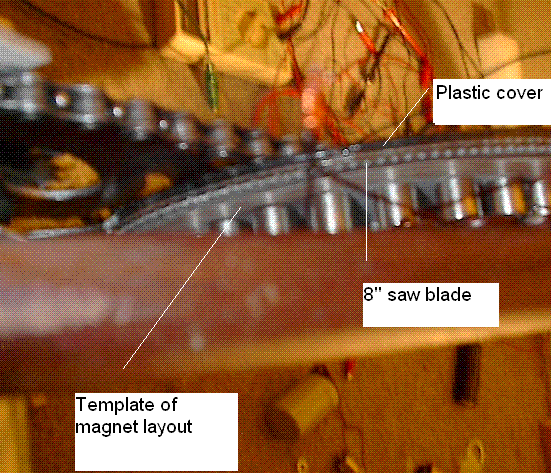

they are mounted on an 8 '' saw blade..
i realize it is hard to see from the pics, but they are mounted on steel.
the rotor, from the magnets outward , is composed of a sheet of paper with the magnet layout, necessary.! then the saw blade approx 1/8 '' thick, sorry Bryan not 3/8.. i am working on a shoe string here guys..then there is a plastic cover , which serves two purposes , it acts as a chain guide and prevents the chain from sticking to the magnets. :lol:
yes! the chain would stick to the other side of the rotor , right through the steel..

On your question of a magnetic circuit , any ferrus metal near the magnets ,causes cogging..
none of the axial wind generators on otherpopwer.com have any..but i did try it a while ago , i had strips of steel under the coils, there are probably pics of it in my earlier workings..

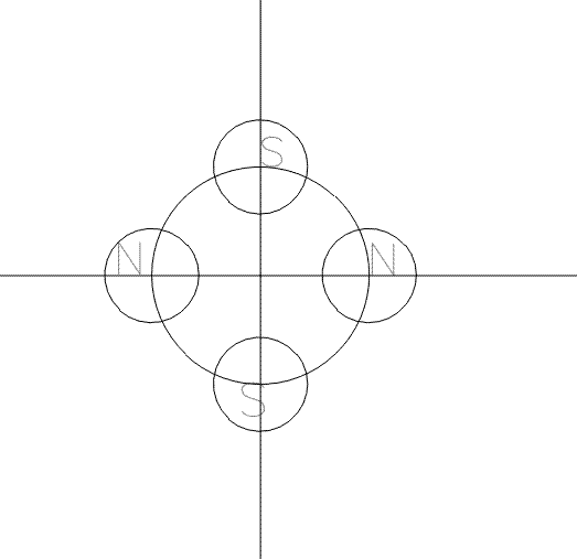

if you are interrested i will post some pics of a 3 coil 4 magnet generator seperatly so you could print them out and you'll see that as thr rotor turns each phase is 120 degrees apart..

i believe these are the same size ..
if you print the magnet one out on clear plastic transparency and put a pin through the center , youll see that as the rotor ( magnets) turns each phase goes through a maximum magnetic field.. i've done it..
note this is just an example , as the number of coils and magnets increases there is less and less wasted space between the coils..

eh bryan , i got a little design here for ya..
with those magnets of yours this little baby should kick ass..
i apologize for the look of pic 2, but the program wouldnt let me make an arc of 2''or more ..but pic three is a blown up view of one of the coils..
the outermost dia. is 12.266 inches..the center of the magnets pass through an 8.922 dia. circle..
the coils are drawn , starting with a 1'' line , make a 1'' dia. arc on the left , across from that make a 1.5'' dia. arc with the center on the other end of the one inch line..
increase the radius by .5'' on either end and viola..
so your coils would have a half inch of wire around the perimeter..

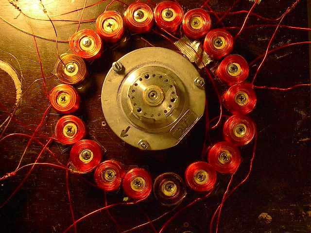

i'm happy to report that the new wire arrived today , so i wound up another coil ..
With the two coilsl of twenty gage i allready had , i hooked all three of them up to the genny and gave it a spin ( by itself , not on the cycle) , i got 16 V p-p just from the three coils , that means i can get 32 V p-p from one phase , which is 16V peak , which should give me at least 19 V , three phase rectified voltage ..
since available current was never a problem ,with the 17 gage wire, i think using the slightly thinner 20 gage should be perfect..
well i was right about the # 20 gage wire working better, because today was able to charge a 12V seald lead acid battery, with 14V !!..
and i still have one phase to make and install !!
granted charging 12 v is at the upper range of the speed i can generate by hand..but it still worked..
I worked fevorishly last night and finished the # 20 gage coils.. the results are outstanding..
Voc is the open circuit rectified three phase voltage.
Isc is the rectified current going right into my GB GDT-190A meter on the 10A scale
Voc is 22.5V at max cranking speed..
Isc is 5.34A @ approx 2.10 V

JimB said:
Willie,
You have a serious problem here, there is no magnetic circuit!
Have a look at (say) a simple permanent magnet motor. There will be two iron poles from the magnet. The poles are very close to the rotor, a very small air gap, and the rotor is its self made of iron.
Lots of magnetic material to make a magnetic circuit.
What is in your magnetic circuit? several inches of air and wood. Not good.
Ya know , you were right!!
To effectivly make use of the magnets i would need two rotors that would compleat the magnatic circuit , right !
The two rotors would have 24 magnets each, with oposite poles attracting each other, thats what you ment ??
the only reason i havnt done it yet , is it makes construction much more difficult because the coils would have to be suspended between the two rotors , not impossible ,with some fibergalss resin , just more difficult. :)
