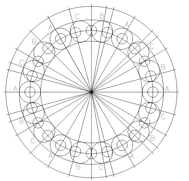

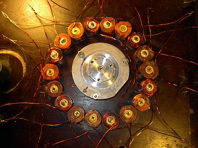

as pic 3 shows an 18 coil -24 magnet genny with six coils per phase ..
today i used six of my 9 coils to test out one phase ..
as it is i'm getting 0.5 ohms per phase! no voltage or current readings yet. as i have to adjust the air gap and afix the coils to the genny a little better..plus now i need nine more.. ug!..:lol:

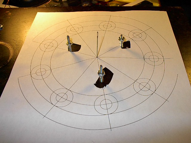

Pic 1 is the placement layout centered on the board , i've since changed the layout to 18 coils which was as easy as adding a coil between each coil shown.

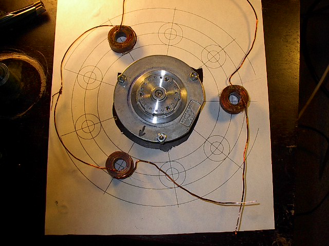

Pic 2 , is the hub from a 5 1/4 '' HD which has been my main bearing since i've been on this project.. :lol:

Whew !!
almost done !!
it still needs a little tweaking, like adjusting the air gaps .
i ran out of brass screws , and had to use stainless.
and i still have to solder some of the connections.
this is my first 18 coil 24 magnet three phase generator !
the last phase was the easiest to attach because there was only one spot left to put the coils :lol:

Big mess of wires. :lol:
You have to triple check here to make shure evrything is wired up right.
The easyest mistake to make is conecting the coil the worng way round becose bouth wires are identical.

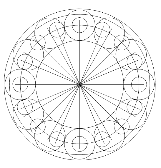

below is a new generator designed with 7/8'' dia x .5'' magnets, it should give , an open circuit , output of at least 32 V with 20 AWG wire , current estimates are unknown at this point .. :lol:
oh the coils are 1.75'' dia., twice the magnet dia..
