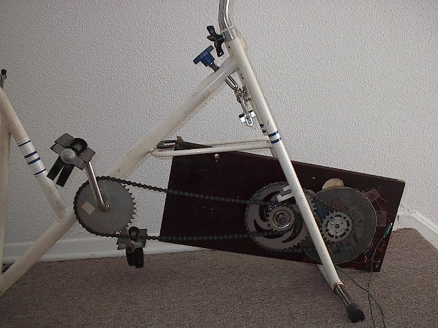

I can finally crack the 2A barrier with my DIY Generator..
I hooked it up to an excercise bicycle..lol with a four to one chain drive..!!
If i can find another 2:1 sprocket set , will that be 6:1 or 8:1 final drive ?? 8:1 i think..
Anyway i am now the proud owner of a genny-ciser or exer-gen.. :lol:
Preliminary results are VERY nice.!!
I did a test with a FWB rectifier setup and with no trouble at all i was able to max out my meters 2A scale .. i just thought about the 10 A scale , wow cant wait to try it..
I also tested an 1156 brake light bulb and it was very brite.. :lol:

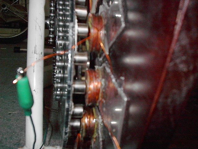

Pic 2 is a close up of the actual generator..

williB said:
I believe nigel was talking about the maximum sustainable human output power from a stationary cycle ...yes ?...
Yes.
the 2 A was not at 12V though as i was seeing what i could put into a resistance of .33 ohms ..
at 2 A i got a voltage of 1.36 V into a measured 0.4 ohms.
How did you measure the 0.4 ohm?.
V^2/R gives 4.62Watts
but V*I gives only 2.72 Watts
If you get different values (particularly as wildly different as that), then you've measured wrong somewhere. Certainly the most difficult to measure is the resistance, which is why I asked above. Assuming the voltage and current are measured correctly, then the resistance is 0.68 ohms.
Only 2.72W though is pretty poor?, it's less than you get from a standard bicycle dynamo!.
i dont own an AC Ammeter, but i would be interrested to see what is comming out before the diodes.
I wonder how accurate you existing meter is?, as you're not feeding it smooth DC, but essentially double frequency AC that only moves one way from zero - a normal meter isn't going to read that correctly.
there are currently 6 coils on the generator , two are wound with #17 gage wire , one is #19 gage wire , and the other three are #22 gage..
i have room on there for six more coils.
i have two more coils of the #17 gage wire allready made ,but not on the generater..

EDIT::eek:ne more thing there are 22 Neodium(sp) Magnets 1/2 " dia X 1/2" long
therefore i can only add 5 more coils for a total of 11.. hooked in series ..
