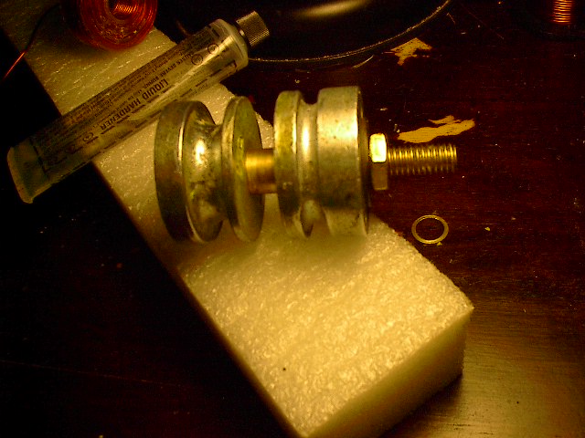

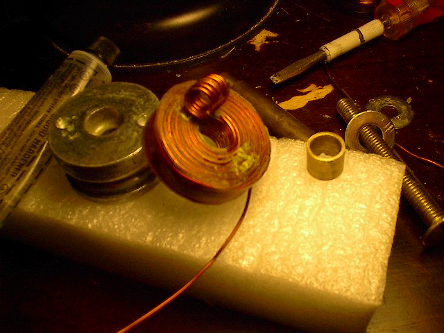

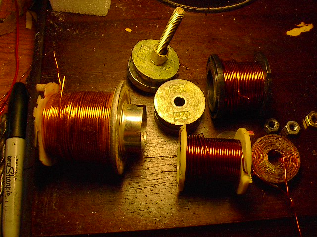

If anybody is wondering , where can i get some wire like that for free, these coils of wire came out of Relays..
i have , getting the wire out , down to a science , the guy i get these from tells me that he just throws them out , so he gave me a bunch..
He owns a generator/ alternator repair shop..
pic two is the fixture , without the wire , that brass sleve in the center worked beautifully..
pic three is a recently finished coil with the pigtail still woundup, and the sleve on the right..
Well i've finished eight of the thicker wire coils , YAY ..and i'll be testing it over the next few days.. :lol:

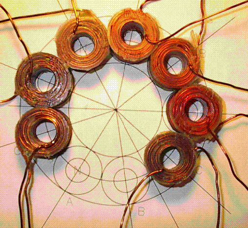

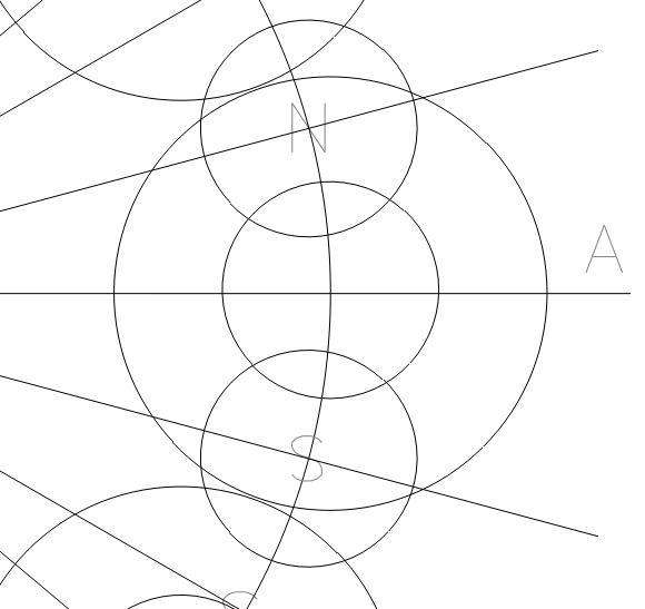

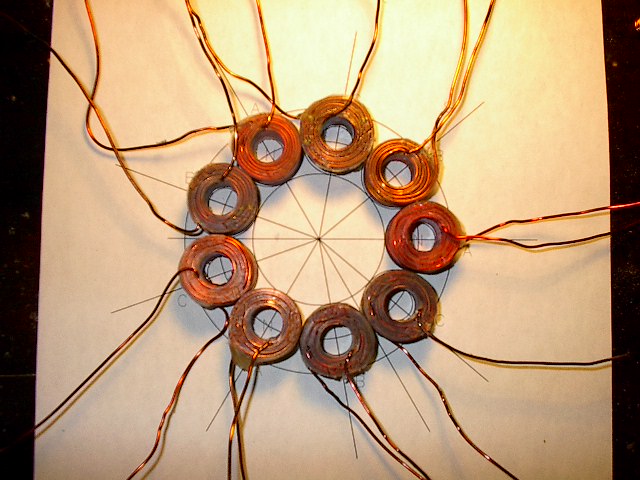

This is a 9 coil 12 magnet three phase generater.
Edit : Number of Coils to number of magnets Ratio must be 3/4 for three phase . in this case 9/12..
magnet dia. to coil dia. ratio = 1/2
the coil hole is 0.75"

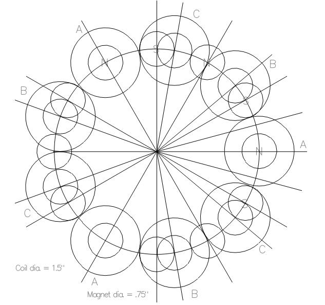

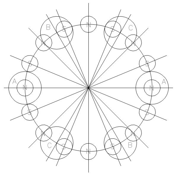

I redid the 9 coil 12 magnet generator up above..
the new design is very symetric..
the coils are 1.5' dia , the magnets are exactly half that size.
the 9 coils are positioned out 40 deg. apart 360/9..
the magnets are positioned at 30 deg. intervals evenly spaced ..
if you rotate the magnets 15 degrees ccw , the voltage for phase A would be maximum.

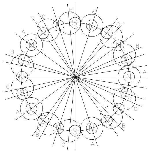

This is a 15 coil 20 magnet three phase generator , thats 5 coils per phase.
this diagram uses 1/2 " magnets ( the ones i have) and 1" coils , i've left out the hole in each coil, for clarity . phase A has the hole and the magnet in the same spot anyway..
I keep making small improvements to my 8 coil , single phase, exer-gen :lol:
today i put on a set of smaller dia. pedels and it enables me to to crank @ 341 RPM under load , and 389 RPM max no load speed.
I still am going to try the three phase generater , but it requires precise dia. coils as you can see , because they are right next to each other ..
Its hard to predict what a 9 coil three phase genny would produce, because thats only three coils per phase..and the coils would have to be 1" dia. instead of the ones i am usung now which are 1.5" dia. we'll see..

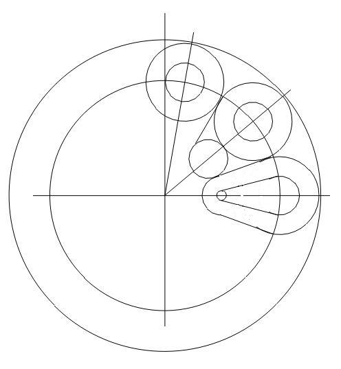

anyway i sort of designed your genny ( part of it ) ..
the outer large circle is 8" dia. the coils are 2" dia (at the wide end)
the coil smaller dia. is 1"
the center of each coil is 2'' long..
this gives .5" of wire on the side of each coil , and 1" of wire if they are right next to each other , as shown ..
is this what you are gonna do?
if not give me the specs and i'll draw it up for you..

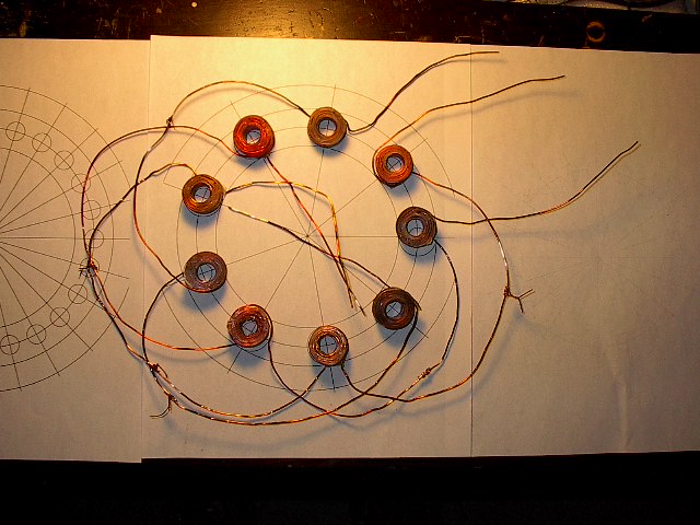

i made a couple of the one inch coils ,that i was talking abuot before..
They produce 2V each which doesnt sound like much untill you figure that there are five per phase which is ten Volts and the Line to line voltage is square root of three times ten equals 17V all calculated.. i think thats right ? and given the lack of wire used , it should be a very light and powerful generator , with incredably low internal resistance..

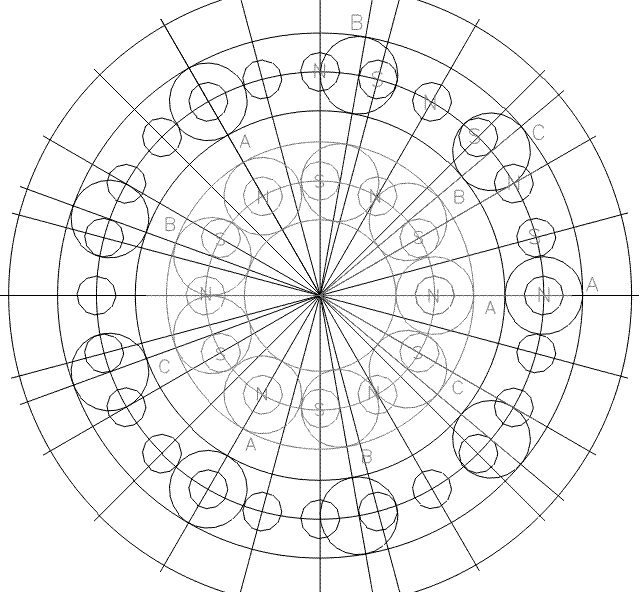

this is a 9 coil 12 magnet gen. superimposed on a 9 coil 24 magnet gen..
what i am trying to do here is have two generators on one rotoor
one thing i noticed is that for the same rotation the 9-24 will go through twice as many cycles ..
or put another way , for every 15 degree rotation the outer gen. compleats one half cycle , while the inner gen only goes through 0ne quarter cycle..
also a consequence of using twice the minium number of magnets is the phase changes from A-B-C to A-C-B not a big deal but thought i'd mention it..
so the outer circle is 8 '' dia. , (which is what i have to work with..) the coils are 1'' dia. & magnets are .5''.. the problem is my hub is larger than 1.948 '' which is the inner dia of the 9 coil 12 magnet setup ..

Ok got the last two done..
Ya know , this will just fit in the size of a 3 1/4 '' hard drive case ..we'll see.. :lol:
