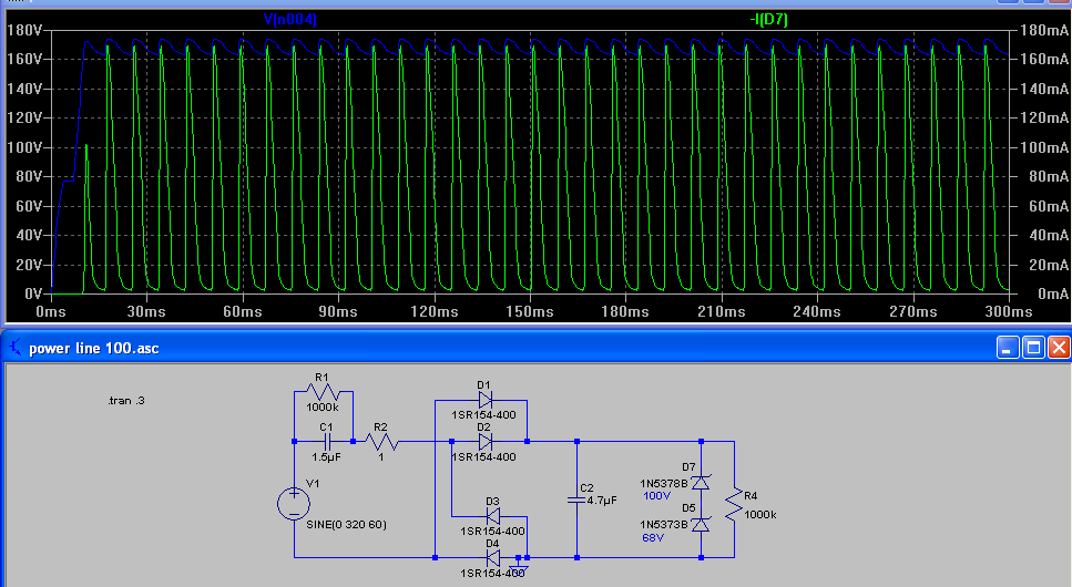

Looking at the circuit at 120Vac and with the measured 20V across the 1.5uF cap I can't see how much current flows in the LEDs.
At 220Vac I do get current.
I am using 100V+68V Zener diodes for the LEDs. Blue trace is the voltage across 4.7uF.
Green is LED current.
The 4.7uF is too small to do its job. If C=470uf current is 50mA dc.

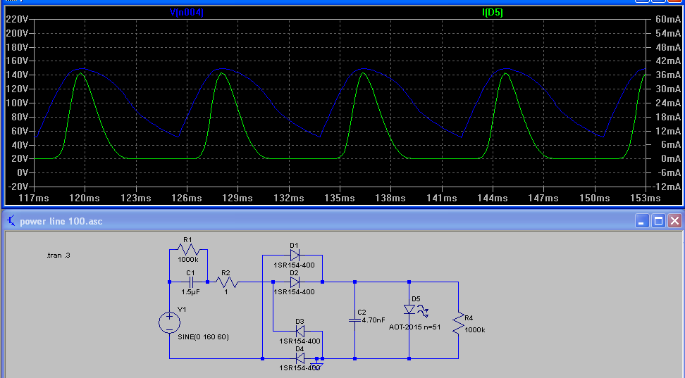

You can use 1 LED - I used an A---- something that had about the right voltage drop. Then right click on the part number and add N=51 after it. Then Spice will treat it like 51 in series. That way you see the effect of lower Vf with lower current.
Because there is very little voltage across the 1.5uF cap, changing it value will have no/little effect.

ronsimpson : Thank you for the effort on your post/simulation. I believe you meant the 1.5uF/250V is too small to do its job. The 4.7uF shows reasonable smoothing on your simulation. Is it ?

I think the HV capacitor should have 1/2 the line voltage across it. (not 20V)
Are we sure the LEDs are 2x25 not 1x51 (25 parallel 25)?
