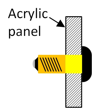

Way back when (the 70s) I bought an old aviation switch box at a military surplus store. It was a small treasure chest, including a Ledex (rotary relay) and other cool stuff. It had a painted acrylic panel with engraved labels, which were illuminated by very interesting bulbs.
These bulbs were an opaque thin disk on the surface of the panel (no light visible), with the clear part of the bulb located within the panel thickness, and a threaded base to screw into a socket. There's a picture below. The effect was to edge-light the painted acrylic panel, so the labels were visible. I've never seen bulbs like this otherwise.
Have you seen anything similar today, possibly in an LED format? Something like this would be extremely handy to edge-light a laser-engraved piece of acrylic.

Some industrial MBC style "bulb replacement" LEDs have a LED that has a concave front. That reflects a lot of the the light to the sides.
From a quick search, similar individual LEDs are readily available online:
That style, with a drop of aluminium/silver paint in the front to enhance the radial reflection, could work well??
The cool thing about the old (odd?) style bulbs is that they have a finished part in front of the panel that emits no light, and with the threaded socket on the back of the panel, it's clamped to the panel.
The application was pretty specialized when it was built, possibly during WWII or shortly thereafter, but it seems like it would be very useful today. The small box I got at the surplus store was a bomb release control I believe. It had a 7 position Ledex switch which I suppose automatically cycle from one bomb to the next when the release button was pressed.

The bulbs in question had a fixed black (opaque) cap on the end as shown on the picture (everything pictured except the hashed acrylic panel is the bulb – one piece that can't be disassembled). It inserted from the front of the panel, with light emitted from the sides only.
The bulbs may have been painted by the instrument maker. Many of the bulbs I had were painted blue or had a transparent blue polymer cap. I just used transparent blue lacquer if the cap was not reusable.
The bulbs were clear.
The key point is the opaque end of the bulb that held it captive to the panel.

Doubtful. These are small bulbs - say ¼" bulb diameter.
What's the point of this post?
A simple LED strip is very directional so it doesn't need o be encapsulated 360° by the acrylic like an incandescent, neon or fluorescent bulb to maximize the light extraction for total internal reflection in the clear PMMA.
Simply mount the clear panel tight to the LED strip and wrap the rest of the panel with reflective white tape to "recycle" the light flowing all the way across the panel. LED edge-lit TVs and monitors have used this technique for years.
In summary, I highly disagree with your hypothesis that an obsolete illumination technique would be...
...extremely handy to edge-light a laser-engraved piece of acrylic
A simple LED strip on the outer edge works just fine - and no wires in the field-of-view behind the clear panel.

I'm told by one of the moderators that I have a heckler in this thread. Fortunately, I don't see his comments as he was blocked long ago. I understand he thinks this whole question is rubbish and pointless – that edge lighting is always the right answer. Well, it's a pity he didn't understand my post – the original purpose of these lamps was to illuminate a painted translucent white acrylic panel where labels had been etched through the painted layer. In many cases, there's not room to edge-light a panel, and as the panel is opaque, there's not problem with wires running from the middle of the panel. In fact, if sockets for the bulbs are pcb-mounted, they might serve the dual purpose of illumination and securing the panel.
