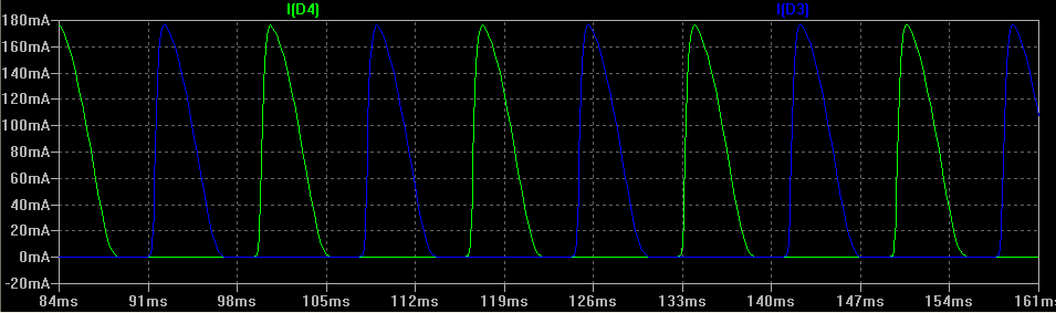

Is there a design that does not have this diode loss? Out of 160V of LEDs the bridge has about 1.4V of loss. (Less than 1%)
Using 220Vac; here is the current in two of the diodes in the bridge.
This bulb was designed for 220Vac not 120Vac. That is clear.
Hi ron,
I don't think the rec diode Vf is an issue; it is only a couple of volts (2 x Vf at high current). The problem is the 153 volts nominal accumilated Vf of a string of 51 LEDs in series. 120V RMS mains has a Vpeak of 170V so there is only 17V overhead. The VF on LEDS is not accurate and it would only take a string with high bulk resistance LEDs to cause a no go situation. What I am suggesting is to double the input voltage to 340V ( in theory) to set up similar conditions as for a 230V 50Hz input. The 20% increase in frequency going from UK 50Hz to US 60Hz effectively give you 20% more power transfer which is one favourable thing..

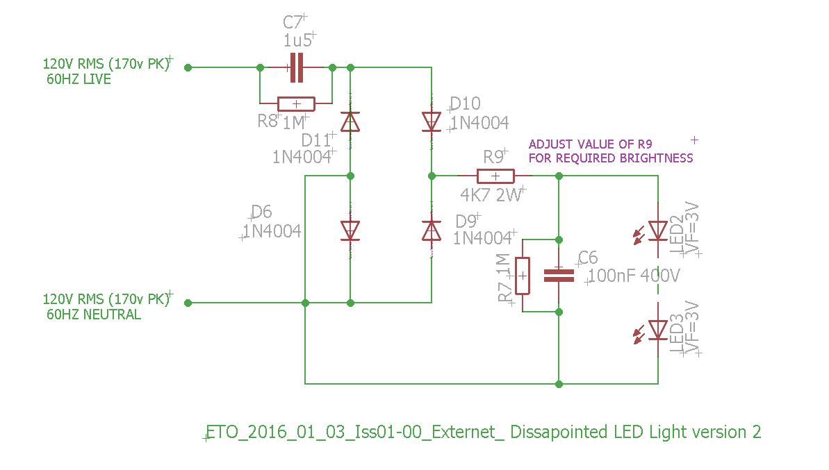

After reading this thread, I got interested in the topic of LED lighting and tried to identify the SM LEDs used in the 30W lamp.
I could not find the 505SM type on the Cree site but taking another approach Cree seem to have 2 broad ranges of white LED SM chips:
(1) 20mA at a nominal VF of 3V3 (x51= 168.3V)
(2) 30mA at a nominal VF of 3V6. (x51= 183.6V)
The peak voltage of a 120V sine wave = (1.414 * 120V) = 169.8V. If you subtract a nominal 2% to cover mains supply variations and local voltage drops you get a worst case effective mains peak voltage of (0.98 * 169.8V) = 166.4V. Then if you subtract a further 2V for the two diodes in the bridge that are in series with the supply at the + and - sine wave peaks, you get 166.4- (2*1V) = 164.4V.
There is not much point in quantifying further, especially in view of the ratio of the values of the two capacitors. Quite simply, as has already been stated, the circuit has no chance of driving the 51 series LEDs at full brightness with a 120V mains supply- yet the advert clearly states that the circuit will operate from 85V to 265V. :oops:
This circuit should do the job and requires only an additional 400V 100nF cap. Any value around 100nF would do.
ERRATA
(1) 4K7, 2W resistor should read 4K7, 4W
(2) VF=3V should read VF=3.45V in two instances
(3) C6 schematic symbol should be for an electrolytic capacitor with the positive terminal uppermost
(4) LED2 & LED3 should read LED2-1 & LED2-51 respectively
NOTES
(1) The input capacitor and two diodes in the bridge rectifier are a voltage doubler, generating 170V across capacitor C7 on the negative excursion of the mains sine wave .
(2) Some of the energy stored in C7 is then transferred to the LED string on the positive excursion of the mains input sine wave which adds the positive swing of the mains sinewave to the 170V stored by C7. Thus the LED string is presnted with 170V + 170V = 340V (not quite true, but good enough for illulstration)
(3) The current through the LED string is pulsed, but the average current (RMS) through the LED string is set to 20mA by the series resistor, R9.
(4) D6 & D9 have no function and are only shown because they are part of the bridge rectifier.
(5) First build the circuit with just the input capacitor C7 and bridge. Ensure there is 170V across C7 (there will be no ripple voltage)

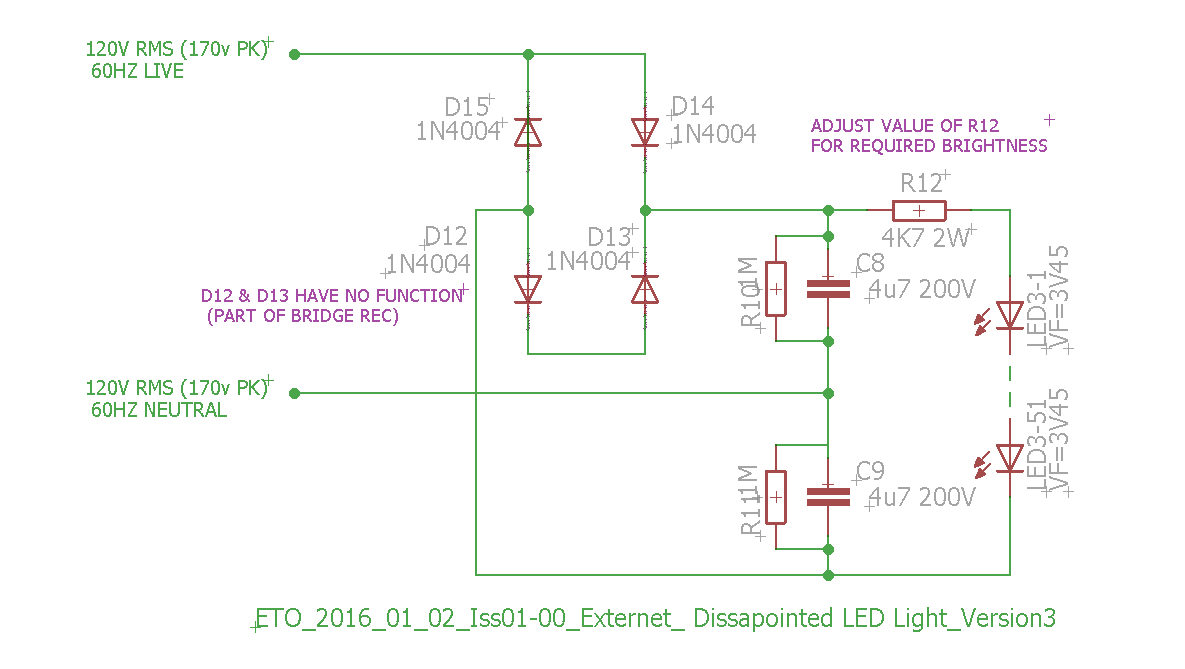

This is a recommended circuit:
ERRATA
(1) R12 should read 4K7, 4W
(2) C8 & C9 schematic symbol should be for and electrolytic capacitor with the positive terminal upward in both instances.
NOTES
(1) The bridge rec and 2 capacitors are plus & minus half wave rectifiers.
(2) The effective PSU as seen by the LED string is 340V across 4.7uF/2 = 2.35uF
(2) First build and test the two half wave recs but do not connect the LED string. Ensure the half wave rectifiers produce 170V and -170V respectively (there will be no ripple)
(3) With the LED string taking an average of 20mA there will be around 340V- 176Vsting= 164V ripple across the two caps. Just in case you measure, this large ripple voltage is correct and reduces the dissipation in the series R.
(4) The current flowing through the LED string is pulsed, but the RMS value is set by the series resistor to 20mA.

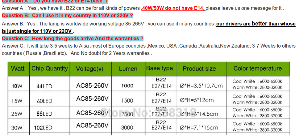

I got interested in the topic if LED lighting and tried to identify the SM LEDs used in the 30W lamp....
... yet the advert clearly states that the circuit will operate from 85V to 265V. :oops:
Same here. Unable to find specs to put it to work properly.
And, do not miss the boldly underlined claim by the vendor "Question B" about the 'driver' circuit :
:) You have to be on your toes.

Just that In My Opinion, A Full Wave Bridge circuit would be More Efficient.
A full wave bridge would be much better, only problem is it would not turn the LED string on, as previously outlined in the posts on this thread.
The dual half wave bridge circuit charges the effective reservour capacitor every half cycle, just like the the bridge, but it does have the advantage of 1 less diode Vf (1V or more at the high pulse of current into the caps at the plus and neg peaks of the input 120V sine wave). The only difference is that 2 less diodes are needed but an extra capacitor is needed. Also the effective capacitance seen by the LED string is half the value of a single cap (2 caps in series). This doubles the ripple voltage, but the high ripple is an advantage in this application because it means roughly half the dissipation in R7 (4K7): 165V at 20ma with a loss of 1.65W rather than 3.3W (all this is very rough- but in the right order)
And 4k7 Seems like a LOT of Resistance, base on the LED Voltage Compared to the Rectified Line Voltage.
The 4K7 resistor may be to high- I got tired of working it all out so played safe, besides I had a few other things going on at the same time. The effective rectified voltage with both of my circuits is 340V. The diode string forward drop is 176V so that leaves 340V- 176V= 164 volts for the 4K7 resistor to loose- seems about right to me!

Hi Externet,
I have it in my mind that the circuit of post #49 may be capable of driving two LED strings, with their assosciated balast, resistors in parrallel, but that would be a bit further down the line.
OK, Since I Didn't see a Neutral Line, I Assumed you were running at 120, Not 240.
At 240, I would tend to go with the original circuit, Rather than that POWER Resistor and the Heat coming from it
The rectified voltage is 120V * 1.414 = 170V. thus the total effective voltage seen by the LED string is 340V. Without any ripple the 4K7 would dissipate around 3.28W, with the ripple voltage half of that. Who cares about 1.64W or so, but in principle you are right.
The second circuit is better all around- much easier to characterise too. It could also be configured for 230 volts mains supply quite simply.

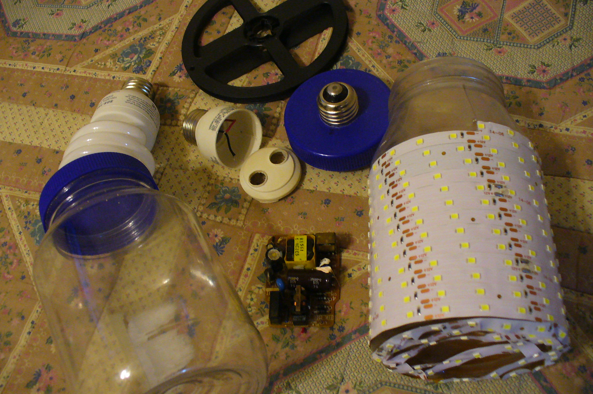

Needed some fun...
A jar holed its cap, a spent CFL bulb base, a 24W power supply inside and a 5 metres reel of 12V LED self adhesive strip wound on. Now I have light. So bright its ugliness is unviewable.
