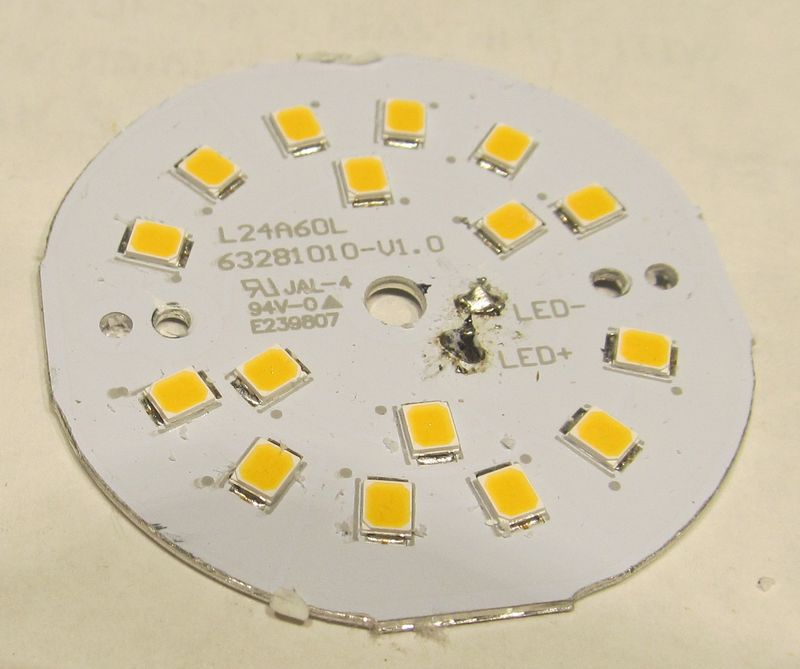

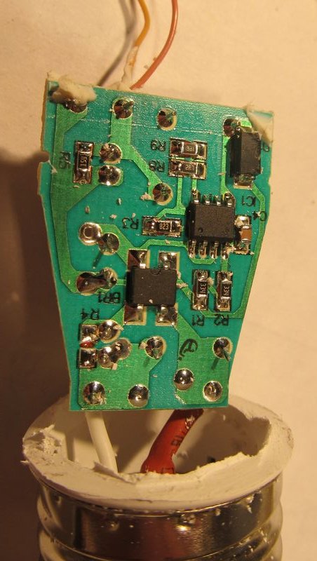

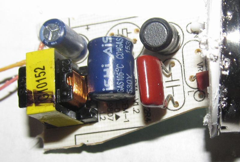

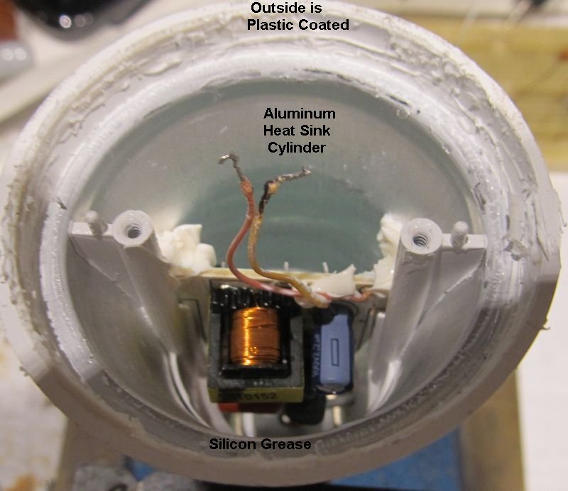

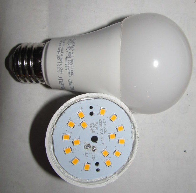

I Just bought these 60 watt, 110VAC bulbs. (10 Watt LED)
$3.00 in Canada at the Dollar Store. (or about $2.00 USD.)
(Same one is $3.69 or so, at Wallmart)
Quite a NICE Bulb, Especially for the Price.
Not as Yellow in color as a Incandescent Bulb.
Cutting the Top Bulb Off, this bulb puts out a VERY BRIGHT Light, Great for the Workbench.

These are Rated at 10 Watts and draw 185 mA., Rated at 3000K and 800 Lumens.
Non-Dimmable, but that is not something I need anyway.
The actual LED Display is rated at 94 Volts.
The Driving Chip on the PCB is a BP2833A, and checking out the Data Sheet for it, It looks GOOD.
Yes I would like 6000K, But I am NOT prepared to pay the Price for those.
