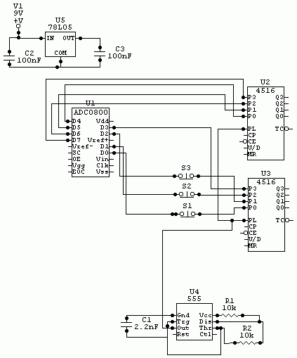

I would like to make one of these effects. They allow you to lower bit rates and alter sampling frequencies of an incoming signal for "lo-fi" type effects. My plan is to use an 8-bit ADC chip, giving a maximum of 8-bit resolution. To alter the bit rate down, I intend to be able to switch out the LSB's with 4066 CMOS switches, I think this would achieve the right effect?
To alter the sampling frequency I plan to have a set of latches on the digital outputs (the 4516 chip using the parellel load feature) which are latched by a variable frequency oscillator. By lowering the oscillator frequency, the number of samples passed per second can be reduced?
The only ADC chip I can get easily is the ADC0804LCN. It seems to be designed to be used with microprocessors, which I don't intend. Is it suitable? Also, the conversion time is a little long at under 100uS, I hope it is under it by a bit, but it shouldn't matter too much.
Looking at the datasheet, page 11's free running connection looks suitable? It generally looks a bit of a hassle to hook up (seperate grounds for analogue and digital?), is there much chance of getting one working (and a breadboard test is required too).
I don't do much audio stuff, so it took a while to search for the context. The bit-rate thing should be fine, it's just that 8 bits isn't exactly a lot of headroom to start with and lowering it from there is just going to make it sound even noisier. - Is there any way of simulating this stuff on the computer? I'd assume that there's some sample rate converter that will convert normal quality sound into something that's 8bit/10KHz. As far as I remember though, 8 bit sound is typically put through a compander so that the quieter sounds don't get lost - as it is, I'd guess it's going to sound worse than telephone quality (without the effects)...
The 4516 would let you divide the frequency by 1..15, so it would work if you can feed in a ~10KHz signal.
That mode of the ADC0804 should work, just keep an eye out for the note about the WR pin needing an initial pulse when the ADC is starting up. Alternatively, feed the carry-out of the 4516 into the WR pin and use that to start the conversion.

The use of the 4516 isn't quite standard. What i'm doing is using thier parellel load feature, they are essentially latches (I may use latches instead, but am familiar with the 4516). By applying pulses to the PL input, the numbers at the input are send out and held until the next pulse, upon which the current number is once again sent to the output and held. By altering the oscillator speed of the pulse source, it is effectively possible to lower the sampling rate? The half drawn schematic may make it clearer (there should be a hpf and schmitt to shorten the 555 output pulses and assume the 555 freq is variable).

Ok, heres a schematic; I finally decided to do it :)
- The input is capacitively coupled, this will pass the full signal with a single supply? It seems to in guitar FX pedals, or does the + input of the inverting amp need to go to 1/2 of V+? Gain can be adjusted with the feedback pot to suit different inputs.
- The sampling rate of the ADC is controlled by the 555 oscillator. It produces short negative pulses required by going through a high pass filter and inverting schmitt trigger (40106 fast enough?). I will find the values for the filter with the scope.
- I want the ADC to run at 750Khz, so need suitable R and C values to do this.
- At the DAC, bits can be discrarded by switching on 4066 bilateral switches (or ordinary MOSFETS?) which ground the 3 LSB's when activated. The 10k resistors stop this presenting a short at the output of the ADC. The switches are activated from a set of comparators controlled by a pot. (oops, the side with all the switches connected should go to 0v)
- A low-pass filter and high pass filter (should be around 6K and 30Hz respectively) are used at the output to remove unwanted harmonics/DC.
As noted, the op-amps are CMOS TLC27L4 which can run from only 5v single supply. I hope these are suitable? Comparators are LM339. The 5.8 supply is higher than 5v to allow the ADC to run a little faster; it will be a fully regulated supply. I haven't shown the parallel digital connection between the ADC and DAC for neatness. Hand drawn since my software doesn't have half the parts and I find it slow to use tbh.

The opamps need to be tied to some virtual ground at VCC/2. AC coupling should be fine. I'll let you dig through the ADC data sheet :). The TLC27L4 might not be the best choice - the GBW is pretty low, and it seems to be more meant for instrumentation applications - it seems to be the low power variant of the more common TLC274. If you dig around TI's website you can see all the recent variants of it. In any case, it does use a standard pinout, so later on you can just swap the chip out if it becomes a problem.
Incidentally, about the 4066 switches - the four things you can do with the bits are short the DAC bits to VCC, GND, VCC/2, or just open circuit them. This corresponds to rounding the numbers up, down, towards '0', and truncation (?dunno about the last one). There shouldn't be any difference between the first two, and the last one, but there is a minor difference if you short the DAC lines to VCC/2. I don't know which one you'd like to do though.

How I currently have the 4066's arranged is "shorting" to ground, so the DAC see's 0v on any of the LSBs when activated. I thought it would be bad to directly short, hence the 10k protection? I see what you mean about using 1/2vcc, that may be best, or at least different. Probably will try on breadboard to see.
A couple of other things, is that input to the ADC wired corrently? I couldn't figure it out :eek: . Also, is that 40106 schmitt fast enough to produce 100ns pulses? If not, what might be a suitable gate (don't really need 6 either, lol)

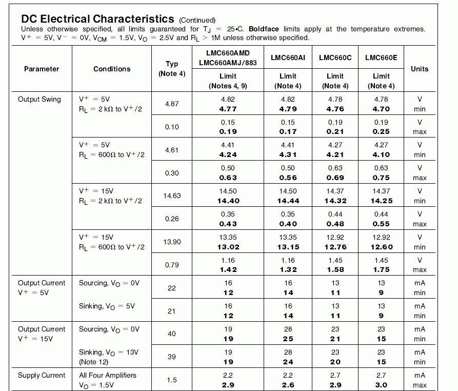

EDIT: Perhaps the LMC660CN is more suitable? Didn't realise that was a quad. Has a good output swing and low distortion at least.
A standard voltage regulator is a bad idea since they usually can't sink current. The standard approach is to use a free opamp to buffer the voltage coming out of a resistive divider. If you have can burn some power (by reducing the resistor values of the divider to much less(say an order of magnitude or two) than any loads connected), and can put enough capacitance on the line, it would be good enough. The ADC0804 has a Vref impedance of ~1K, so this is probably the limiting factor.
Since you seem to be using all the opamps, one substution would be to just use another quad opamp instead of the comparators, and use the one remaining opamp as the mid-rail buffer.

The LMC660 should work fine (the TLC274L4 wouldn't have any problems either). In any case, both these opamps won't work with the positive rail - most of the newer opamps - (i.e. ones that have been designed in the last 5-10 years) do rail-to-rail input and output. These two particlar ones only go up 2V of the upper rail - the largest signal that you'll want to feed into these opamps is ~3V considering the 5V rail voltage. It might make sense to
1) set the virtual ground at 1.5V
2) set the ADC0802's Vref/2 to the same voltage
3) or just supply the opamps with some higher voltage and leave everything at VCC/2
Signal is connected to V+ input, ground connected to V-, seems okay.
The inverter probably isn't fast enough to do 100ns pulses, but it probably isn't needed in the first place. The main reason for making the negative pulse as short as possible is to get higher bit rates... bleh, resuscitating my 555 skillz... Is there any reason for having the adjustable resistor on the 555 on the discharge path? To generate a very short negative pulse, I'd try to put a small fixed value for "Rb", and use the variable resistor for "Ra"

I'm concerned about them not being rail-to-rail? I looked at the dataheet and gathered it will go within 0.24v of the positive rail. I've attached what i'm looking at in case i'm missing something. Perhaps the input limits it, not the output?

The issue is that the ADC requires a relatively low impedance (~1K) on it's Vref input - which happens to be VCC/2 = the virtual ground rail. Other than that, the only other place is one of the nodes from the opamps, and that one is connected in series with a 22K resistor...
The input of the opamp is the problem. Pushing any voltage above the recommended input maximum does strange things - gain goes nutty, and occasionally negative.

I'll use the 1.5v "ground", and reference vref2 of the ADC to 1.5v also (though with a 5.8v supply, perhaps that should be a 1.9v ref?). This way the ADC gives a full digital output from 0-256 with a voltage at the input varying from 0-3v? Leaves a small headroom, but should be ok with input gain control.
I'll use the LMC660. I'll be able to free one up for the 1.5v (1.9?) reference by using two passive filters in a row instead, followed by a buffer or possibly adjustable output amplifier.
