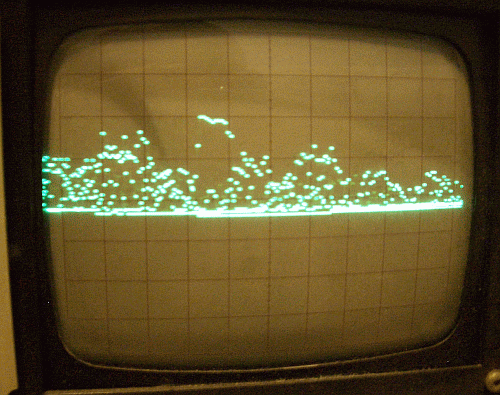

EDIT Again :) - I fixed the vref2 to 1/2 supply (the currently noisy line) and analogue ground to actual 0v. I'm getting some very promising patterns out of the ADC by just connecting the R2 ladder directly to my scope. Thing is, they dissapear when I connect them to the op-amp summing amp instead :( . At the output of that I get a lot of noise and a faint signal (as per the mp3)
Ok, well it seems to working as expected. I have the /WR fed by a 555 with HPF and schmitt for the short pulses. I wanted to use the LM331, but it isn't doing what I expected. I assumed it would be a supply voltage level square wave, but i'm getting like a 100mv fuzzy wave whose amplitude changes over the range too :/ . Not very good, I don't think its right at all since it says "logic output".
