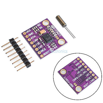

I doubt that would work well, or at all.
Your best option is one of the 9 or 10 degrees of freedom accelerometer boards, which are readily available on ebay at low prices.
eg.
Those include a three axis compass, plus three axis accelerometer and gyro functions.
