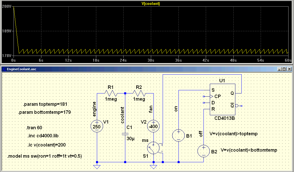

If I find the duty cycle of the fan is based on too short a time i.e. the fan turns on-off-on in much less than a minute with no electronic delay/hysterisis, then I'll have to admit you are right.
if we allow a small temperature deviation between turn on and turn off (build in some electrical hysteresis) then we see a much longer turn on, turn off period. How much longer exactly would be the subject of an experiment
If it's any help, here's a simulation. You can play with the top and bottom temperature values to see how they affect the on/off interval. Thermal inertia is represented by R1/R2/C1 time constants.

One can always add time to the hysteresis thing. A pressure switch that I have offers 2.5, 5, 100 and 500 mS. However, in this case, I doubt that's needed.

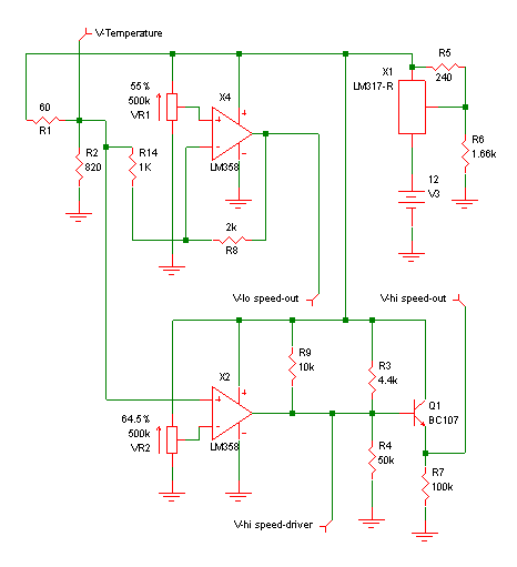

I think I get it now It's ok to keep an Op-Amp or comparator full on or full off. How about ... is the converse true ? Is it kosher to keep an OpAmp in the linear range at extremely low frequency - less than 0.1 hz ? Basically steady-state with slowly varying dc voltages at the input and output.
Reason I'm asking is that I want the output of X4 (V-lo speed-out) in the following schematic, to provide a variable control to drive a PWM circuit :
Yup, no problem when in that circuit.
KISS, it was a trick question.

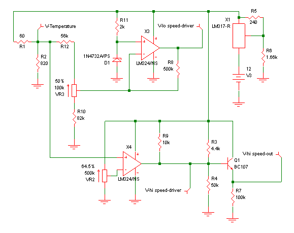

I now have control over what temperature the lo-speed will function and what temperature the hi-speed will switch on the motor at 100% RPM. Between the two, I believe there will be a pseudo/partial electronic hysterisis possible (just in case you guys are more correct than I am in assuming it's necessity) with adjustment capability.
X1 will be replaced with a fixed 10 Volt regulator. R2 is the temperature sending unit. VR3 controls lo-speed operation. VR2 controls hi-speed turn-on temperature.
Here is where I'm at now, before adding the PWM circuit :

Neither opamp in your circuit has any hysteresis. I think that could result in instability/oscillation in practice.
The gain of X3 is very low, by virtue of the 500k feedback. Is that intentional?
What are R3/R4/R9 for?
Why is R3, R4, R8, and R9 in the circuit? R3 and R4 dont do anything for example.
Why is the 100k pot connected differently than the 500k pot?
Why use a 500k pot? Resistors in this application should really be kept at 100k or below.
Trying to get an idea what you are thinking here.

I made R8 500k deliberately to result in low gain, trying to use this portion of the 324 as a voltage invertor, not as an opamp comparator circuit.

Trying to answer both yours and Alec_t's questions in one reply. Per your suggestion (voice of experience, I assume) I changed the 500k pot to 100k and the simulation graph looks the same. I connected the pot to X3 differently because X3 is being used as a voltage inverter instead of a comparator. It will be delivering a varying voltage (I think/hope) to the PWM driver. On lo-speed I want the fan to vary it's speed according to temperature, albeit within a very narrow temperature range. I made the pot 500k in keeping with my goal of reducing current throughout the circuit to a minimum. I have yet to do any math to see what the actual power dissipation will be through each component. I've been just merrily swapping in and out components and adjusting values to get the plotted curves I'm looking for. I hope this sheds more light on how little I know about what I am doing with electronic circuit design. Kinda groping along by feel.
As far as the resistors R3, R4 and R9 are concerned ... 9 was in the opamp comparator circuit I had. 3 and 4 were both in the transistor switch curcuit I had. When I plugged both curcuits together and into the rest of it, these resistors remains as they were. I guees I didn't see the forest for the trees, until you both pointed it out. I can easily see now that I can combine a couple of the resistors, or more but i think they need to be there in some form. I'll spend some more time doing that later. For now, I tried removing R8 just this minute and it reults in X3 putting out a flat voltage just under 4.5V. Apparently it has to be there.

R8 is not only not needed it could make the LM324 act as a linear device, which you dont want here. Therefore, you need to eliminate R8 and get that part of the circuit working without that resistor.
The LM324 should be perfectly capable of putting out the required voltage without that resistor. If it doesnt work without that resistor, then something else is wrong.
Same goes for R3 and R4. Remove them and get the circuit working without them. If you cant get it working without them, then something else more serious is wrong.
Im not sure how these three resistors got into the circuit either, what made you put them there, but they should be removed.
It was also pointed out that the two comparators probably need some hysteresis. This comes from putting one resistor in series with the non inverting terminal of the op amp, then another much larger resistor from the output to the non inverting terminal. When the output goes high for example it is because the non inverting terminal went higher than the inverting terminal, so the small feedback from the output back to the non inverting terminal raises the non inverting terminal voltage a little bit more so that the comparator can not immediately turn back off as the voltage dwells near the crossover point. The positive feedback eliminates the dwell and forces it to stay in one state rather than flip back and forth.
The values would be rather high for the feedback resistor and rather low for the series resistor. For example, 1k for the series resistor and 100k for the feedback. If that turn out to not be enough, then 2k for the series resistor. If that's still not enough, then 5k, then 10k, etc.

Another point is to put a capacitor across the sensor, at the input to the PC board for the controller.
One of the problematic things that comes up in automobile circuits is trying to eliminate noise that comes from various areas. One problem area is the ignition. The coil, drive circuit, and ignition wires cause lots of radiated noise. Dealing with that is not always easy. Troubleshooting may require a scope.
